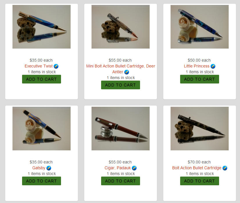

Based on a previous post i had placed this code:
.hikashop_products_listing .hikashop_subcontainer {
min-height: 320px;

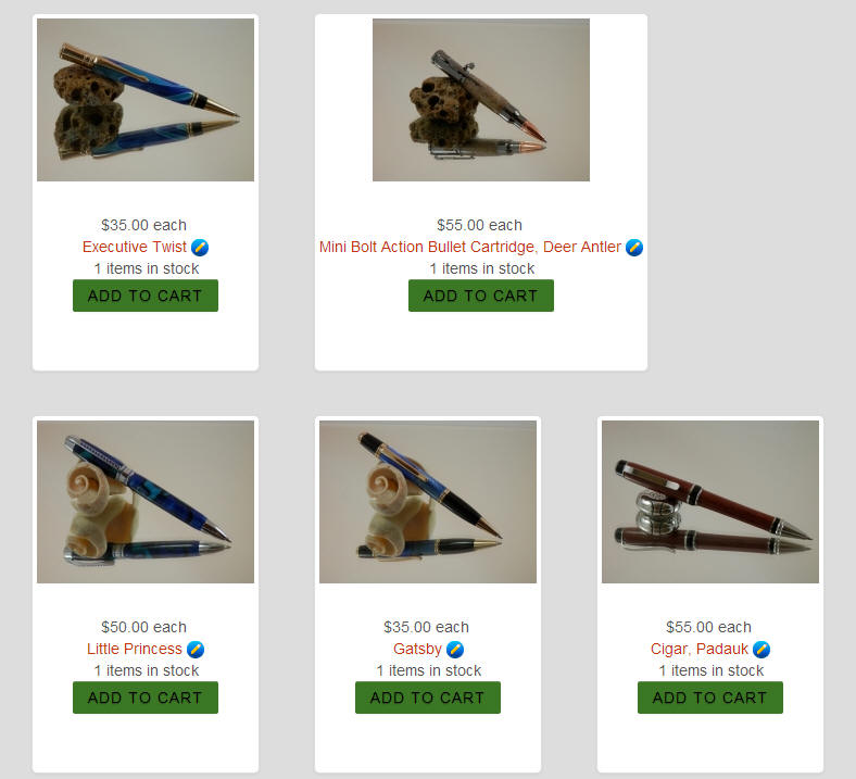

to make sure my product box heights were all the same size which worked fine as you can see by my first image. However, I had to change the back end general display to use bootstrap design in order to accommodate the way the products show up on tablets - portrait view (they were not wrapping correctly) now it appears my product names are not wrapping and when viewing on a standard monitor (see image 2) they are not sizing properly.
  • Posts: 26384
  • Thank you received: 4077
12 years 10 months ago #130633
The problem is that the title of the product does not allow to be displayed on several lines.
So it uses a larger size and increase the width of his container. So the result is not something expected.
I think you have a CSS rule which forbidden the "word wrap" or something like that.
But it's not something in the HikaShop CSS file.

I am a confused. The first image has a wrapped title, and the only thing i did was turn bootstrap on in hikashop. I did not add or delete any additional CSS. So it appears turning on the bootstrap altered something?
12 years 10 months ago #130801
Thanks to follow that tutorial in order to find from where this problem come:
As Jérome said, you probably have to find something related on the word wrapping in the bootstrap css file.
EDIT:
After looking at your other topic about this problem:
www.hikashop.com/forum/4-how-to/79472-pr...pping-pr.html#130809
It seems that you are using the list display type, thanks to try with the div one in the menu/module parameters.
You template is overriding our css properties, we set a width in percentage for this kind of listings, but on your page, it's missing.
