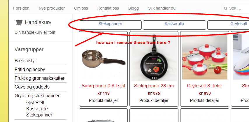

I have the accordion function with sub categories enabled together with the funchtion "Link on main categories" set to YES
But when I click on a product category with Sub-categories, the sub categories are displaying at the top of the product listning. How can I remove them from here ?
It is enough for me that they are displaying to the left in the Category module.
Please see image below to see what I mean.

11 years 10 months ago #131440
Ok, I think that I finally understood your problem, you'll be able to do that by :
- Using a product listing instead of a CATEGORY listing, so you'll be able to list the product under your category, and not your category under your category
OR
- Using some CSS code like :
#hikashop_category_information_menu_156 .hikashop_subcategories_listing {
display: none;

10 years 8 months ago #184256
I am now updating my hikashop online store to Joomla 3.3 with hikashop version 2.3.4
I want to remove the sub-categories in the Product listning. So I implemented the the code like explained in this thread.
#hikashop_category_information_menu_102 .hikashop_subcategories_listing {
display: none;
But this time it does not work. The men number "102" is correct. And I tried implementing the code in both Front-end CSS File "Custom" and Styles for the front-end "Pictureblue".
But it does not work, any advice ?

10 years 8 months ago #184354
There is no categories listing on that page.
On this page however ( www.kvikkimedia.no/shop/kategori/fritid-og-hobby ) there are categories at the top and it is for the menu item with the id 103.
Thus, that CSS will do the job:
#hikashop_category_information_menu_103 .hikashop_subcategories_listing {
display: none;
