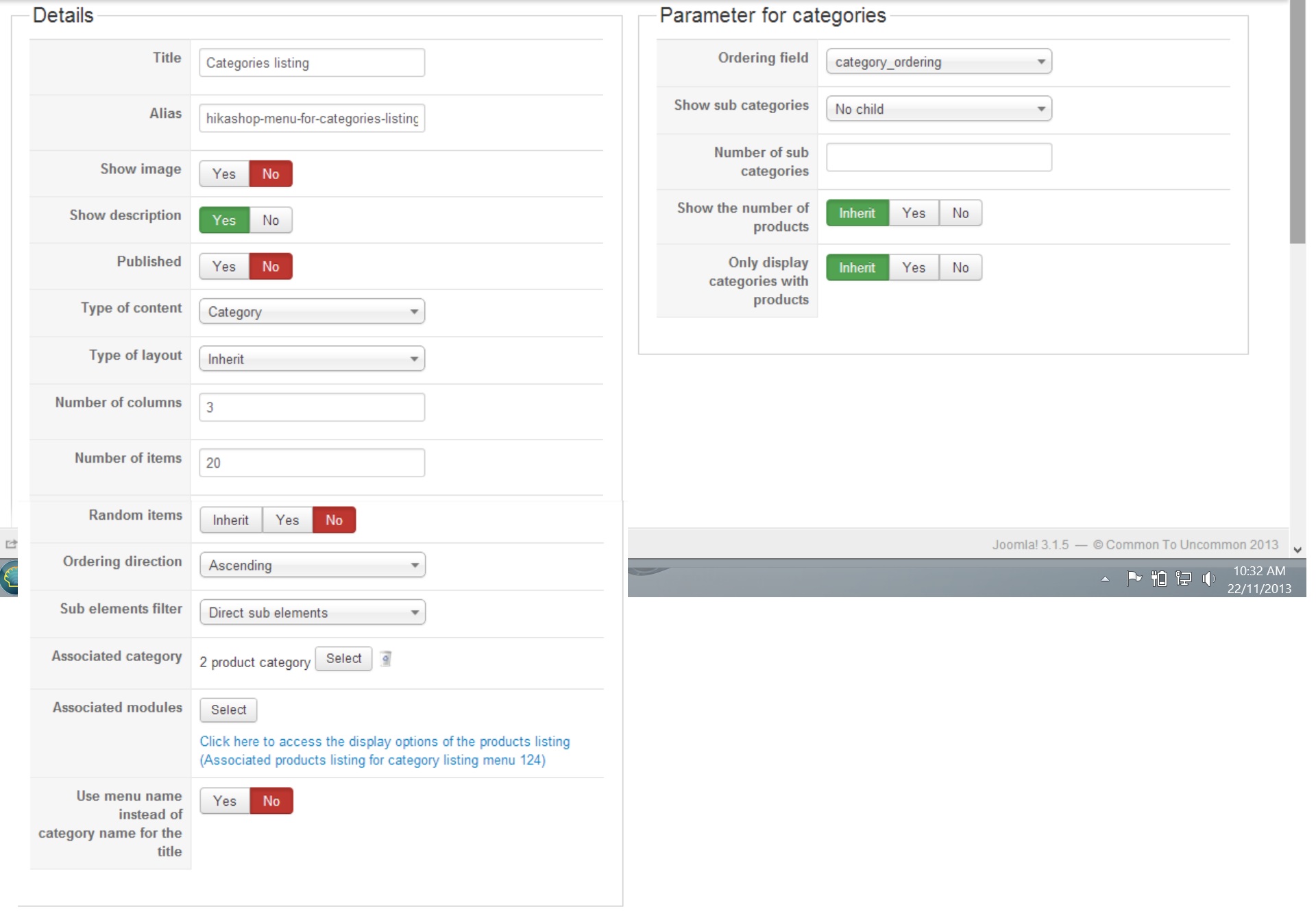

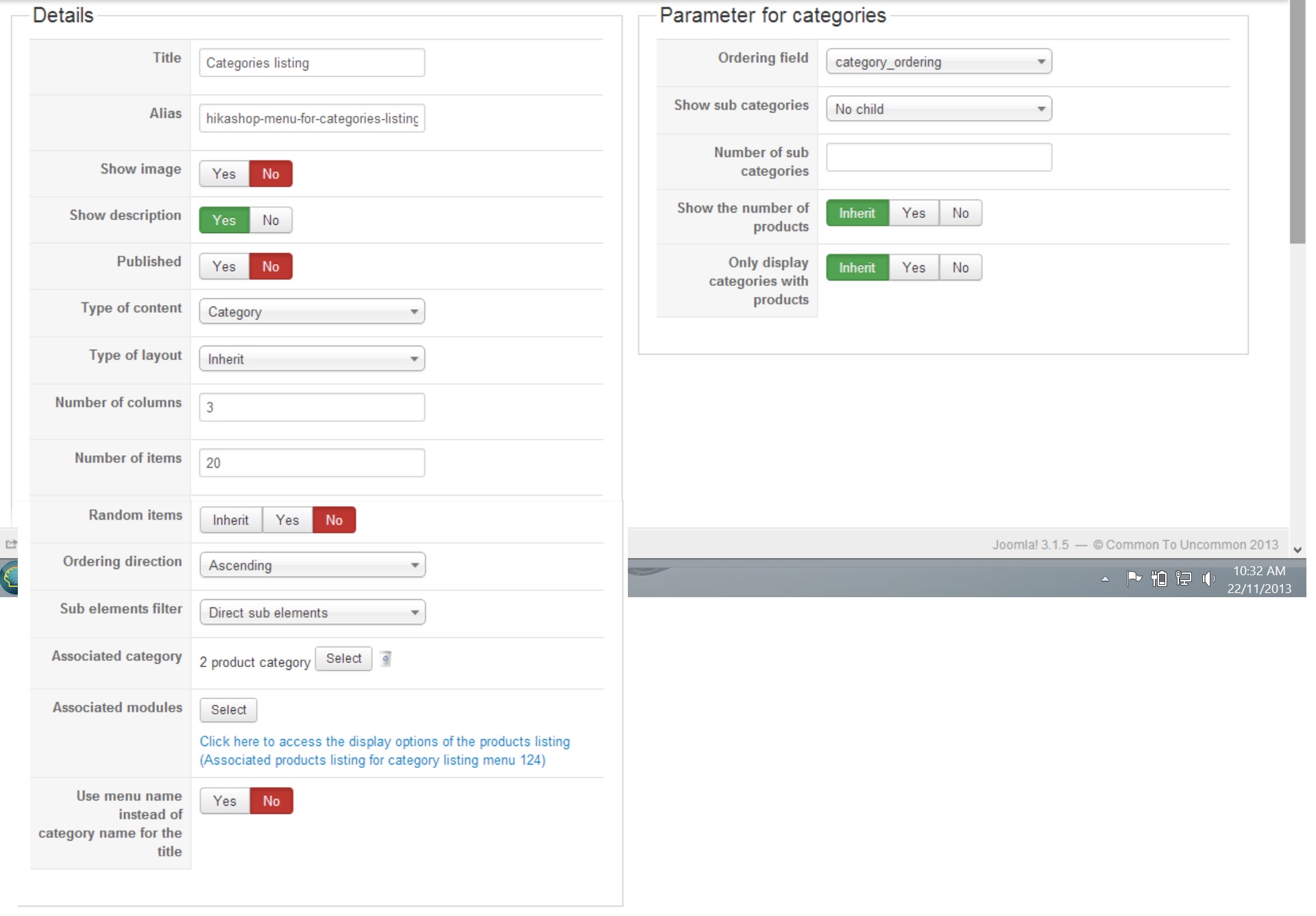

I have attached a screenshot of the configuration. It is the default setting actually. i don't need it for this project. I publish it to test if the other hikashop menu types are working properly because the menu type for product page is not. BTW, I did use K2 in this project as well, so I'm not sure if there's some conflicts.

12 years 7 months ago #133946
I don't think that it's linked to that menu item.
Usually, such issue (where com_content is called instead of com_hikashop) means that a category name has the same name as another menu item, joomla category/article and thus the SEF system of Joomla thought that it had to be displayed by com_content which didn't find any category with that id and thus created any error.
