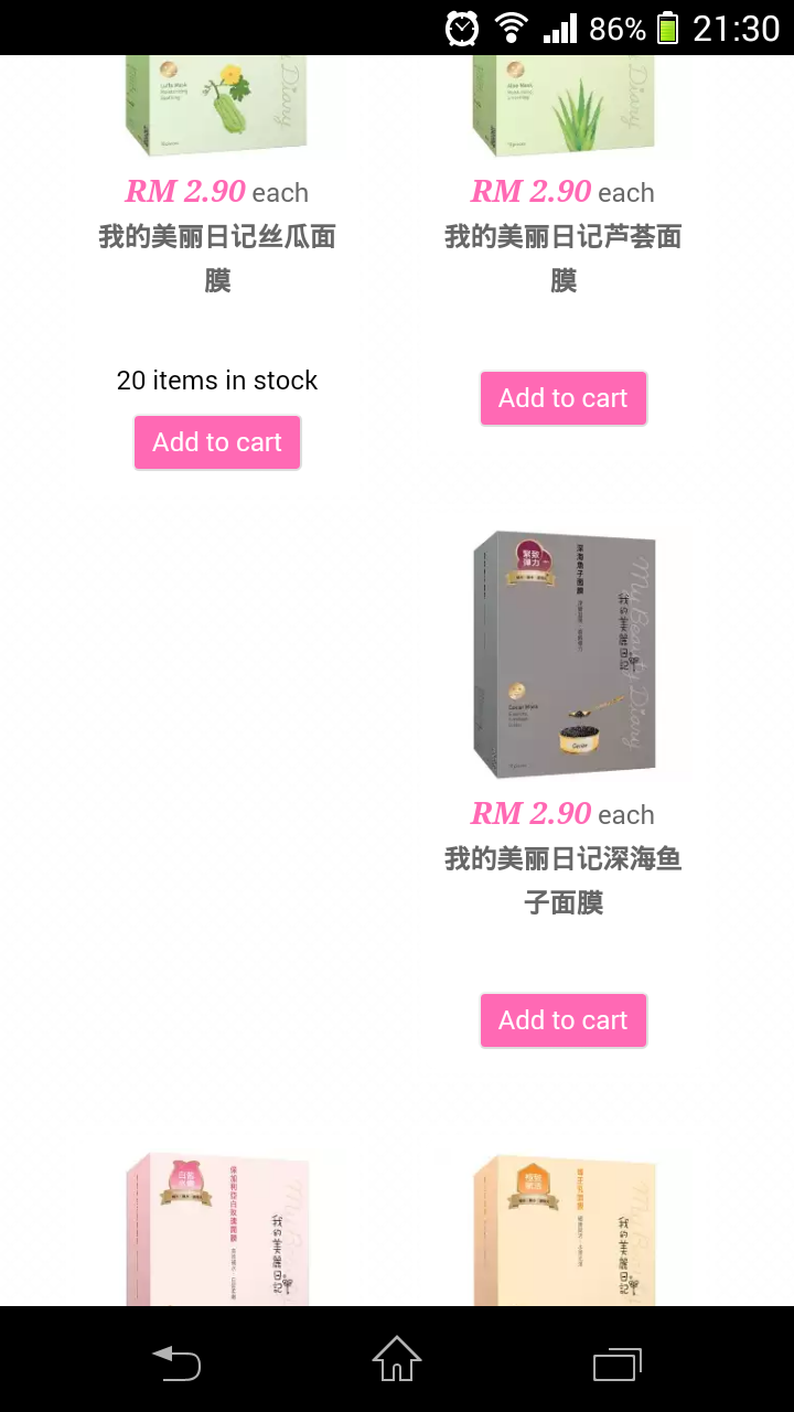

  • Posts: 575
  • Thank you received: 11
10 years 10 months ago #212161
We still face random problem after removing clear property
Please see screem shot below
  • Posts: 575
10 years 10 months ago #212162
See picture below for the float problem…

  • Posts: 575
10 years 10 months ago #212191
Dear Nicolas
Sorry that think we are far a bit from the question
MY problem above is related to height?
My display setting is using div with 3 column, however we need to remove the clear:both in order to have 2 column view with your code above in responsive view
but there are intermitten blank column as above

  • Posts: 250
  • Thank you received: 7
10 years 10 months ago #212346
The height matters because of the way css floats work. In your screen shot the first item in the first row is taller than the one to it's right, so the third item floats against the bottom part of the first item. This then pushes the document flow down to the bottom of the third item so the fourth item floats left under that, leaving a space above. The only way I found to resolve it , as has been said, is to use javascript to make them equal height then they all line up nicely. Another option would be to use javascript to lay them out so there are no gaps ( like Pinterest ), but I preferred the equal height approach.
Ian
