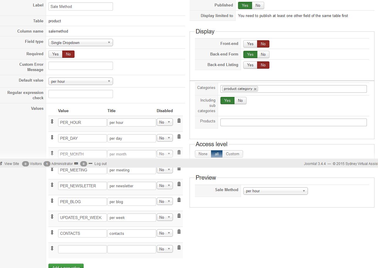

  • Posts: 86106
  • Thank you received: 14207
10 years 10 months ago #217929
If you don't have $this->element->salemethod or $this->element->main->salemethod or $this->row->salemethod
It means that you didn't create a custom field with the column name "salemethod" via the menu Display>Custom fields
Could you check on that ?
Could you do a screenshot of the settings of your custom field ?
  • Posts: 38
10 years 10 months ago #217953
Here's the image as requested. As you can see I have followed your documentation. The thing is that it is working on the price per unit but when I request a range (i.e. the first if statement) it doesn't have the isset. My php is a little behind on the correct creation of this.

The error I am getting is consistent with this.
<b>Notice</b>
: Undefined property: stdClass::$salemethod in
<b>D:\xampp\htdocs\sydney\templates\"sitename removed for client confidentiality on a public forum"\html\com_hikashop\product\listing_price.php</b>
on line
<b>162</b>
Last edit: 10 years 10 months ago by teamtmedia. Reason: Making section of faulty code clearer
  • Posts: 86106
10 years 10 months ago #218064
On the line 162 of your code, I only have that code:
THIS SECTION
So I still don't know what exact line is that error on.
Also, on which page that that error happen ? Could you give a link to it ?
Did you try with $this->row->salemethod instead of $this->element->salemethod ? Do you still get the error if you do ?
  • Posts: 38
10 years 10 months ago #218419
How simple was that?!
So the complete, working code, is
			if(isset($price->price_min_quantity) && empty($this->cart_product_price) && $this->params->get('per_unit',1)){
				if($price->price_min_quantity>1){
					echo '<span class="hikashop_product_price_per_unit_x">'.JText::_($this->row->salemethod).' '.JText::sprintf('PER_UNIT_AT_LEAST_X_BOUGHT',$price->price_min_quantity).'</span>';
				}else{
					if(isset($this->element->main)) echo JText::_($this->element->main->salemethod);
					elseif(isset($this->row)) echo JText::_($this->row->salemethod);
					else echo JText::_($this->element->salemethod);
for future reference
