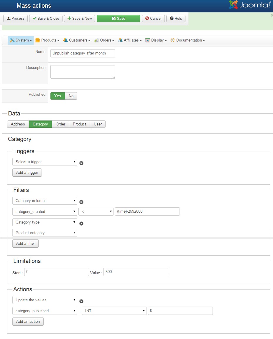

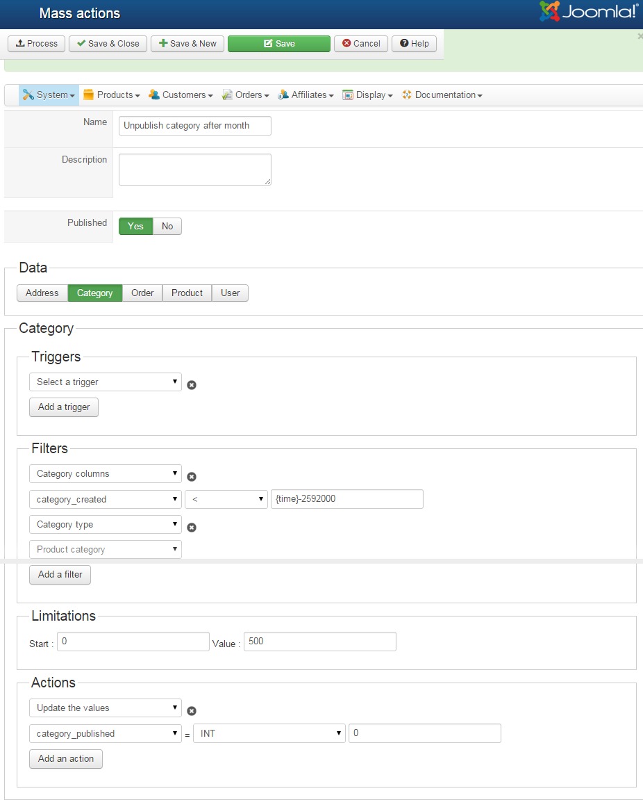

  • Posts: 193
  • Thank you received: 76
11 years 10 months ago #179040
You can create mass action for this with undocumented {time} placeholder.
2592000 is number of seconds per 30 days so you can adjust it to fit your needs.
