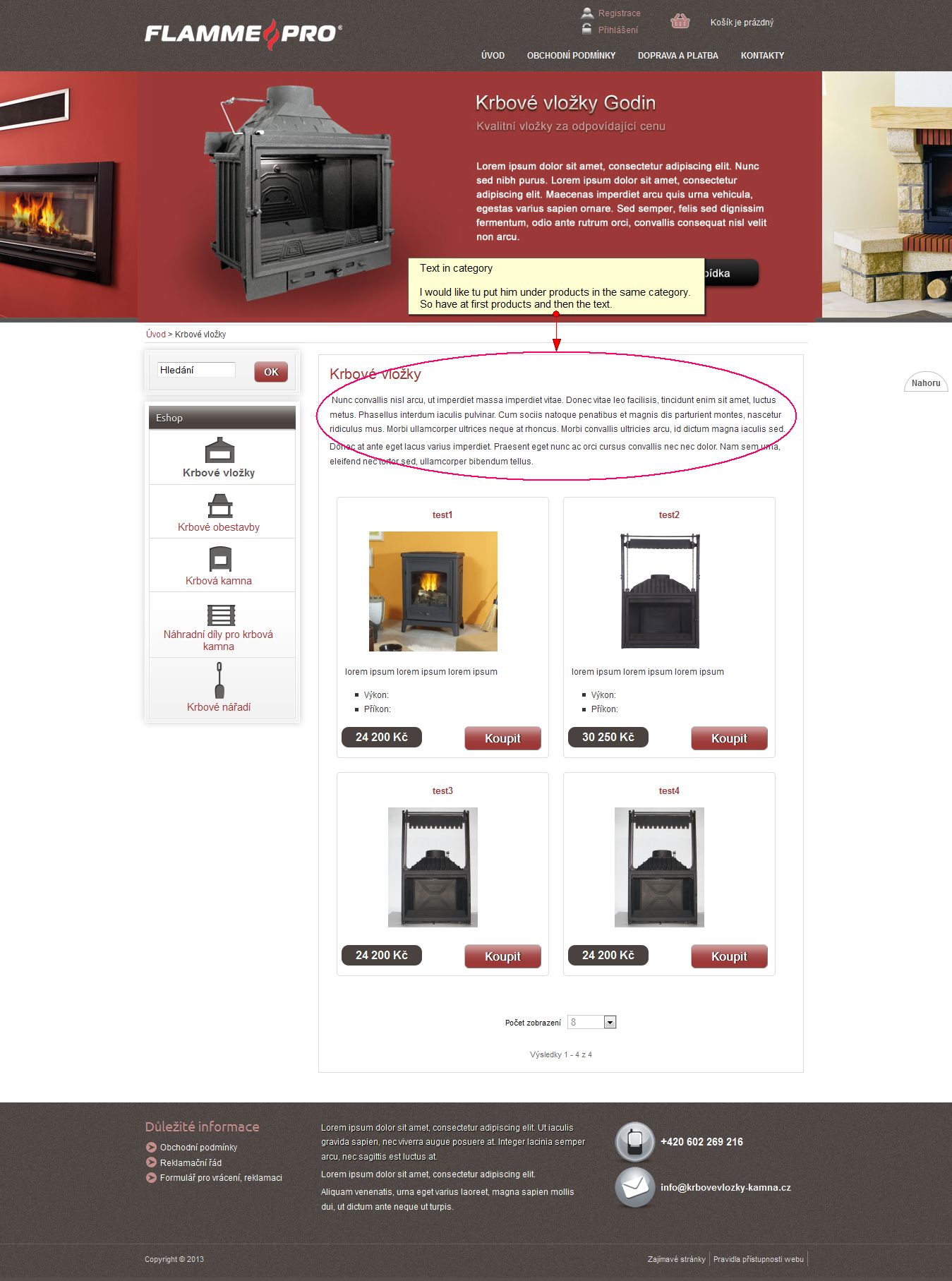

is there any possibility to change the view of the category page?
I would like to put at first products and under them the text in category.
Could you help me?
Best regards

12 years 5 months ago #140354
Here is the picture of the category page.
There is text and that product.
I would like to have at fist products and the text on the bootom of the page.

12 years 5 months ago #140397
Edit the file "listing" of the view "category" via the menu Display>Views
And move the code
<?php echo JHTML::_('content.prepare',$this->element->category_description); ?>
at the end.

But I think correction must be done in "product listing". On the picture is page with products and it is one category.
I tried it and it works perfectly.
