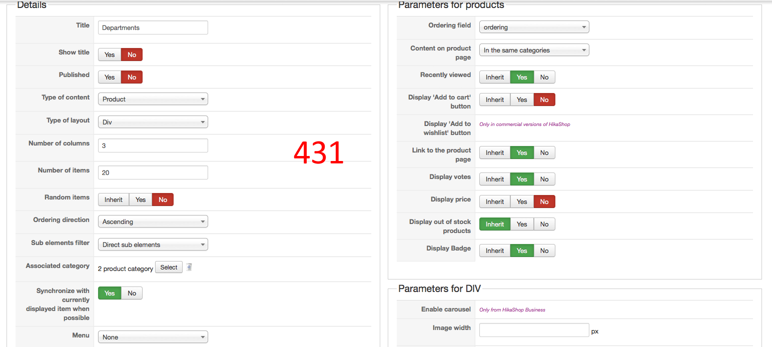

Can you also attach some screenshots of how did you configured your product listing content module which have the ID number 431 through the page "Hikashop->Display->Content module" ?

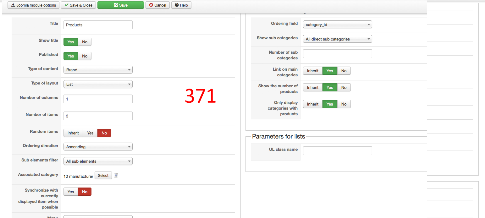

12 years 7 months ago #141086
The product is actually using ID 371, 431 is disabled.
But here they both are.

Even if the module is disable for the general, you can force a publication for a specific place.
The module 431 in the page you gave the link. You can see in the source of the page
<div id="hikashop_module_431" class="hikashop_module ">
Well, this module, 431, does not have the option "random" activated.
So you just have to activate it.
