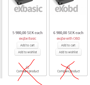

Can we have a comparison page without having a compare button on each product in the store? I am unable to find the code in the files...

  • Posts: 31
12 years 7 months ago #143181
That is what I have done. I have a link in the menu that directs the customer to a comparison page with 4 versions of our product. Where I am lost is how to remove the boxes from the store items. I am sure I am just missing something...

12 years 7 months ago #143234
You need to turn off the "Activate compare mode" option of the configuration.
  • Posts: 31
12 years 7 months ago #143251
When I set Activate compare mode to no... I then get a Message-Product not found on the page when the menu item is selected.

12 years 7 months ago #143275
That's not normal.
Change the line:
if(empty($this->elements) || !$this->params->get('show_compare')){
to:
if(empty($this->elements)){
in the file "compare" of the view "product" via the menu display>views and that should fix that.

12 years 7 months ago #143432
Perfect!
