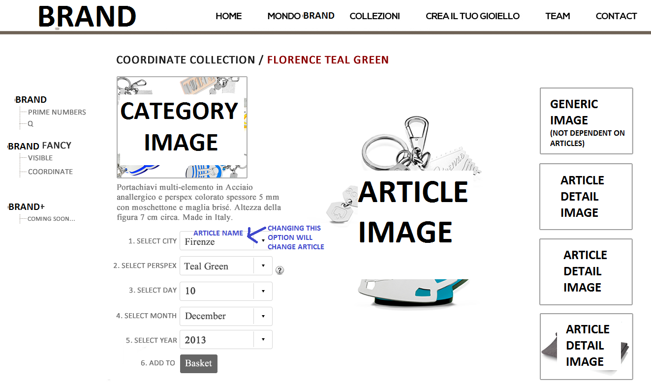

I need to implement the page I attached here. :(
1 - What do I need to change to have the result showed in the page. Particularly. TO HAVE articles on the right, options on the left, etc. ? I guess I need to work on View /product / and then ...
2 - is there a built-in option which allows to show the "category image" on the article page (as showed in my page)?
3 - consider that my page shows article page related to category "A". The page of the category "B" articles will have an other layout. So, this means I will need to work with overrides views, doesn't it ?
Thanks a lot ! Thanks a lot ! :)

1. use the "reserve" product page layout instead of the "default" or "inherited" one in your category settings and the right and left panels of the product page will swap.
2. There is no such build in option. It will require you to edit your product page layout (so show_default or show_reverse) and add custom code for that. To get you started, here is a thread about adding the category name on the product page:
www.hikashop.com/forum/4-how-to/64957-ca...-products-pages.html
3. Yes, you'll need to create several product page layouts (when you edit one of them, you can change the name of the file at the top and when you save it creates a new one that you can select in the "layout of product page" setting of your categories).
