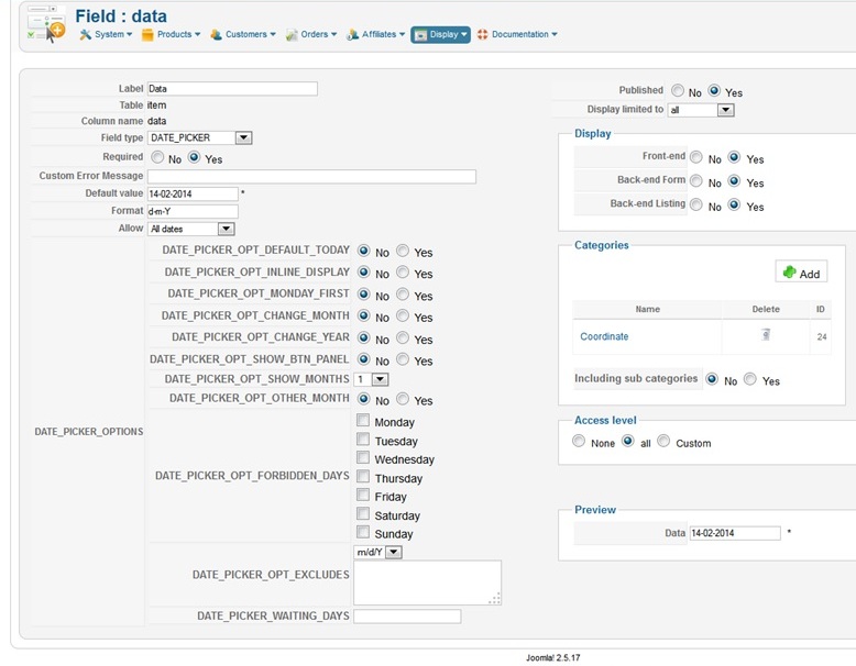

12 years 6 months ago #145551
I manged to remove the error!
Now, I have problems on labels names as you can see in the attachment.
Is the label named like you see, like "Date_picker_opt_default_today" and so on?
2)
I need instruction or manual or somethingh similar to understand the purpose of each fields? Have you got anythingh about it?
Thanks.

12 years 6 months ago #145767
The datepicker comes with an english language file.
Can you please check that the file "en-GB.plg_hikashop_datepickerfield.ini" exist in your website ?
I will try to reproduce your problem, see how the language file can not be loaded correctly.
If the problem still persists, you could copy the content of this language file into the HikaShop language override. At this moment you will be sure that the language content will be loaded.
The option "excludes" allow you to exclude specific dates ( 02/25/14 ) or date ranges ( 02/25/14-02/28/14 ). To exclude several years, you have to exclude several months ( 02/14-02/16 )
