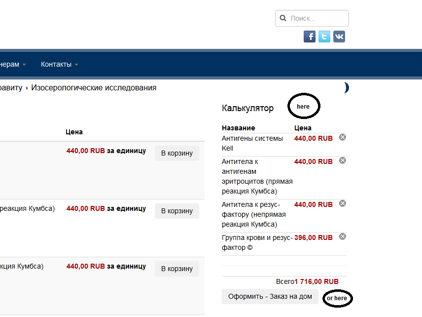

12 years 6 months ago #144395
Can you show me some screenshots of where do you exactly want to add you "print" button ?
Thanks :).
  • Posts: 7
12 years 6 months ago #145269
If possible I want to add the "Print" icon to my cart, the picture is below.
Thanks a lot.

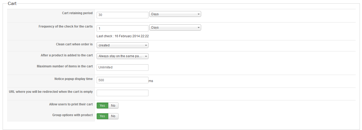

12 years 6 months ago #145517
There's already an option to do that, so you'll just have to set the "Allow users to print their cart" option to YES through "Hikashop->System->Configuration->Main->'cart'".
  • Posts: 7
12 years 6 months ago #145847
Mohamed Thelji wrote: Hi,

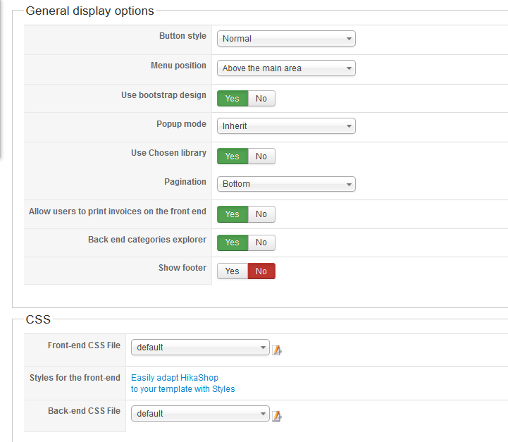

"Allow users to print their cart" is already enabled! but I see nothing! at the cart itself.
this is the reason why opened this thread. :huh:
