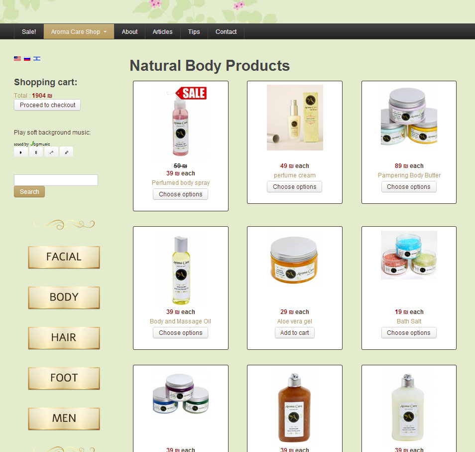

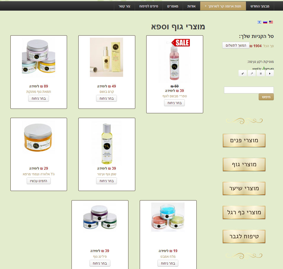

Hi, I just have this problem with the product listing page, everything is working fine besides that, RTL & Bootstrap. I dont know why you cant see the site, its fine: www.aroma-care.co.il/ but anyways here are some jpg - english (ltr) in bootstrap design & in Hebrew (rtl) in bootstrap design. If bootstrap design set to NO, there is no problem! but I want the site to be accessible via smartphones as well.

Buying style ll not resolve the problem. People have to undertand what they do and so need to understand css before go to premade template or preprocessor ( less compas) . IF they don't do it they ll need support and so pay . Template, framework ( joomla or bootstrap) preprocessor are layer that developper need to study to understand the in out of this layer . Read css file like reset.css and undertand why this file occur is something to do among others ...........
a---the layout using english is wrong when we reduce the width size of the browser
b-- in default language there is wrong alignmeent vertical and horizontal ?
where is the problem ? can you create a virtual capture screen with what i have and what i want and highlight the problem in one raster file ?
c- THERE IS 17 js and 40 css !!!!!!!
d- you use the bootstrap T3 blank FW ( i don't test it a lot )
e- 17 mediaqueries but only 8 breakpoints !!! WOUAHH !!! ( don't test or try to understand logic )
I dont really think it is a rtl problem . capture screen is not efficient if you don't highlight the problem ( arrow annotation ) .
An image is 1000 words but ti s easier with some informations ( capture screen before after , actual - aim ) .
So refer to the problem ( image outside box , different vertical/horizontal alignement ) ,here is 2 changes that i think could resolve the problem ( don't know if related to the post ) . It can create other problems because i not test combination of language & mediaqueries ( size width of browser )

Hi, thanks for helping, the problem is that in ltr language the products are oriented in a nice table and in rtl they are not. If you know how to solve this I'll appreciate it a lot. Purchasing ans Installing Hikashop Styles didn't work... :S
