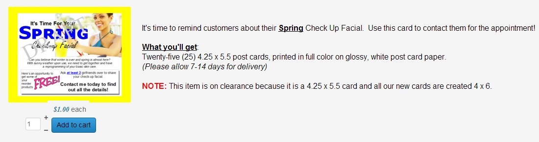

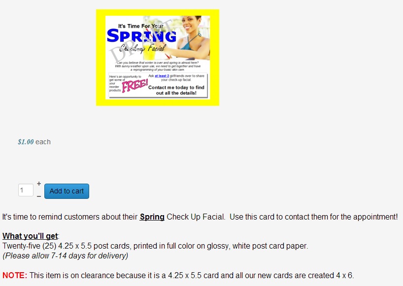

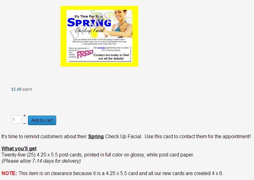

I'd like to make my product description display on the SIDE of the product...
AND I'd like to move the product price and add to cart button up under the product image.
Here's how it currently looks
I'd like it to look like this
I realize I'll have to alter some code or something....what I would need (because I'm not that familiar with CSS although I'm learning) is to know what code to copy and from where and where to copy it to.
Do I do this in my website's control panel (CPanel) or do I do this in Hikashop's views, etc.

12 years 6 months ago #145830
The solution will be to use some CSS code, and to edit the "Show_default" file of the "product" view of your front-end template through "Hikashop->DIsplay->Views" and move the code :
  <div id="hikashop_product_description_main" class="hikashop_product_description_main">
    <?php
    //DISPLAY the product description
    echo JHTML::_('content.prepare',preg_replace('#<hr *id="system-readmore" */>#i','',$this->element->product_description));
  </div>
Just after this line :
<div id="hikashop_product_right_part" class="hikashop_product_right_part span6">

12 years 6 months ago #145940
Thank you....I did it...and it's not working.
Here's what it looks like in my code. the underlined part is the part I copied and moved to right under the line you told me to. Yet in my site, the info is still under the image.
    <?php

12 years 6 months ago #146052
I think that you will have to set a width on the left and right part, you can set for example 45%.
.hikashop_product_left_part{ width: 45%; }
.hikashop_product_right_part{ width: 45%; }
You can follow this tutorial to make what you want:
www.hikashop.com/support/153-customize-the-display.html

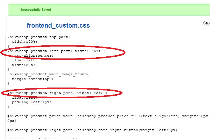

12 years 6 months ago #146187
Thank you...do I put that {width} par tin THIS code.... or do I have to go to the Front-end css file?
12 years 6 months ago #146246
It's better to go to the Front-end css file.

12 years 6 months ago #146360
Thank you Xavier
So.... I went into the front-end css and put the {width 45} in
And the product page still has the content at the bottom of the image and not on the side

  • Posts: 26384
  • Thank you received: 4077
12 years 6 months ago #146388
@simmiepam
The CSS your wrote is not correct.
What Xavier recommend you is to change the width of the two elements by adding new CSS rules.
You replaced the previous rules without the right syntax so now your CSS file is "broken".
If you see your screenshot, you close the "}" on the first line, so the rest of the CSS rule can't be process correctly.
@lionel75
I don't understand your message or what you are trying to explain/ask.
More than that, we are working on new product page layouts in order to propose more choice and more designs. Hope that the new layouts will be appreciated by the users. We are also thinking of new way to propose "easier" customization on product page or HikaShop in general but it ask for time and development.

12 years 5 months ago #148597

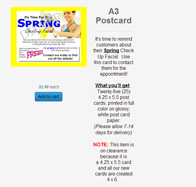

OK...
I've managed to get the description moved to the right of the image.
However....I cannot seem to get the text to be the rest of the width of the page.
I've been using inspect element to try to find it, but I guess I'm not too good at this yet.
Is the place to make the margin for the description in the front-end .css
or in one of the views under display?

12 years 5 months ago #148714
Using this kind of CSS code will probably do the job :
.hikashop_product_item_right_part .hikashop_product_desc {
width: 560px;
