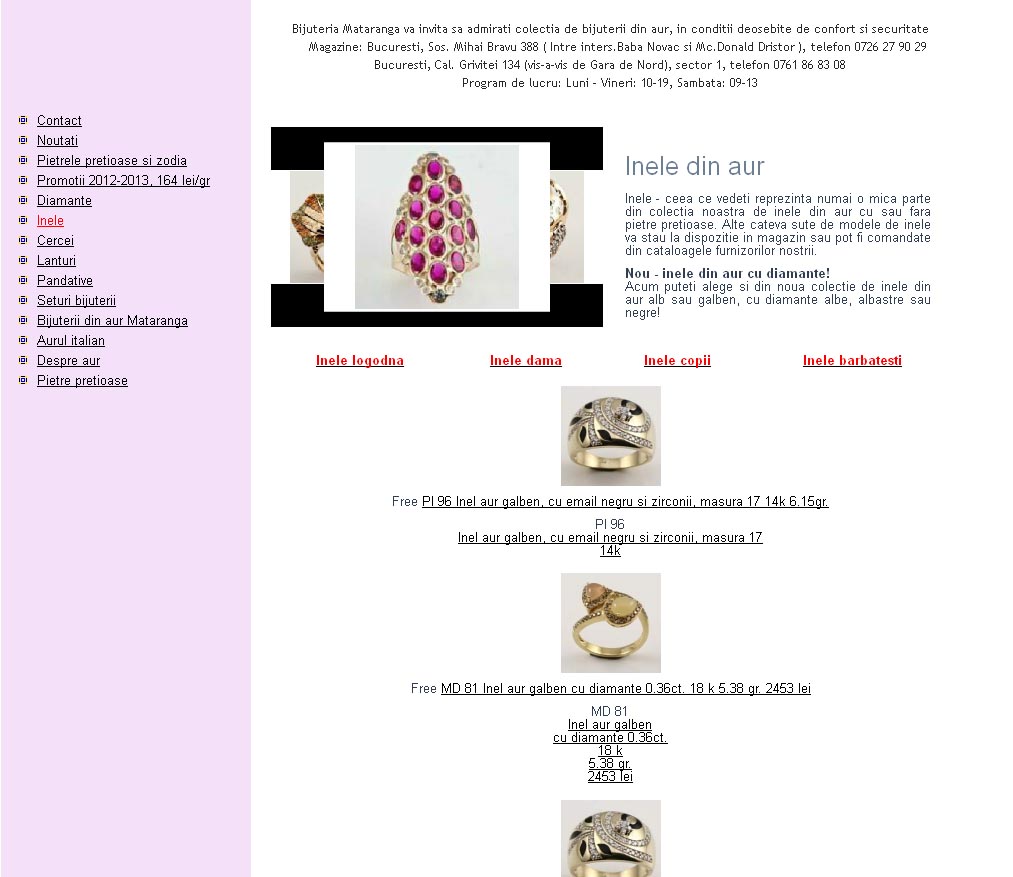

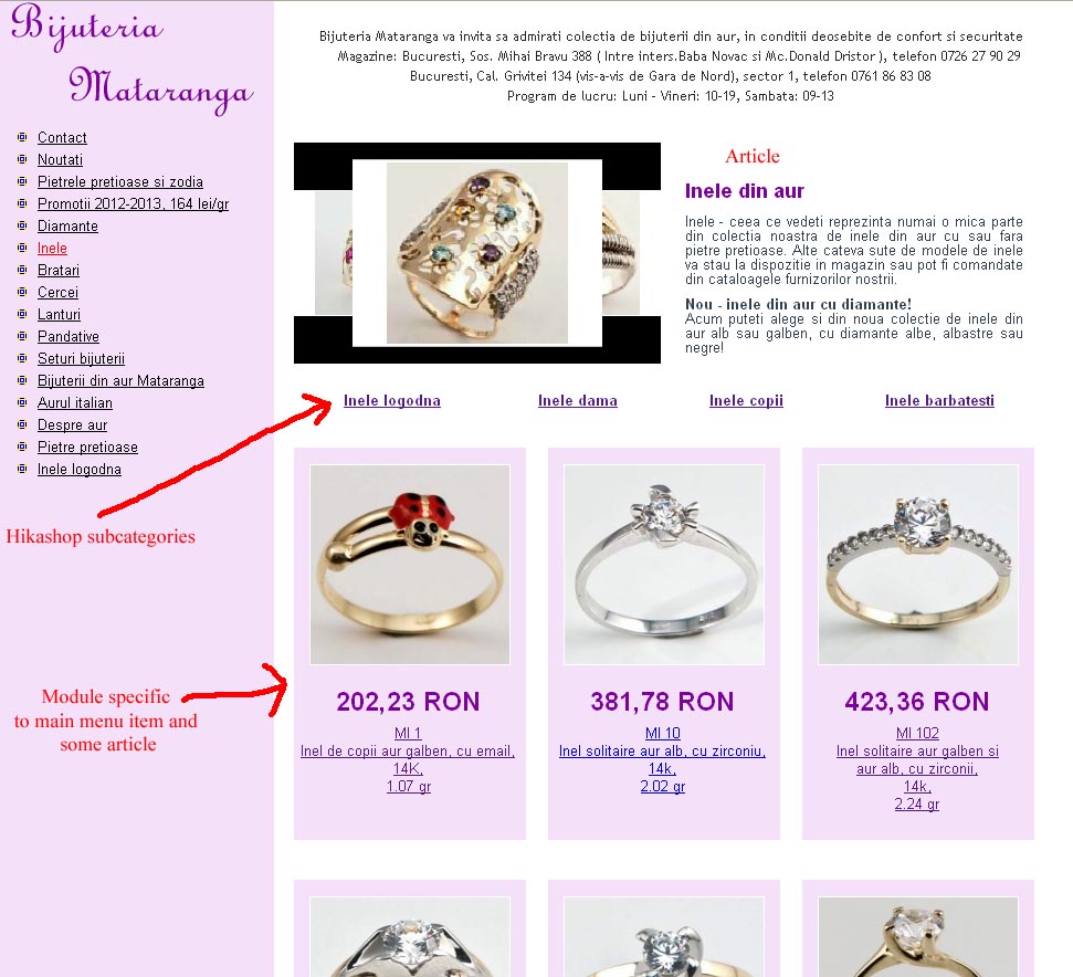

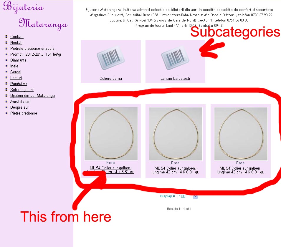

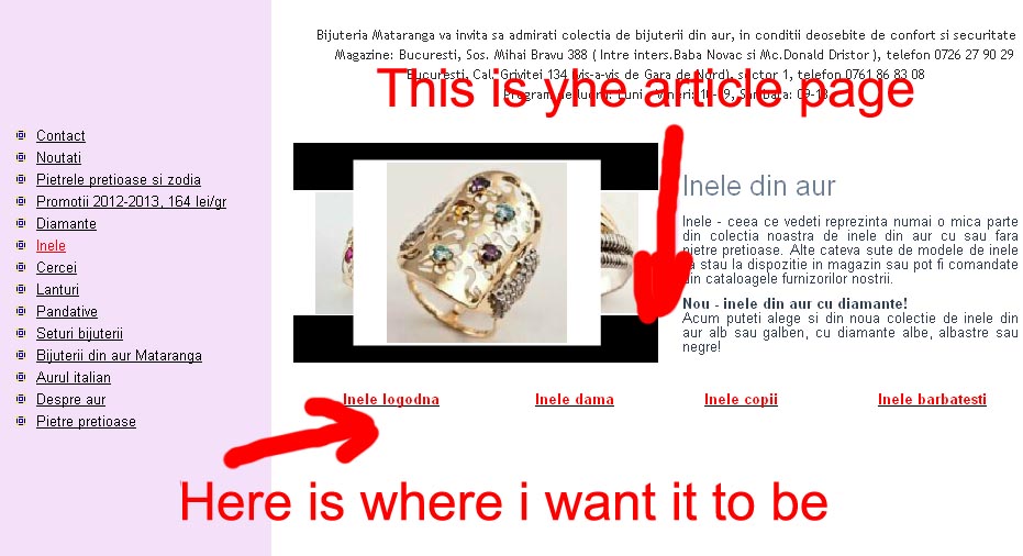

Move product listing from category page to article
  • Posts: 29
12 years 6 months ago #145980
-- Joomla version -- : 2.5.8
-- Browser(s) name and version -- : Mozilla 26.0
I want to move the product listing in my site from category page (witch contains subcategories listing but i don't want to take those too) to an article page that i've created.
I've made some printscreens for an easy comprehention.

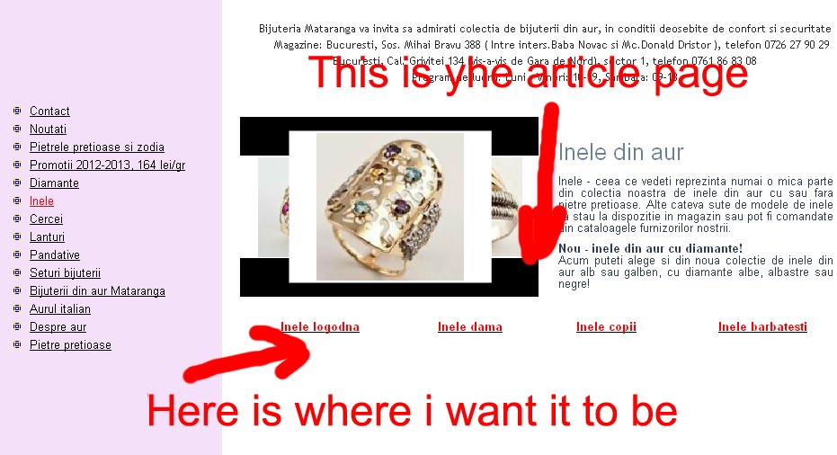

12 years 6 months ago #146046
Thank you very much. I tried the method but i dont get a product galery looking like thingy. I't just a product with almost no styling.
Here is how it looks

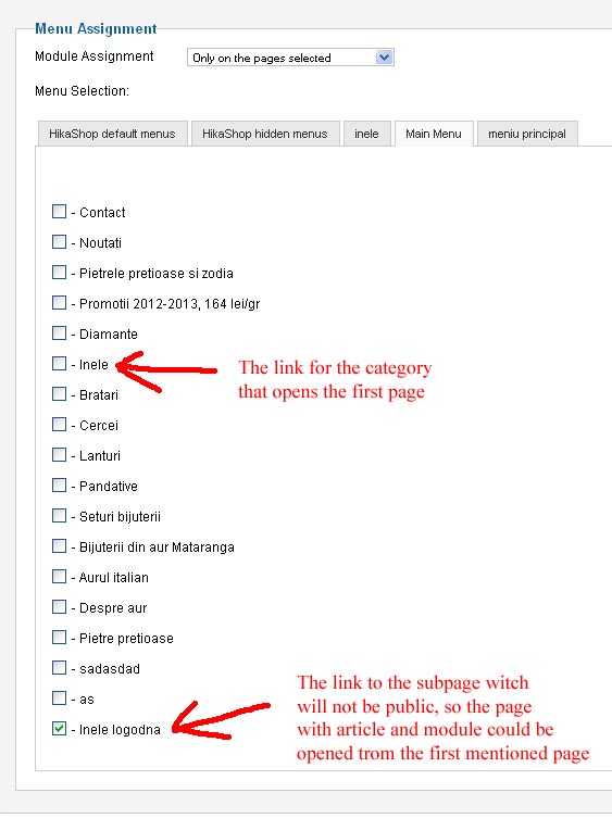

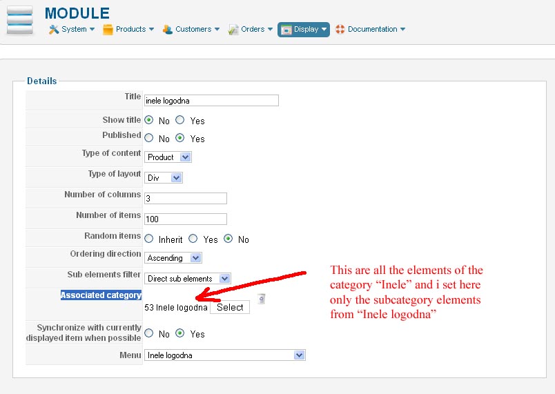

12 years 6 months ago #146109
I think that the easiest way to do what you need is to use/create a position of your template under the article part.
And at this position use a module. This can be done thanks to the joomla module settings.
The module to create is a category listing one, then you just have to configure it as wanted.

it was a great idea and it works. Now i'm trying to figure out how to put different content to this module in function of the accesed page.
12 years 6 months ago #146131
You can create one module per article and restrict the display of the desired module on the desired article (so a specific menu).

Here is how it looks now and until a point it works
The hikashop subcategory links open product listing of a specific subcategory
So i've done another article for the subcategory to put on the top of this subpage and a module to try to substitut the product listing of this subcategory so the second page could look like the first.
I've conected the module for the subpage to the right link in the menu
"inele logodna" is a hikashop subcategory of "inele"

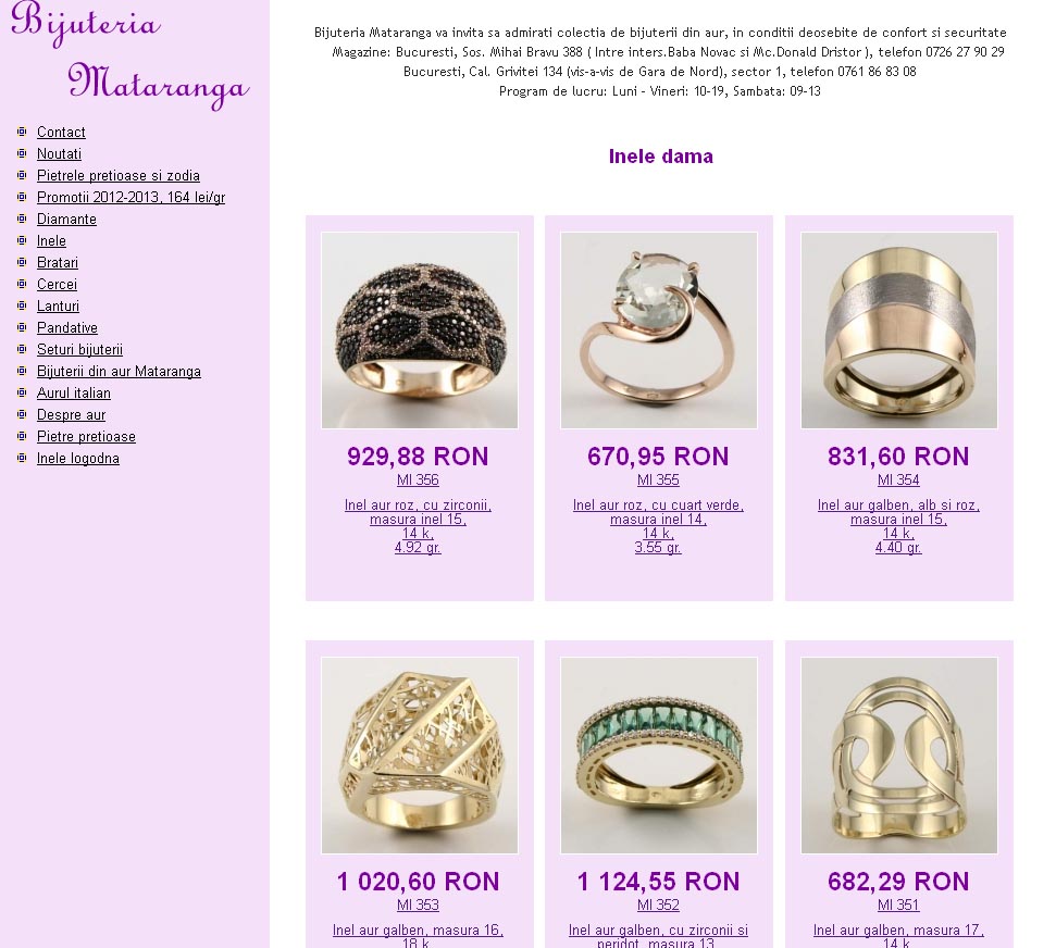

So here i come to a problem:
When i come to the subpage "Inele logodna"the right article apears but the wrong module, the module from the Inele page.

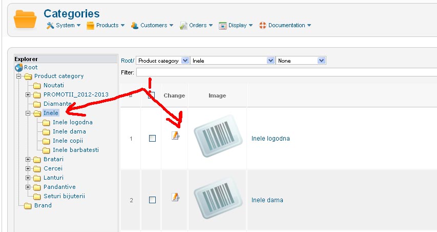

In Module manager for the subpage when i press Hikashop options i noticed that at the associated category I select the necesary subcategory from the list but the number of elements shown afterwords is the number of the entire parent category
How can i select in this module the product listing of the subcategory, not the whole category.
Maybe i have to imput the category id manualy in the database butt i do not know where.
  • Posts: 26384
  • Thank you received: 4077
12 years 6 months ago #147513
When you change the category in a category listing, you are still in the same menu id.
So the same modules will be displayed.
At this moment, I will recommend you to base the module on the category, using some PHP code in the HikaShop views or using other component like "advance module manager".
