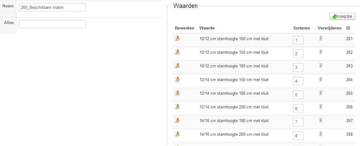

12 years 6 months ago #146127
We did (see attached print screen).
In the configuration we said that it has to be presented in that order.
Although with some of the products it don't work :-(.
Jan
