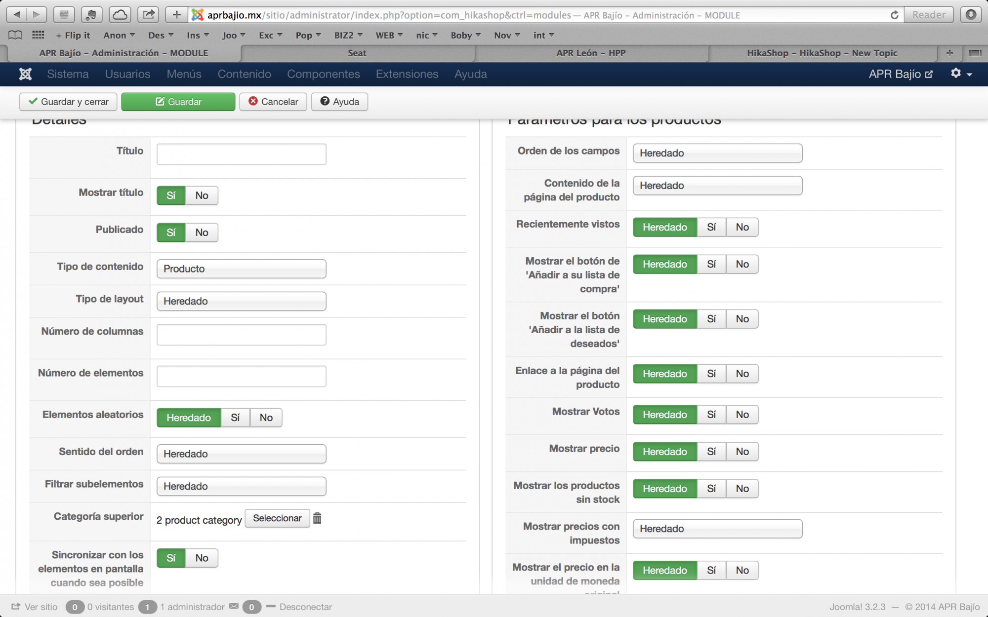

when i try to create a new module in the "content modules" section i'd try to change the category to show and it doesn't let me do it it keep every single time the general category, in the menus i don't have the same problem

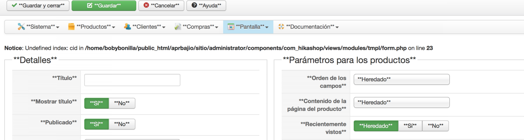

i get this message

The warning is not important.
Please forgot it and be sure that we will fix it. But it is not the source of your problem. Not at all.
The problem is coming from the view "category | selectparentlistin" which does not send the value of the parameter "id" when you browse a category.
At this moment, if you change a category and make a selection, the targeted element which should receive the value of the category id is lost.. And can't be updated.
I made the modifications in HikaShop but there are several points to modify and it won't be very easy to list them you here.
I will see with Nicolas to include the patch I made in a hotfix package for HikaShop 2.3.0
