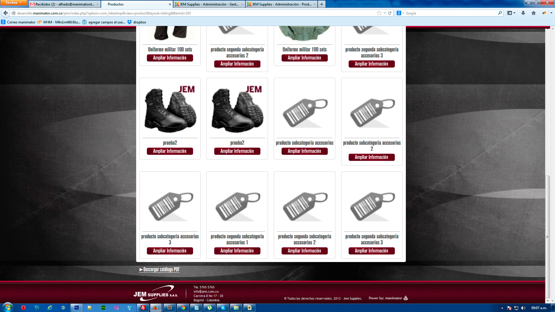

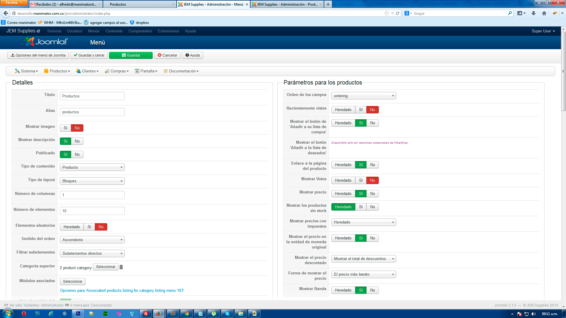

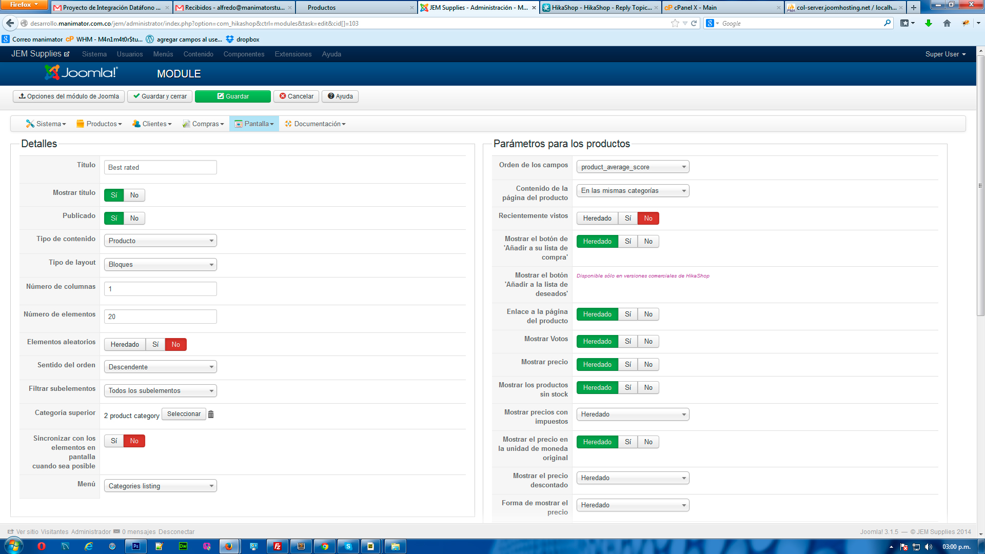

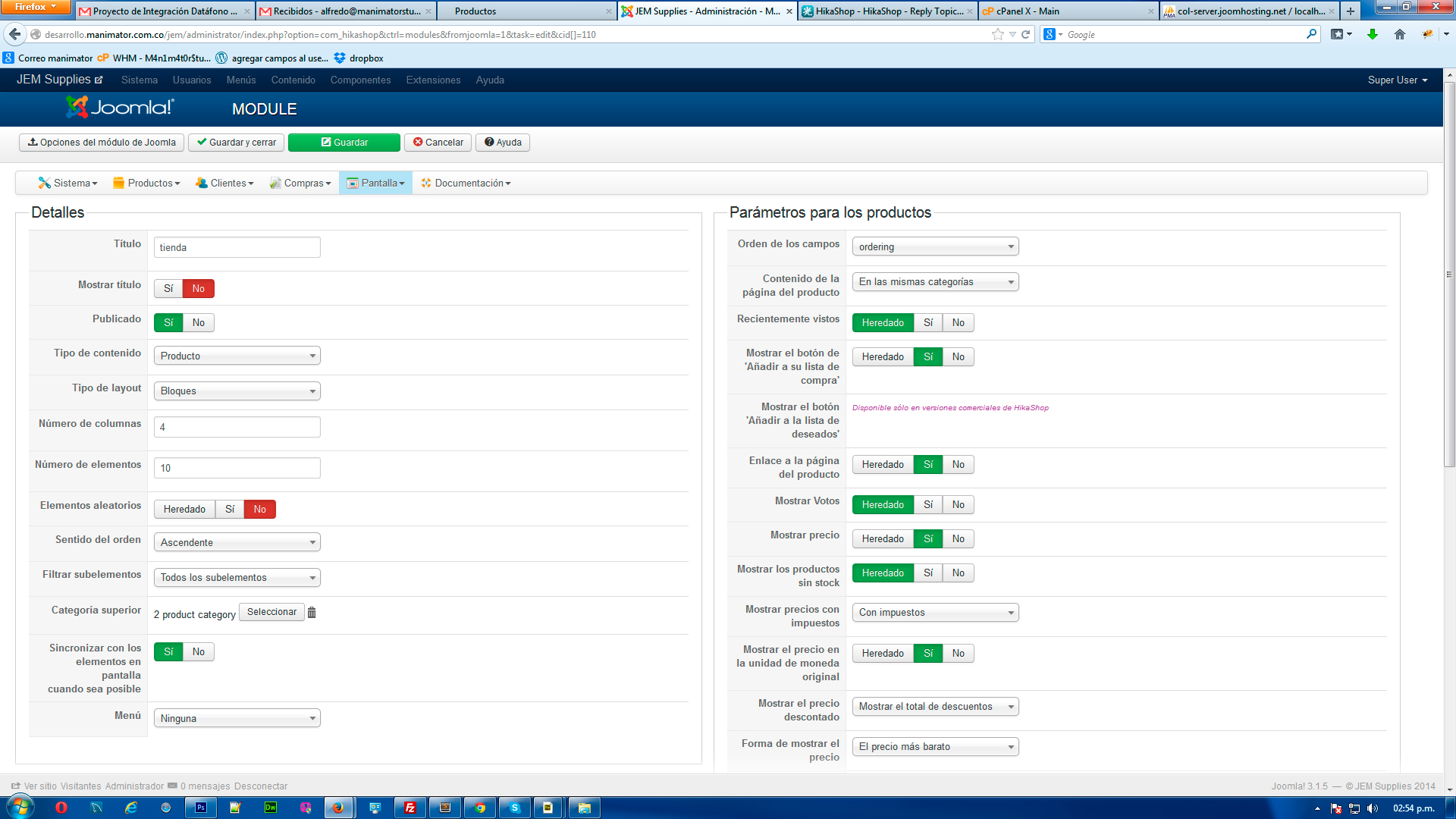

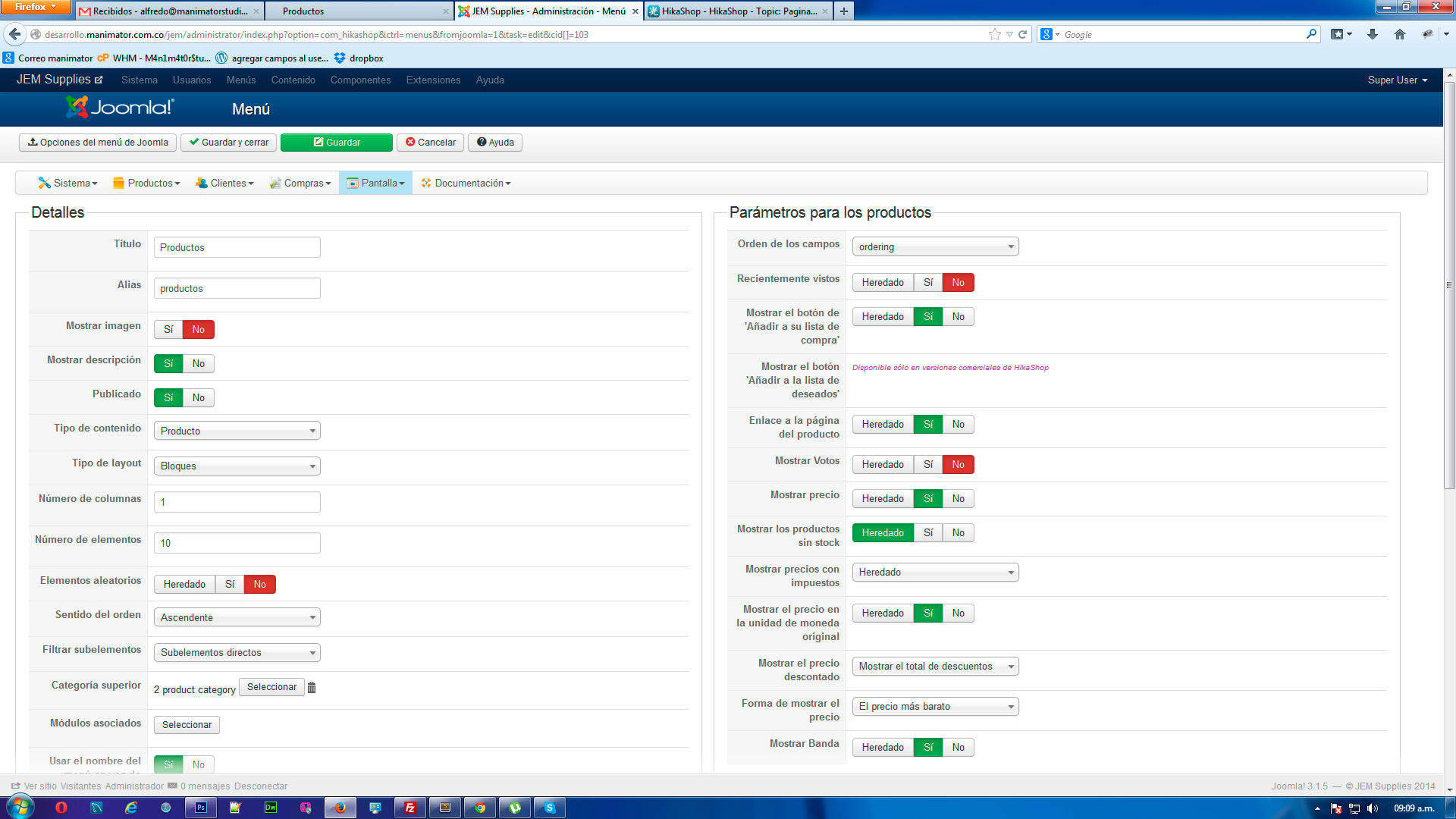

Hi. i'm having a problem with pagination. i will try to show all the information possible here.
i'm linking the menu with the products listing option, and in the advanced options tab i put 10 in the number of elements box, but it still displays 20 elements. and the pagination is not showing, how can i make it appear?
im attaching some configuration images,
Thanks in advance.

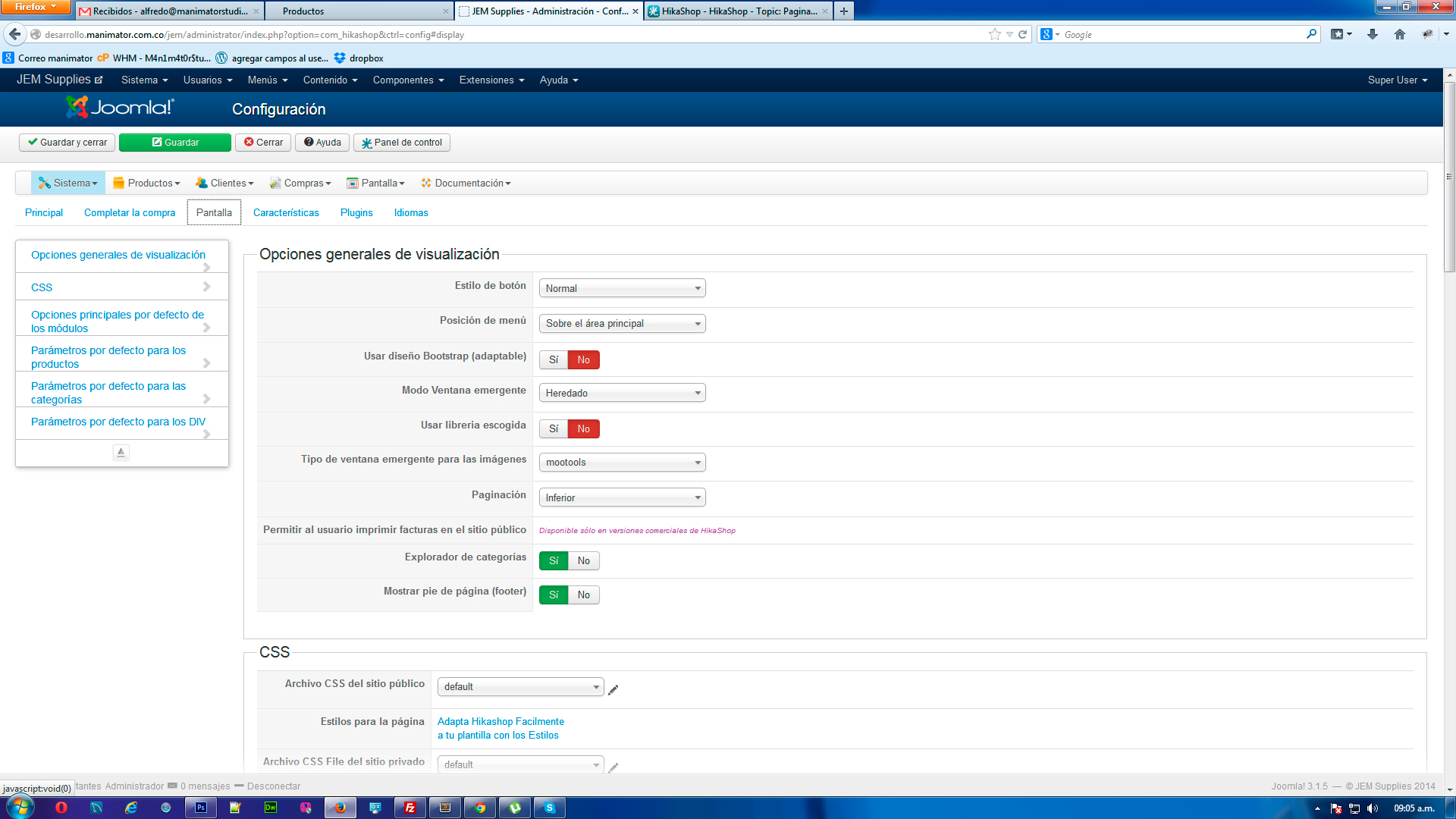

12 years 5 months ago #148128
Thanks to check the value of the option "Pagination" in Configuration > Display > Main.

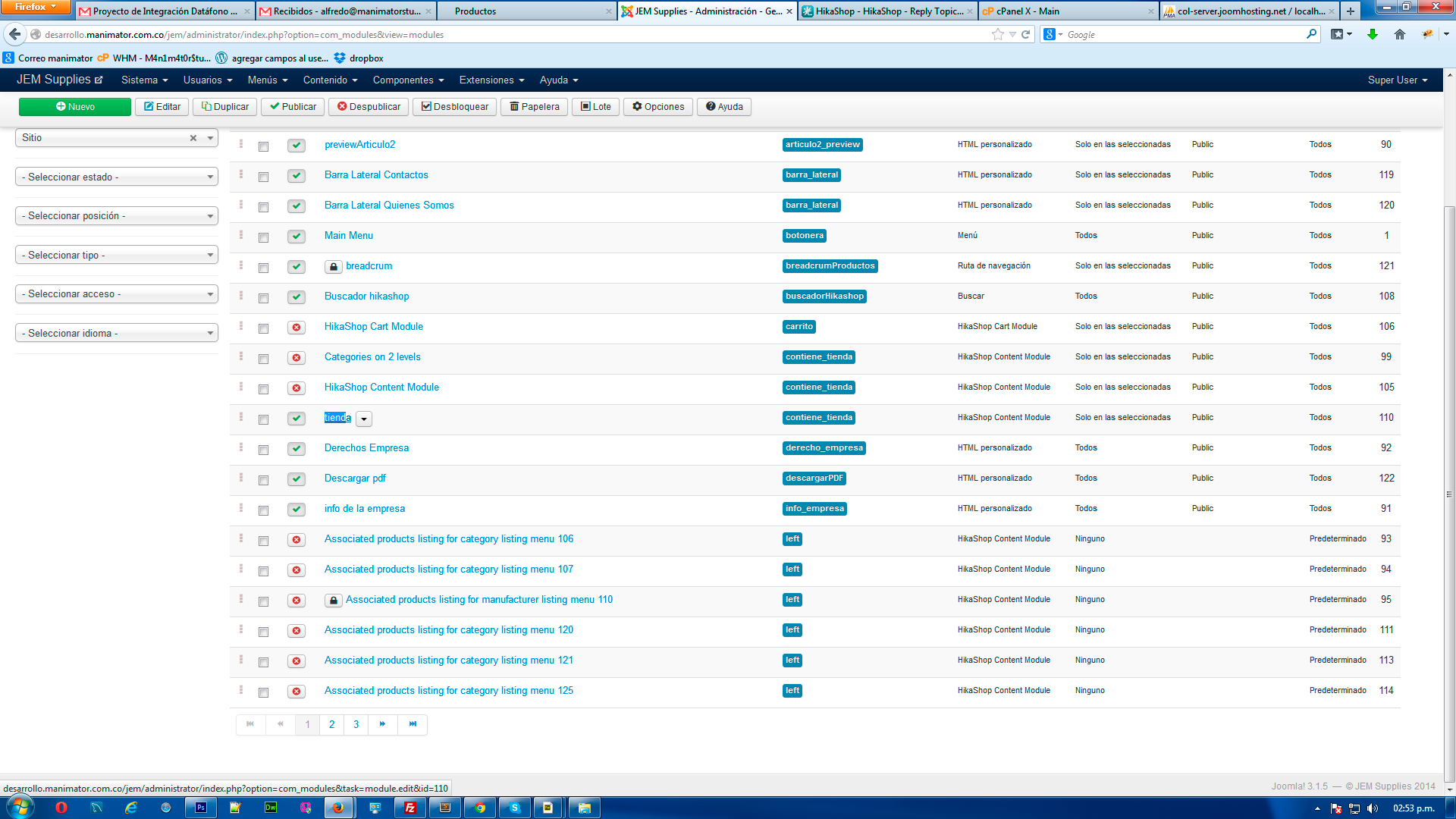

12 years 5 months ago #148224

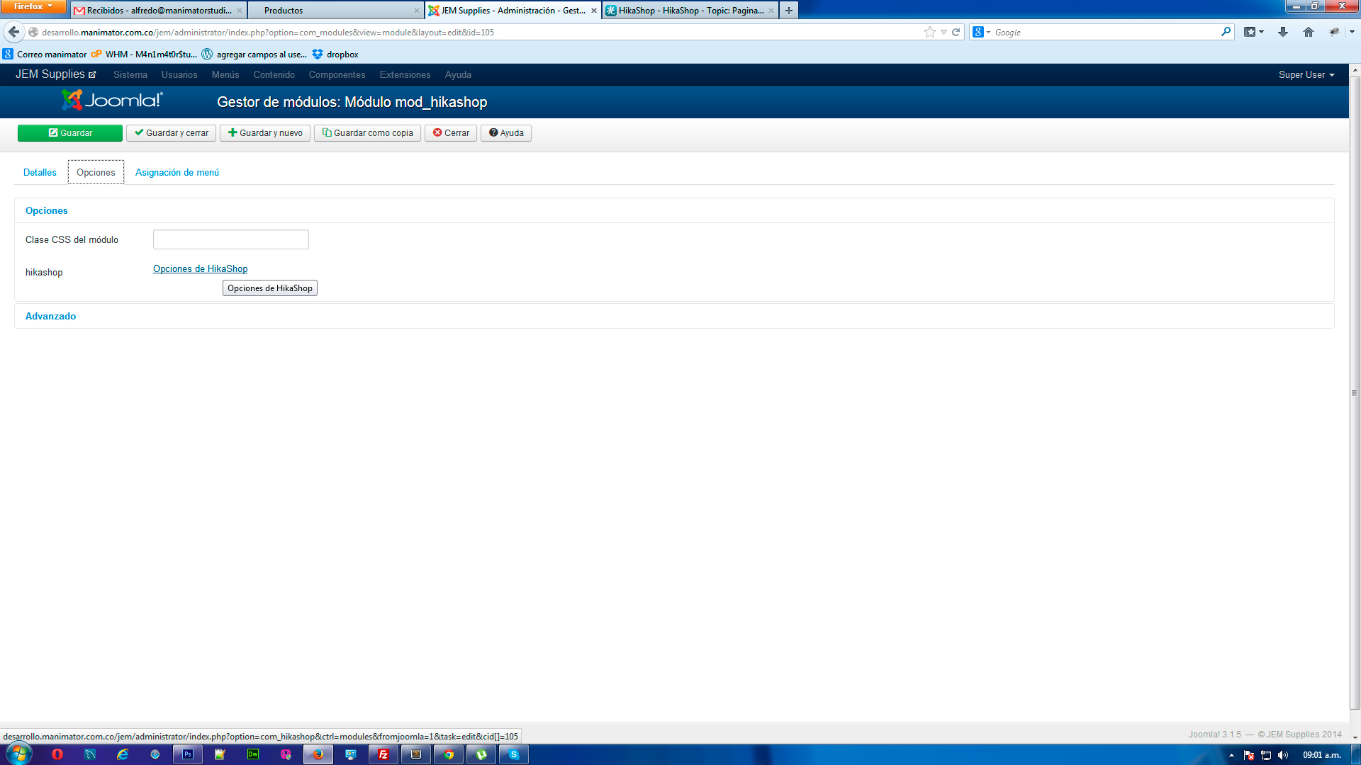

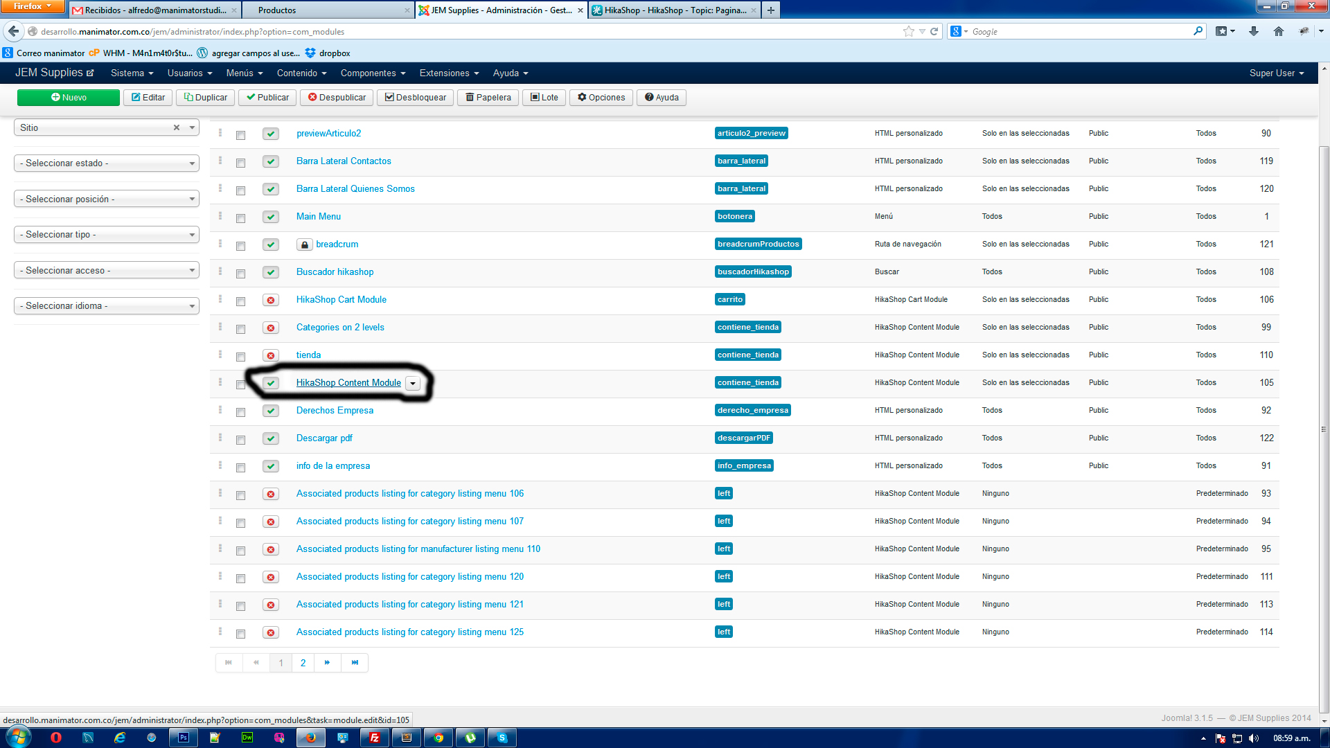

Thanks to try to change the options regarding the number of products to display of the module with the id "105".
Do you have edited any views related on the listings ?
  • Posts: 6
12 years 5 months ago #148342
Hi Xavier.

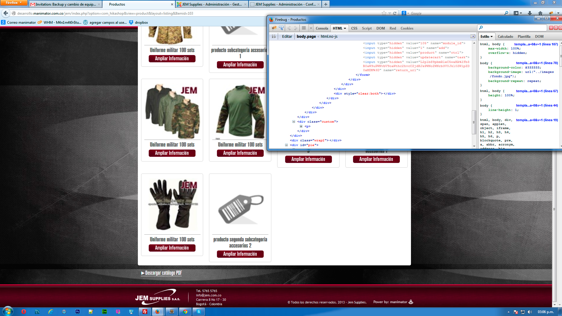

i tried changing the options the number of articles with the id 105. it displays fewer items now, but the pagination still doesnt show. i even tryed searching for it with firebug console with no luck, i tried changing the paginations options in display with no luck.
Thanks for taking te time to read my posts.

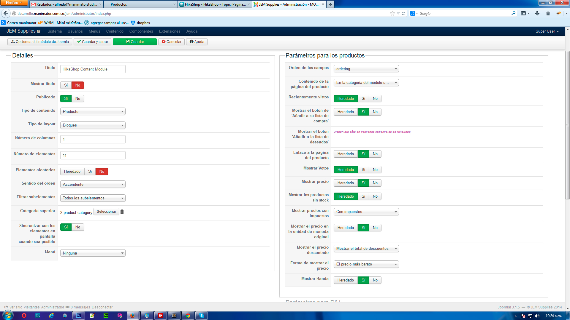

Here i attach most of the configuration options regarding the hikashop module. i even tried changing the 'if' on the listing.php file, and it displays some pagination but it doesnt work. In any case thanks for taking the time to read.
Thanks in advance.
12 years 5 months ago #148984
Do you have more than 10 products through your "product category" category ? Can you try with the "Sub elements filter" option of your Hikashop content module which have the ID number 105 set to "All sub elements" ?
Thanks.

12 years 5 months ago #149830

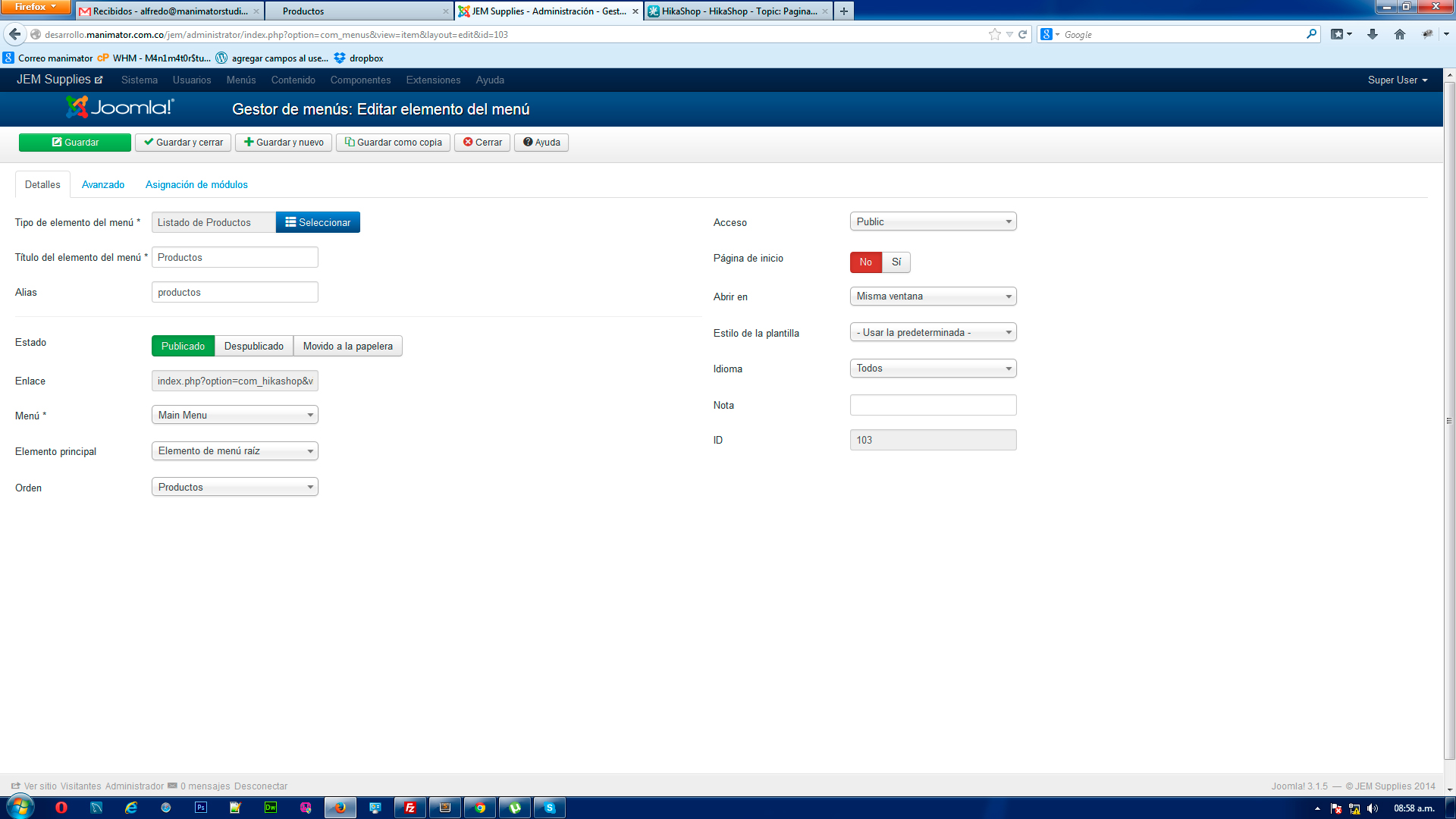

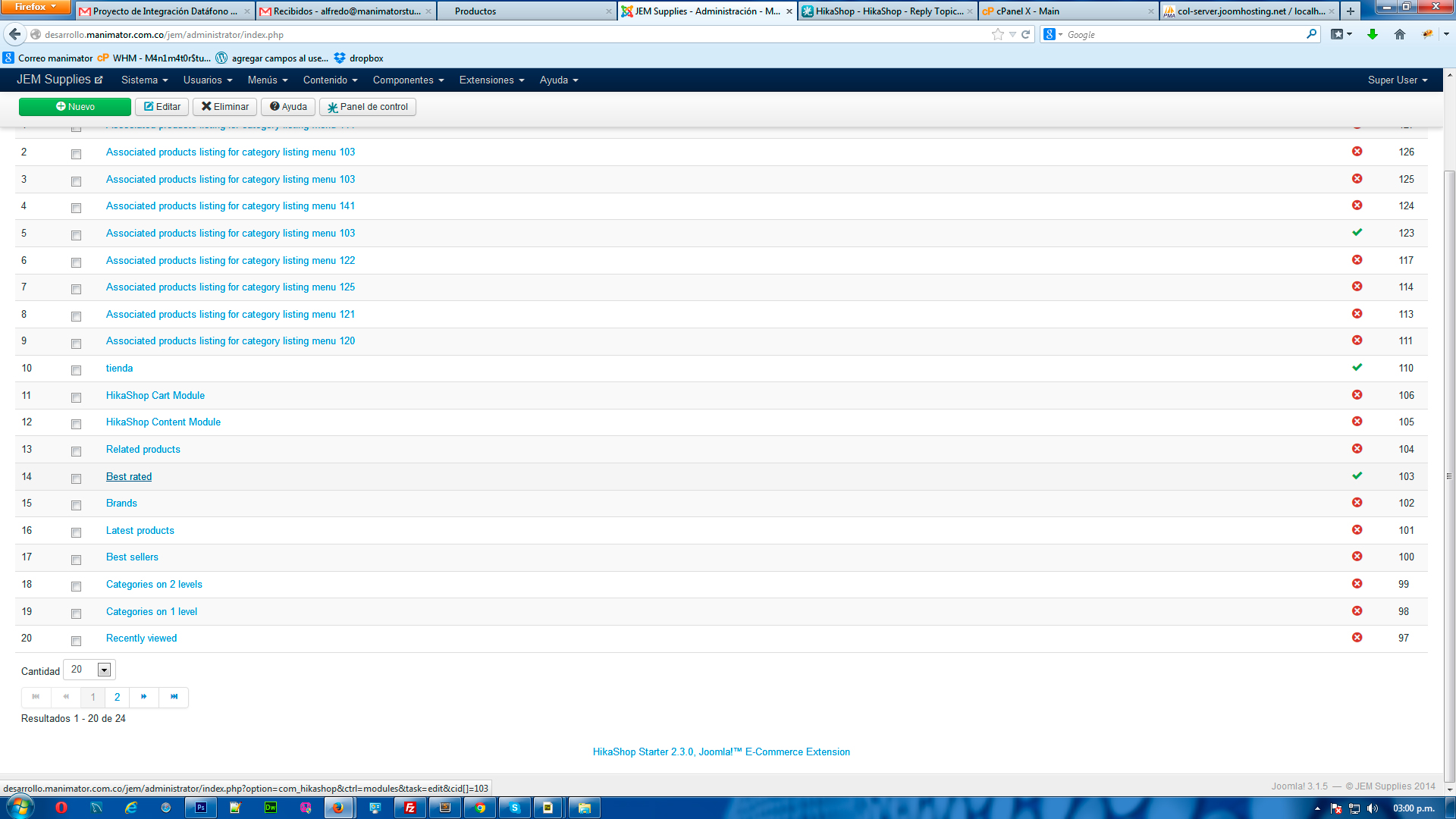

Can you show me screenshots of how did you configured your Hikashop content module which have the ID number 110, and your Hikashop content menu which have the ID number 103 ?
  • Posts: 6
12 years 5 months ago #149887
Hi Mohamed Thelji
here i attach the configuration.

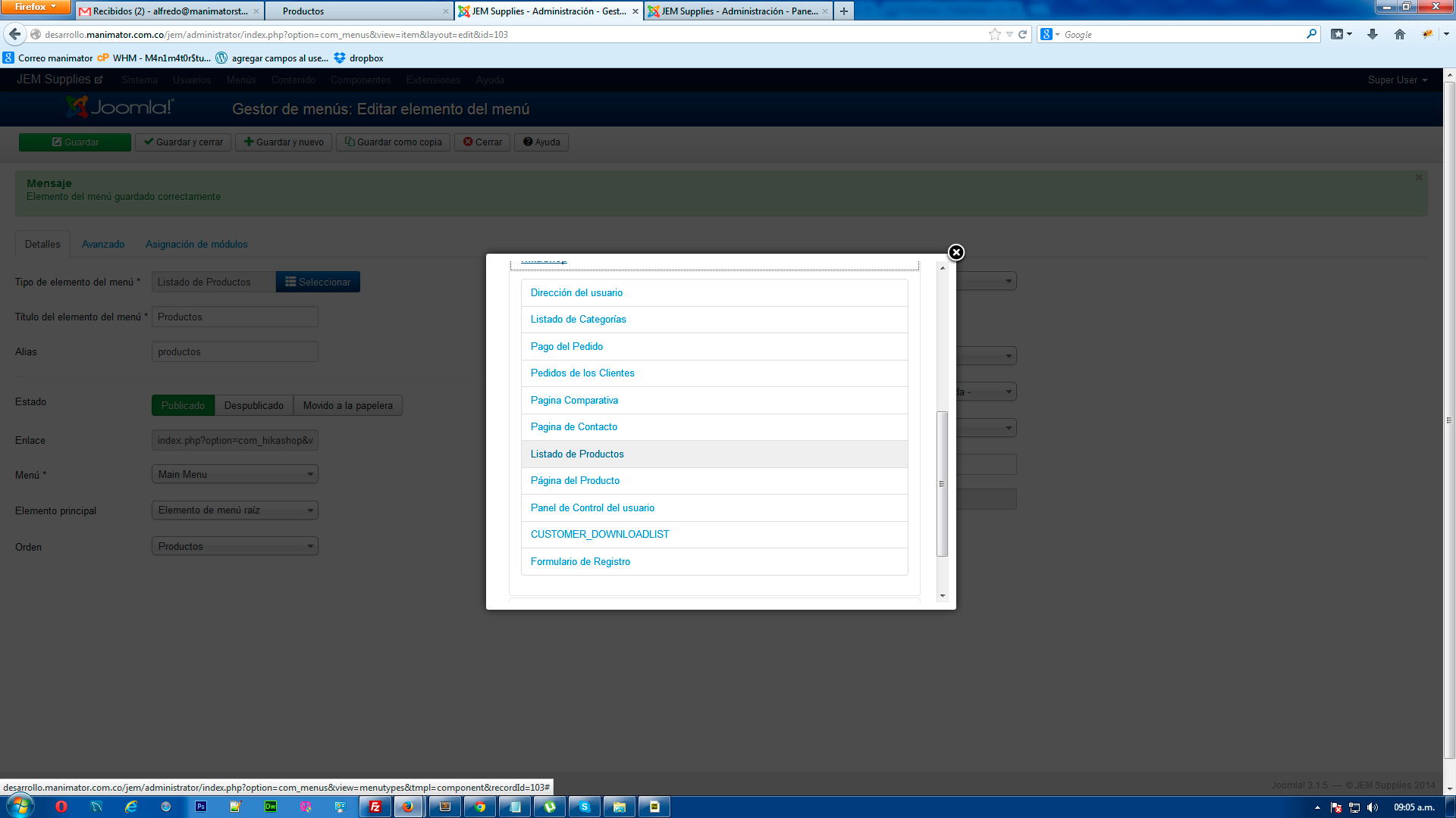

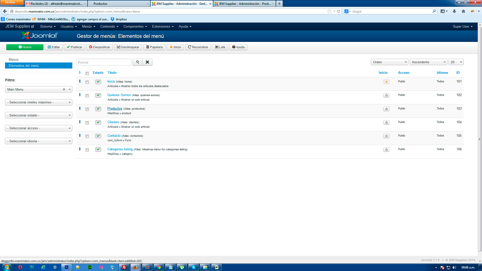

12 years 5 months ago #150019
I wanted to see the Hikashop content menu which have the ID number 103 and not the module.
