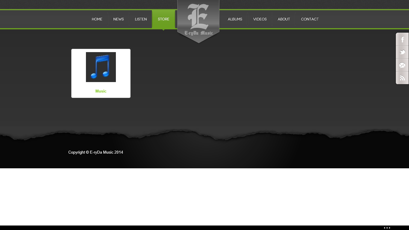

I am running the latest version of HikaShop with the latest version of Joomla 2.5. I have run into an issue. When I go into the HikaShop configuration and go to the Display tab, I scroll down to the Item box background color. The default color is white (#FFFFFF). I try to change it to dark gray (#2F2F2F). After saving, the configuration shows the color change, but the front end doesn't. Am I doing something wrong?

More details will be required about your configuration.
Are you editing the right menu/module ?
Do you have some specific CSS which could affect the background color ?
Do you have some view override ?
Which HikaShop version are you using ?
Do you have a link to your store (and this specific page you put as screenshot).

I have solved my issue. It was within the Content Menus under the Display tab. Is it possible to change the border from white to another color?
