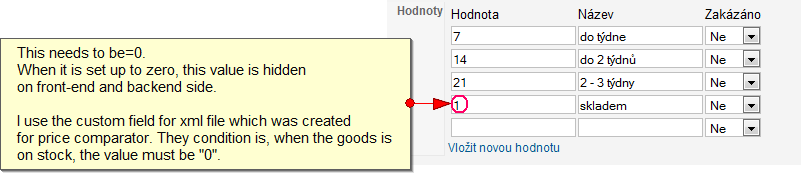

I would like to have possibility to setup in custom fields value="0" and display this field on front-end and also at back-end side of eshop.
For price comparator I need to set up value "0" for availability.
Availability zero means that the goods is on stock.
Could you please, help me to solve this problem?

12 years 3 months ago #151019
I need to have possibility to full fill the value of the custom field which is equal to zero and display this field on back-end and front-end side of eshop.
Now, when the value = 0, the custom field is not display.
See attachement

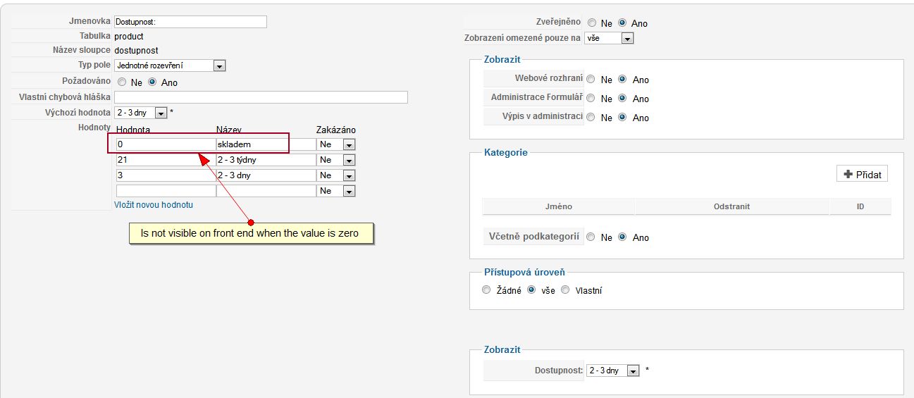

  • Posts: 68
12 years 3 months ago #151295
I realy talk about value. When the value is setup to "0", the title can be anything, than this exact item with value=0 is not visible on the FE even on BE.

12 years 3 months ago #151332
Thanks to edit the view "product / show_block_custom_main" and replace:
if (!empty ($value)) {
By:
if (!empty ($value) || $value == 0) {
The following user(s) said Thank You: kopretina
  • Posts: 68
12 years 3 months ago #151411
Thank you very much. Works perfectly.

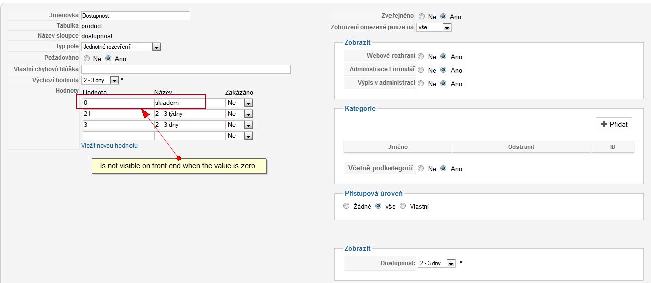

  • Posts: 68
11 years 10 months ago #170613
Hikashop version: Bussines 2.3.2
Configuration of product: in attachement
Link to the page, where si not used custom field with value zero and the item "dostupnost" is display well.
sperky.webhotovo.eu/subdom/sperky/index....ranta-livia-corsetti
Link to page, where is used custom field with value zero and the item "dostupnost" is not display well for variants.
In main produkt you see dostupnost "skladem" and value of this is zero. Then you clik on variants. "černá/L" is display well. Then clik on the first one (bílá/M) and the custom field "dostupnos" is not display.
sperky.webhotovo.eu/subdom/sperky/index....6301-julia-obsessive
The web is for the moment on working domain.

11 years 9 months ago #170717
Please override the view "product | show" (or the file "components/com_hikashop/views/products/tmpl/show.php" and replace
	if(!empty($variant->$fieldName))
		$variant->$fieldName = trim($variant->$fieldName);
	if(!empty($variant->$fieldName)) {
By:
	if(!empty($variant->$fieldName) || $variant->$fieldName === '0') {
It would fix the issue you got.
  • Posts: 68
11 years 9 months ago #170733
Thank you very much for help. This fixed the problem.
