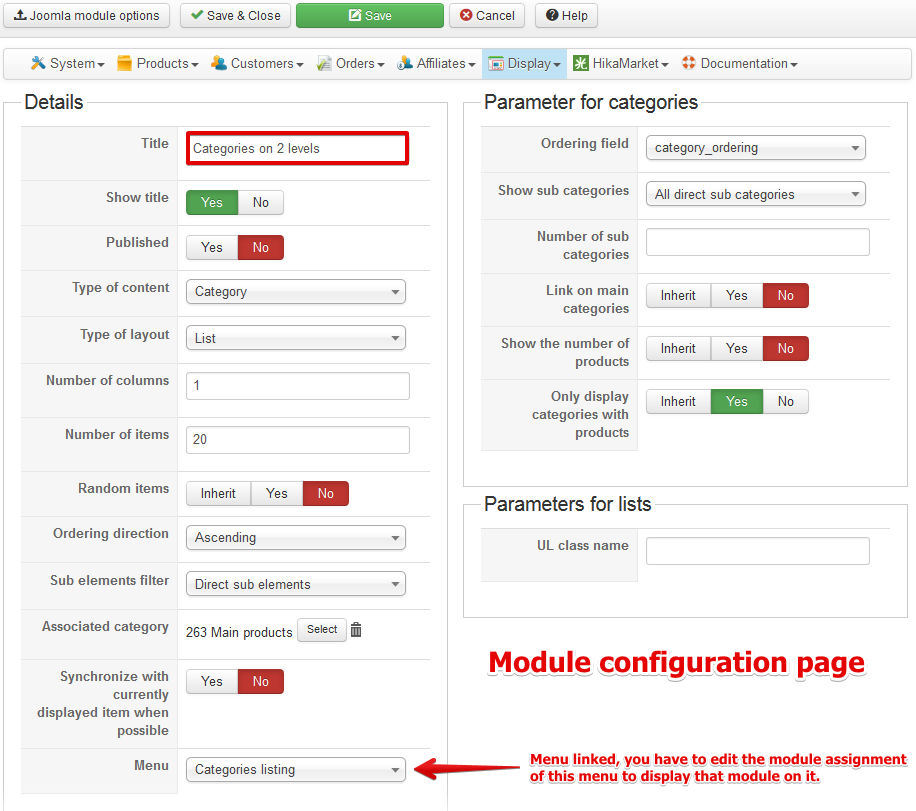

11 years 4 months ago #152452
I will try to explain it clearly, the category listing module is enabled on the menu you gave us.
When you click on a category, it open the menu specified in the category listing module (last option on the left side).
So you have to edit the module assignment on that menu, in order to enable the category listing module.

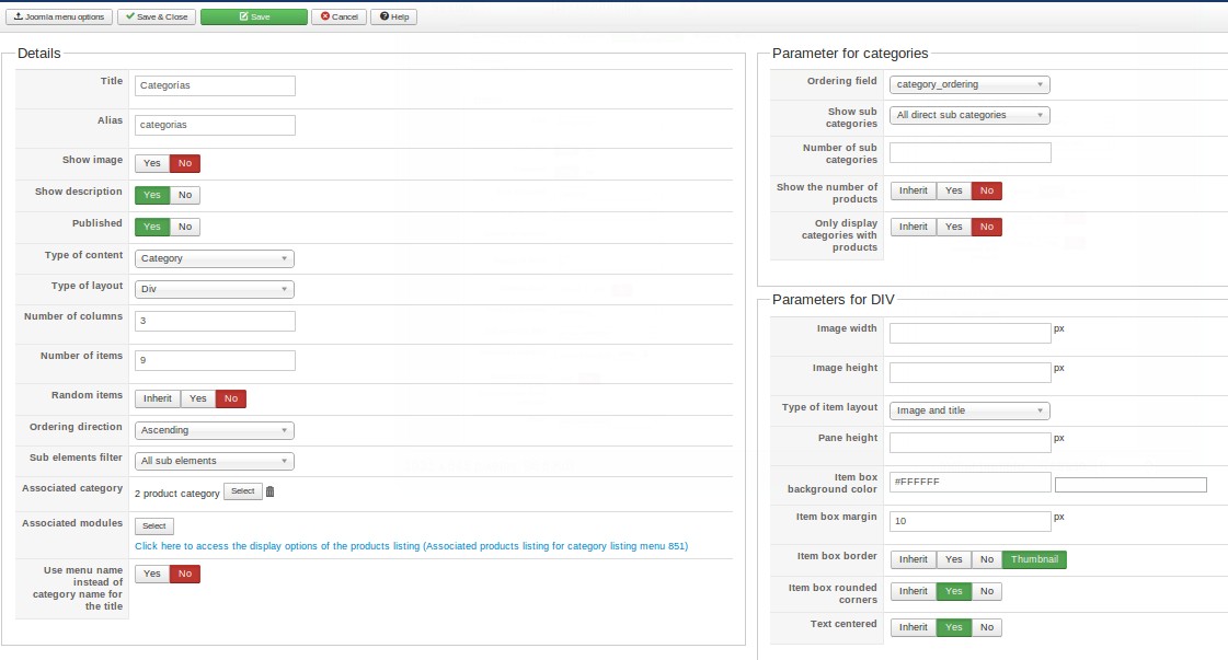

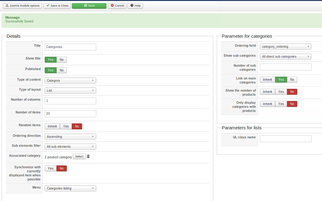

11 years 4 months ago #154016
Here are the screenshots of module and menu settings I have.
Thanks in advance :S

11 years 4 months ago #154033
In your categories listing module's "menu" option you have the "Categories listing" menu item selected, while your second screenshot of your categories listing menu item has the name "Categorias". So you didn't select the menu item you created in your module's "menu" option.
So even though your "Categorias" menu item is properly configured, your module is not using it, and thus you still have the same problem.
