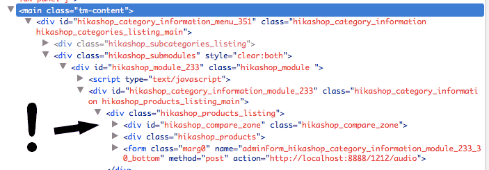

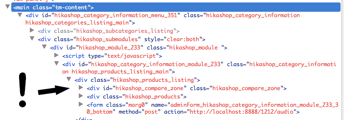

Once loading a main category (= 1st under "product category"), I do get compare buttons/checkboxes:

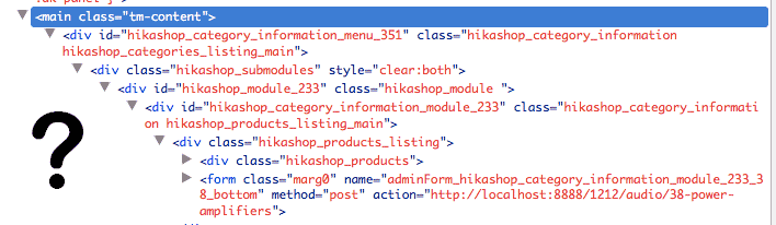

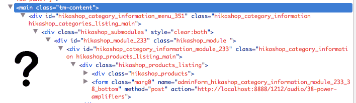

Then, loading a sub category (= 2nd or 3rd level under "product category") from a respective menu, I do not get them anymore:
Is it me? I swear, I have no 'display:none;' anywhere there! ;) And there's no menu- or module-specific setting that I could have messed with, correct?

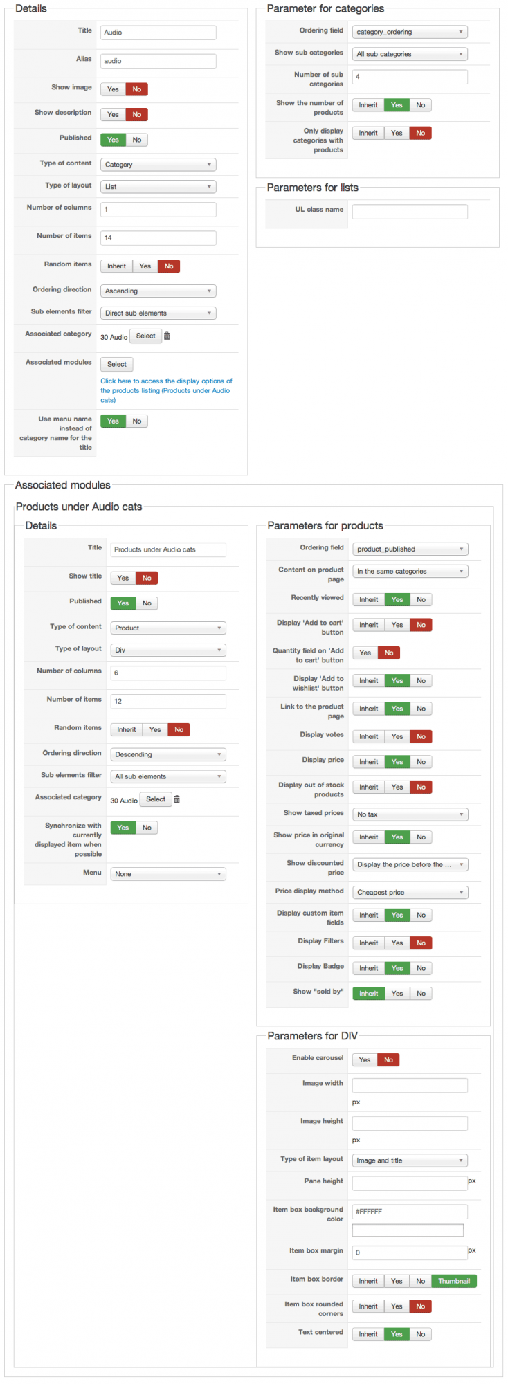

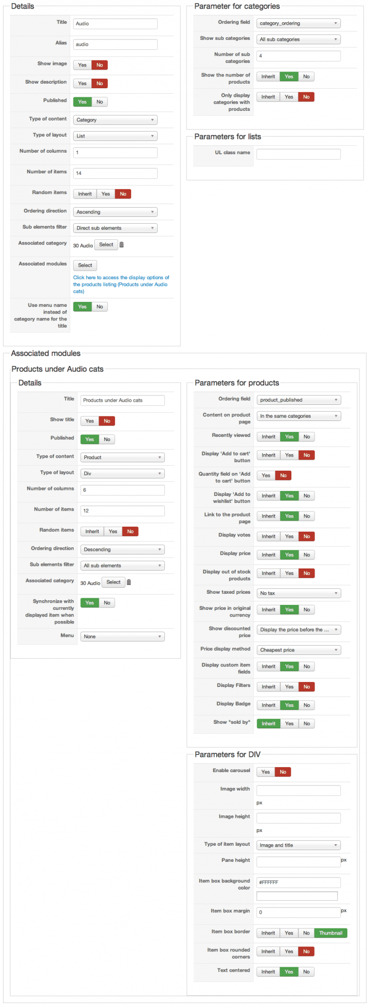

Let me show you the menu/module configs and try to explain:
Under 'product category' I need 3 levels deep of product categories. So, on first level there are 4 what I call 'main categories', then each has a 2nd level of sub-categories, and some of those have then a 3rd level of sub-sub-categories.
Comparing is interesting really only on 2nd and 3rd level; which is where it doesn't work, unfortunately.
Just FYI, there's only one menu calling all products across all main categories (and no comparing wanted/needed), for the rest I'm staying within the main categories, so that a limitation to 2 levels is not a problem, and we here can focus on one of my main categories (named "Audio") - the other 3 are set up identically except for the associated category they're pulling from.
"Audio" has 14 categories under it, and there are up to 4 categories under some of those.
Please see attached a screenshot of the menu settings incl the associated module.
This menu produces correctly
(a) a menu/list of all (sub-)categories on 2 levels under my main category "Audio", and
(b) all products from all (sub-)categories under "Audio",
(c) with Compare
As soon as I click on any of the (sub-)category links, no matter which level, I'm getting
(a) eventually the correct menu/list of sub-categories - provided there are any, and
(b) the correct products in these sub-categories only,
but - incorrectly - no Compare
So, the pattern is: Compare = yes on top category level, Compare = no on lower category levels.
Again, any customization removed, no CSS hiding Compare.
How in the world did I screw this up? :S
