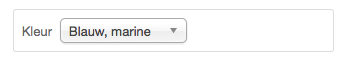

In a shop under construction I gave a product one set of 15 characteristics (fabrics of colors).
In frontend the 15 characteristics appear under the product. Each characteristic in a row, and each with the option to add it to the cart.
In an earlier stage (Hika Essentials), the 15 characteristics appeared in a drawmenu, beside the product-image (see attachment). I prefer this display strongly. But how can I manage this?
  • Posts: 86112
  • Thank you received: 14210
12 years 3 months ago #155500
It means that you changed the "characteristic display method" option of the HikaShop configuration from "dropdown" to "table".
Change it back and you will get back the dropdown.

12 years 3 months ago #155558
Souds pretty logic... ;)
But excuse me, I really can't find that setting. :blush:
  • Posts: 25
12 years 3 months ago #155576
Founded!
Under Main > Article.
Not that logic...
