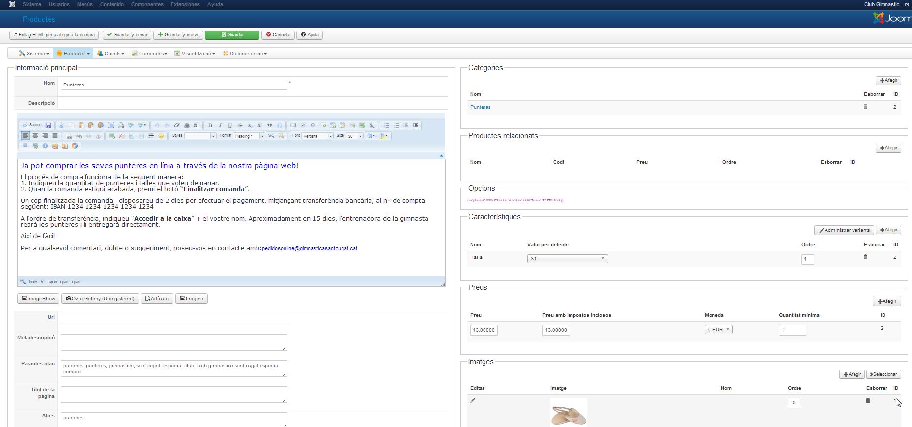

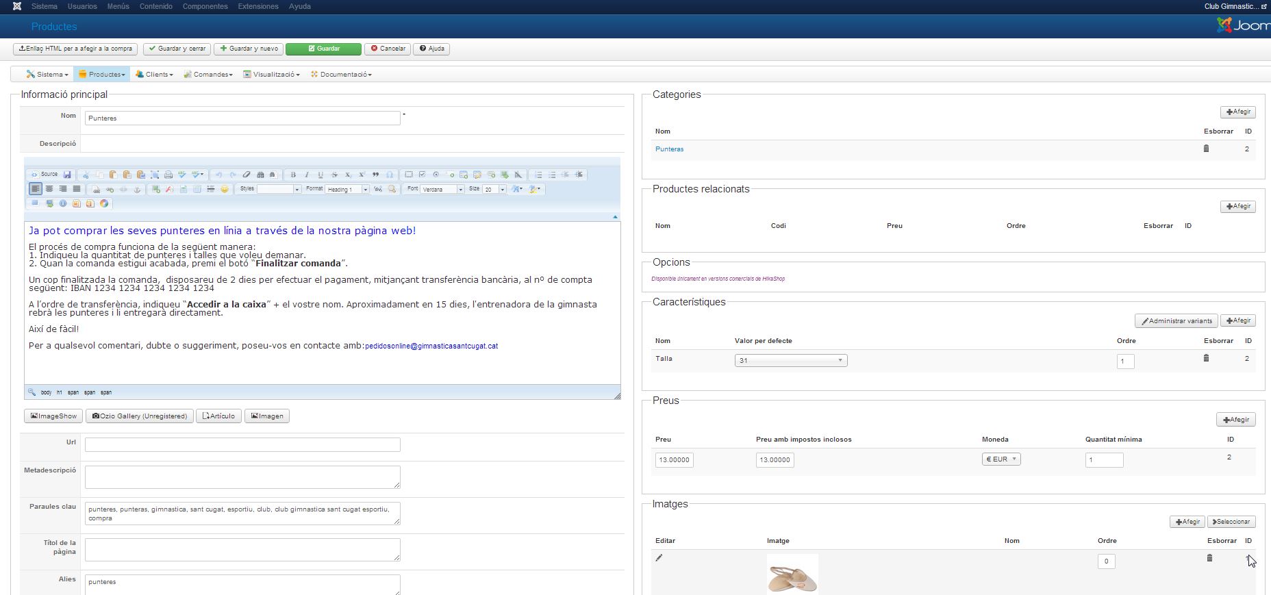

I created a product (shoes) in HikaShop and I associated a picture to this product. Works fine on the frontend. Then I created within this product, a characteristic called 'Size', from 33 to 44 (shoes size) and I display the characteristic as a drop-down list. My problem with this characteristic on the frontend is: When I display the product on the home page (without selecting any characteristic), the picture is displayed correctly, while when I select a shoe size, the picture disappear. What happen here? How can I display the picture of the shoe, even when selecting the characteristic from 33 to 44? Thanks!
12 years 3 months ago #156896
Can you try to create a new product with picture, add a variant directly to it and see if it's working ?
If it's not working, you can still force the image by adding it in the variants, but that should work without this work around.
Thanks to give us a screenshot of your product edition page.
  • Posts: 7
12 years 3 months ago #158031
I created a product (shoes) with a picture, I created several variants (size) and I even associated a picture with each size.
As a result, when I go to the home page of the shopping option in my web site, I can see the picture of the shoe. But this picture disappears when I use the drop-down list to select a show size. Attached a screenshot.
