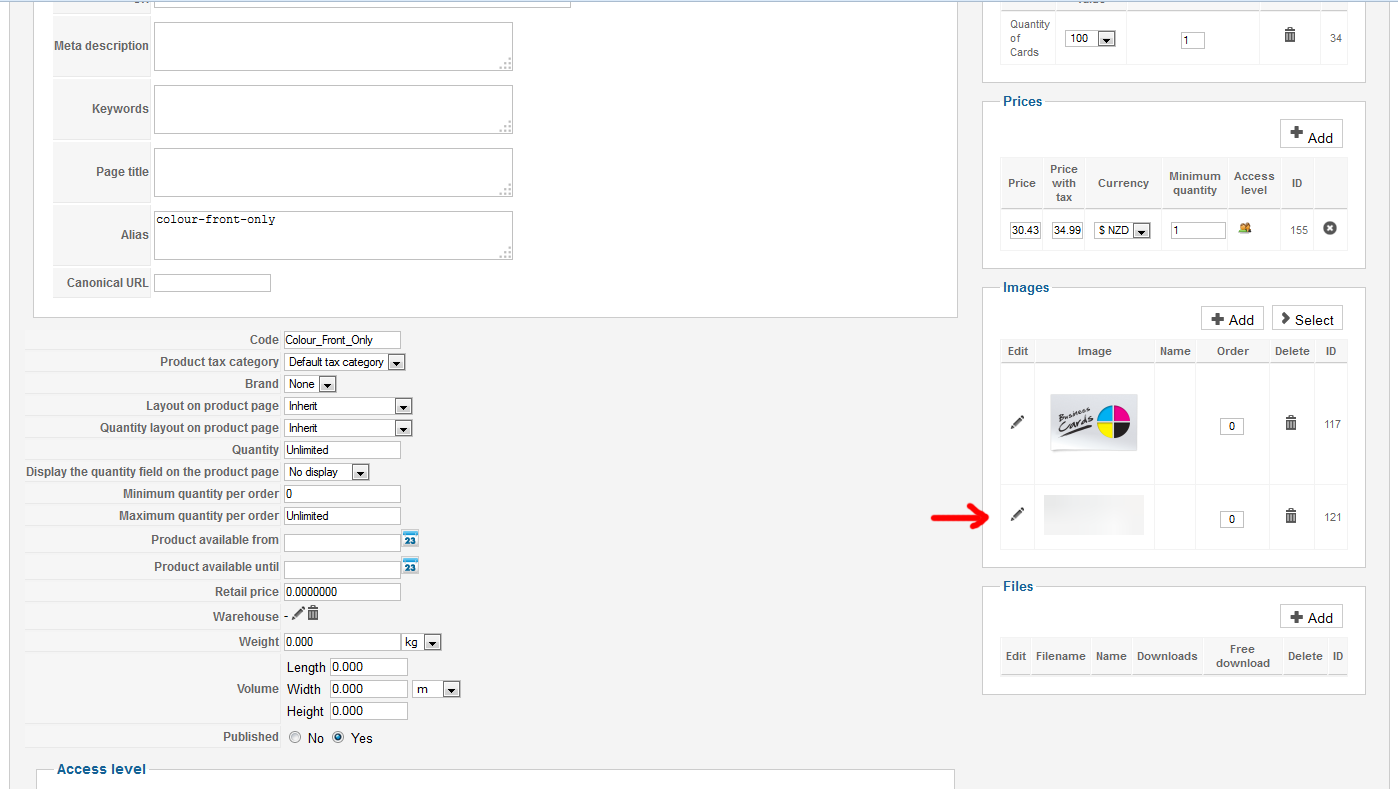

Hello, we are on the latest version of Hikashop. We are currently having trouble uploading images through the backend. We used to just go into the product detail page (backend), and click "Add" and then browse to the file on our local system, this would then upload the image to the correct folder on our website. What is now happening, is that it selects the file, but just shows a grey box instead of the image. We can get around it by going to our ftp and manually uploading the image and then using the "Select" option in the product detail page to select the image. What do you think could be preventing this from working as it should?
NOTE: The image is the same size/type as the previous ones that used to work.

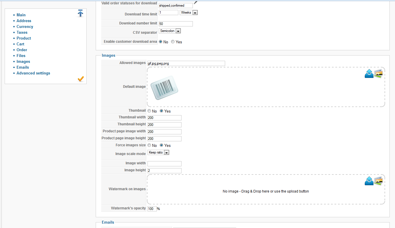

Can you show me through some screenshots, how did you configured the options of the page "Hikashop->System->Configuration->Main".

Hi, attached is a screenshot of the config page. Seems to be ok to me. Also attached is a screenshot of what happens when we try to use the Product Detail page to add an image. (shown with the red arrow). It should be an image preview as per the image above it.

Try to turn off the "force size" option in the configuration and see if that helps.

Hi, turned on debug and nothing shows up. One thing I have just realised though, is that the preview seems to be a part of the actual image, enlarged really big and cropped, almost like a couple of pixels have been selected out of the middle of the image I am trying to upload. Wierd.
For the example, I used the exact same image that is displayed above it on my screenshot, you can actually see from that that it has taken the grey from that image and enlarged it really big to create the preview.
