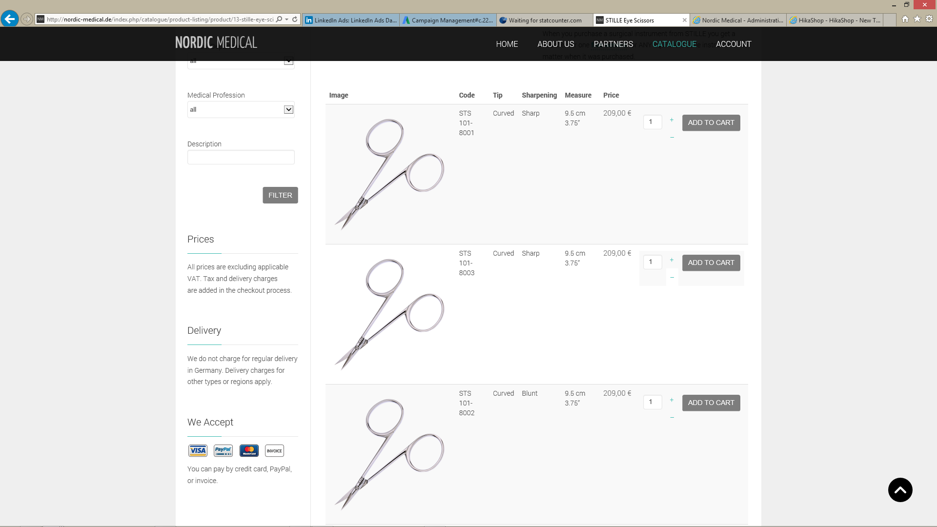

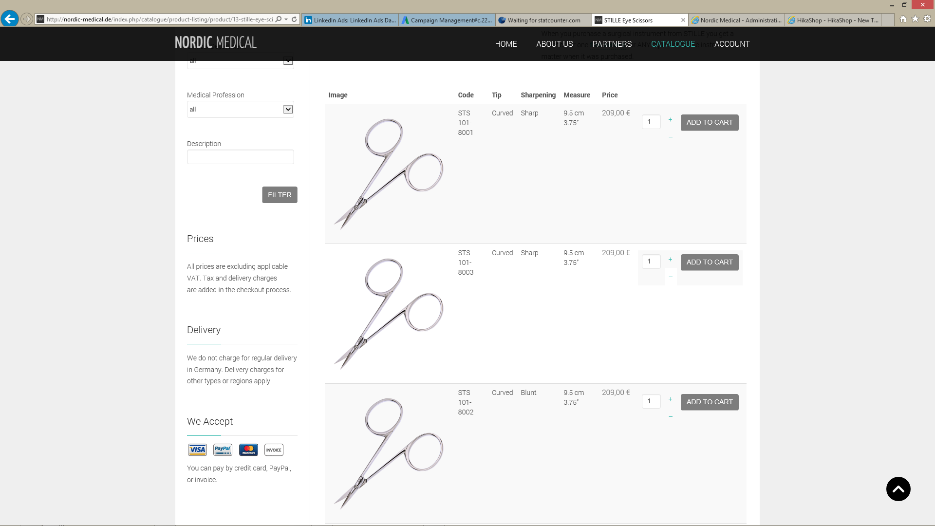

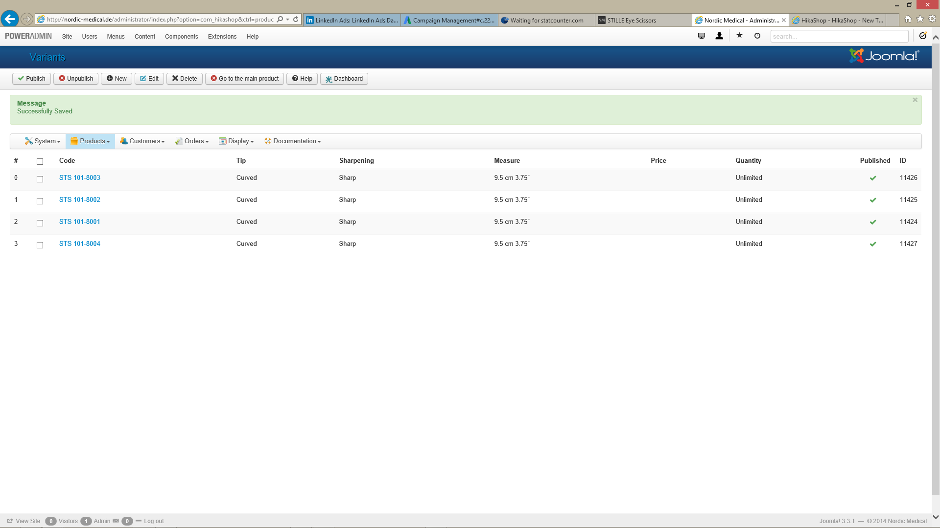

I've created a product wtih different characteristics (e.g. nordic-medical.de/index.php/catalogue/pr...-stille-eye-scissors ) and everything looks as it should. If I then go back to the product and make modification to e.g. the description or FaLang translation and click save ... the characteristics get all messed up or are reset to a default value. There's even a disconnect between characteristics specified on the front end and the characteristics specified in the back end.

I guess that the issue is that the product code of the variants got changed and thus when the system tries to managed the variants when you save the product, it tries to recreate them and mess them up.
An easy way to circumvent the problem is to turn off the "Generate variants automatically" option of the configuration. That way, the variants won't be generated or regenerated automatically and that will avoid that kind of problem.
And since you edit each variant to change the product code (and potentially other info) anyway you won't loose time creating them manually when needed with the "new" button of the variants listing.

With the option turned off, the system shouldn't alter the variants at all so I don't see how that's possible that you get that result.
I guess we'll need that you provide a backend and FTP access via our contact form in order to analyze the problem as we can't reproduce it. Please also include a link to this thread.

I was not able to log on your FTP server but I think I found the problem.
change the code:
$results = $this->database->loadObjectList();
					if(!empty($results)){
						foreach($results as $variant){
							foreach($element->characteristics as $char){
								$char_ids = array();
								foreach($char->values as $k => $val){
									$char_ids[]=$k;
								if(!in_array($variant->variant_characteristic_id,$char_ids)){
									$this->database->setQuery('INSERT IGNORE INTO '.hikashop_table('variant').' (variant_characteristic_id,variant_product_id,ordering) VALUES ('.$char->default_id.','.$variant->variant_product_id.',0);');
									$this->database->query();
to:
$links = $this->database->loadObjectList();
						//for each variant, and for ech characteristic, if the link is missing between both, add one between the variant and the default value of the characteristic
							foreach($links as $link){
								if($link->variant_product_id==$results->product_id){
										$found = false;
											if($k==$link->variant_characteristic_id){
												$found = true;
										if(!$found){
											$this->database->setQuery('INSERT IGNORE INTO '.hikashop_table('variant').' (variant_characteristic_id,variant_product_id,ordering) VALUES ('.$char->default_id.','.$link->variant_product_id.',0);');
in the file administrator/components/com_hikashop/classes/product.php and that should fix the problem.
