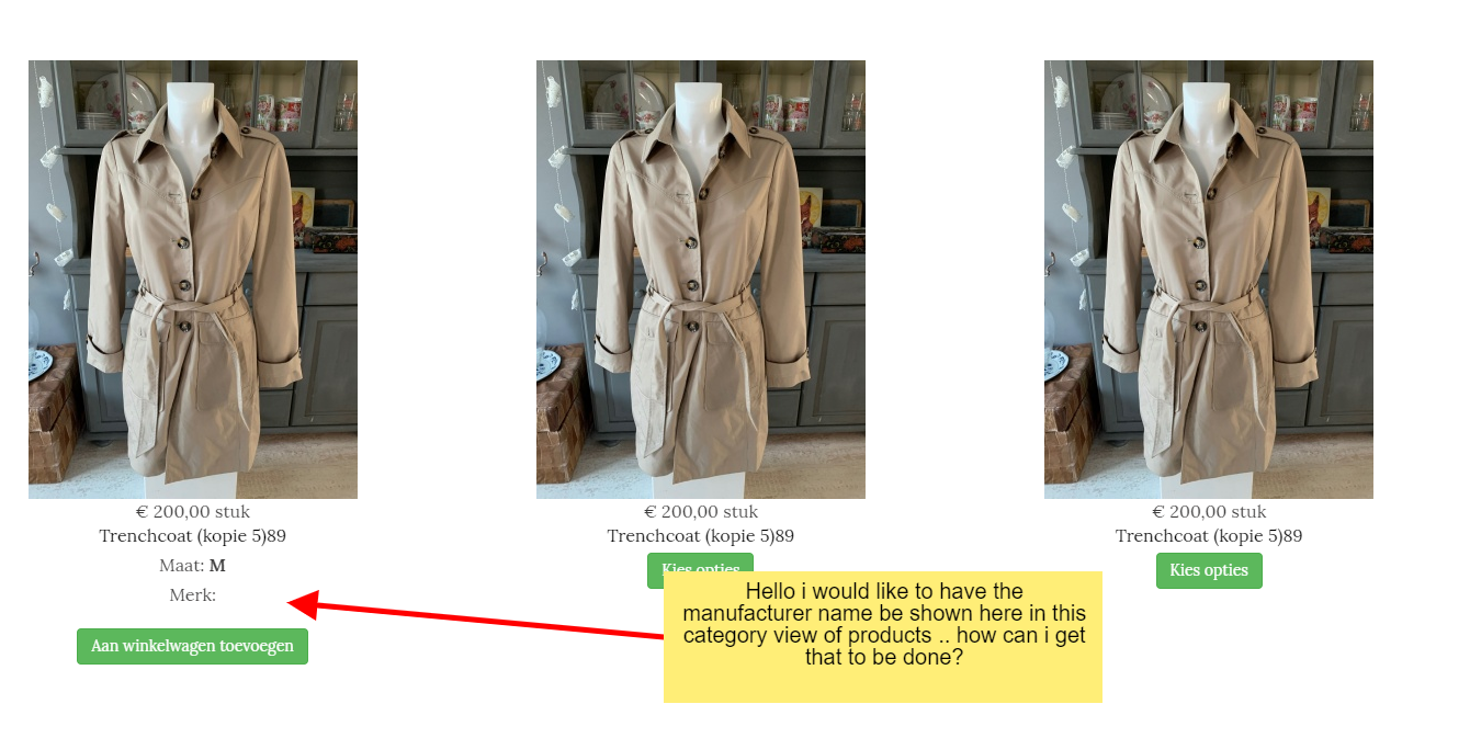

  • Posts: 424
  • Thank you received: 11
6 years 10 months ago #312714
I don;t want the brand image to be displayed but want the brandname to be displayed in the product category view..
I places this code: <?php echo JText::_('MANUFACTURER').': '.'<a href="'.hikashop_completeLink('category&task=listing&cid='.$manufacturer->category_id.'&name='.$manufacturer->alias.'&Itemid='.$Itemid).'">'.$manufacturer->category_name.'</a>'; ?>
into the product/listing_img_title and only get this:
Merk:
After this the manufacturer category attached to this product is missing..
how can i get this here??
Please also see attachement.
  • Posts: 86095
  • Thank you received: 14199
6 years 10 months ago #312715
You first need to load the manufacturer/brand data from the database.
So you first need the code:
	$class = hikashop_get('class.category');
	$manufacturer = $class->get($this->row->product_manufacturer_id, true);
