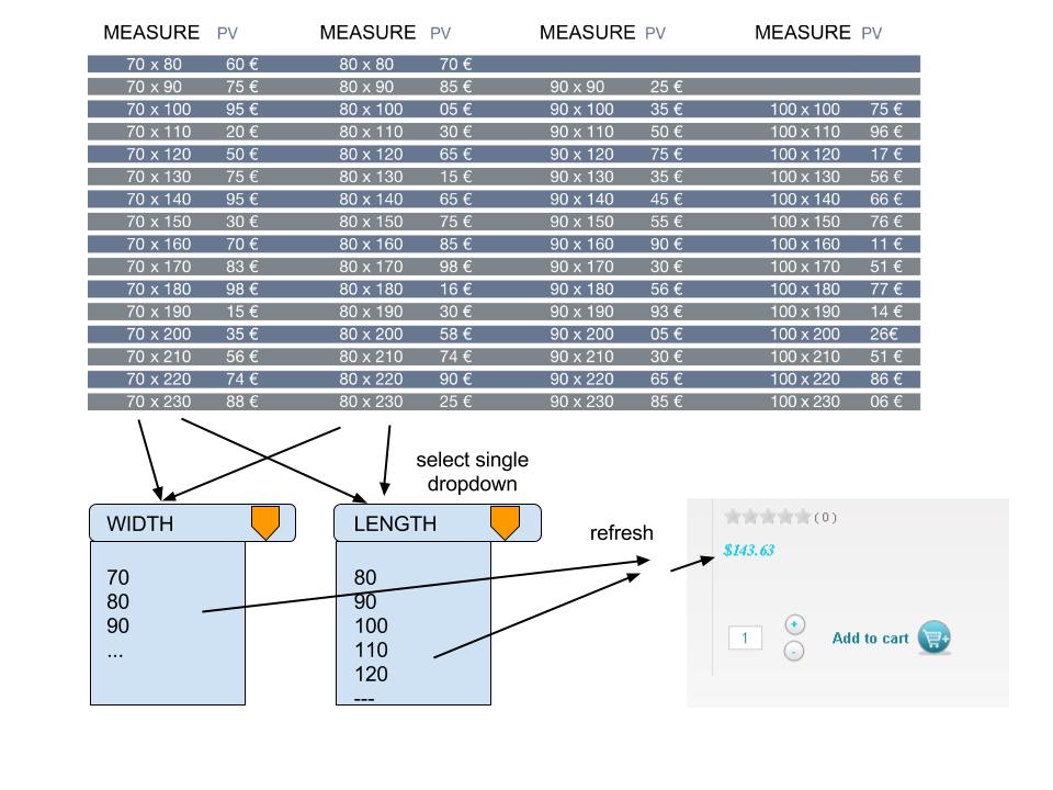

I'm working on a new store where products are price according to the length and width.
One option would be to use variants, but the width and length combinations are many and the list is very long
I think the best solution would be two fields single dropdown, width and length, and once selected that will select a price. In this case, I tested width 2 custom fields table item single dropdown frontend ok, but i don’t what it is the next step to modify product price. I am installed HikaShopCustom Quantity plugin https://hikashop.com/forum/content-creation/866537-diff-prices-of-several-height-width-combinations.html but when I select dropdown value, price not working.
do not know if this is the best solution or should try other options
Attached a image with a sample table with width, length and price

As long as the plugin is installed and enabled, and that your custom item fields are called as explained on that other thread, the system will calculate the price of the product in the cart like that:
price in the cart = price of the product * width * length
So I don't think that it will be a solution either in your case since the price increase doesn't seem to be linear with the width*length.
Options allows you to set a price for each value of each dropdown so that the selected ones add up with the price of the product.
But in your case the price increase is not independent for each dropdown. So I don't think it will work to reproduce this price matrix.
The only option I see here is to use two characteristics and enter the price for each combination.
