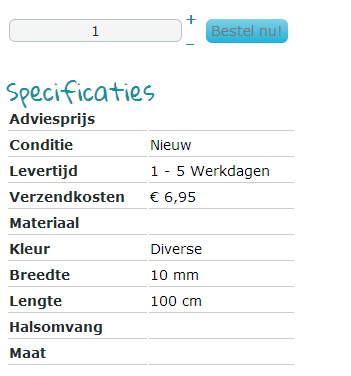

Hi there!
I'm having trouble with a webshop:
The product view shows specifications such as condition, shipping cost etcetera.
The fields that I leave blank also appear in the product view.
Another webshop i created (my own) doesnt show these fields when left blank.
The only difference is that the other shop is on joomla 2.5.X and this one is on joomla 3
Anyone know where to edit this?
