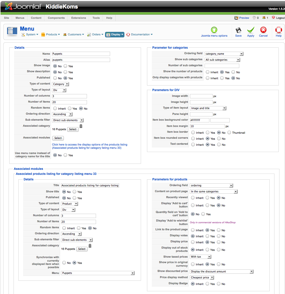

  • Posts: 3
11 years 10 months ago #167362
I published the product category "Puppets" and turned off SEF but the problem still exists.
Screenshot attached of menu configuration.

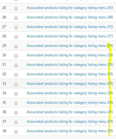

11 years 10 months ago #168130
Okay, I'm doing the 'Associated...." as well. But I notice that Assosiated... 276 and 277 appears many times. Is this okay?

1. Yes. Probably many of them are not used any more.
When you go in your categories listing menu and look at the enabled modules in the select popup of the associated modules option, you will know the one used (with the id). The others can probably be deleted. But you can also leave them there.

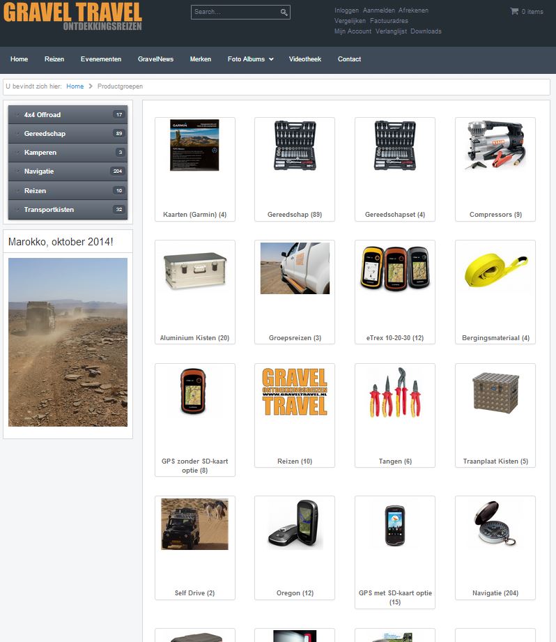

11 years 10 months ago #168333
I delete all the Associated Modules, and re-generated them thru DIsplay/Menu. I changed all the Display Modules to Categories, and set the Skyline menu to 278 (the new Associated Module for Product Categories). All works fine now.
The breadcrumbs still have the Categories. I couldn't find the 'simplefied' option anywhere. But I'll leave it for now. The Categories (Productgroepen) in breadcrumbs are quite nice, really. I have setup the Categorie Listing which is rather nice. See below/attachment.
Kind regards, Eric
