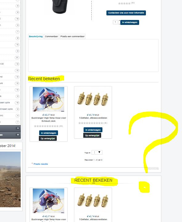

Modules such as Recently Viewed and Newly Added Products are displayed twice, or not at all. How to switch on/off modules on individual pages without displaying them twice?
Kind regards, Eric

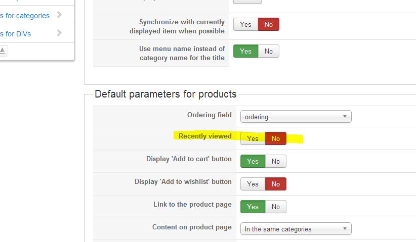

I now turned off the Joom Module for RECENT BEKEKEN, and the module on the bottom of the page has disappeared.. But the RECENT BEKEKEN module, part of the product, is still there. But as you can see the Recently Viewed of HikaSHop's configuration was turned off. I'm puzzeled!
So, while both the Joomla Module and HikaShop Product property are switched off the Recently Viewed module still appears. How is that possible?
Cheers, Eric

That's because you have the module enabled in the "modules under the product page" option of the HikaShop configuration.
You just need to understand the logic in the system. A module instance enabled in the Joomla modules manager means that it will be displayed by the template in the position where you set the module regardless of whether it is enabled or not in HikaShop options. Likewise, in HikaShop "associated modules"/"modules under the product page" options of the configuration/content menus will allow you to display the modules in specific areas of HikaShop regardless of whether the module is enabled/disabled for the positions of the template.
