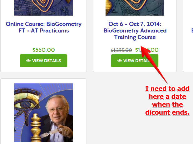

I want to display a custom field in the product listing page but it should not be visible on the product page.
Please see attached screenshot.
Could you please tell me how can I do that?
11 years 10 months ago #168804
You'll probably find your answer through that thread : hikashop.com/forum/install-update/869869...product-listing.html
You'll just have to create a product custom field and un-publish it for the front-end, and then use the code :
<?php echo $this->row->CUSTOMFILED_NAME; ?>
Through the "listing_img_title" file of the "product" view of your front-end template.
