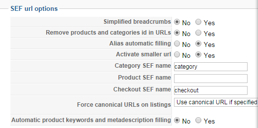

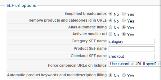

I already choose "use canonical url if speciied" ,while I don't know how to see this function works well
Because I cann't see canonical code in my products page source codes.

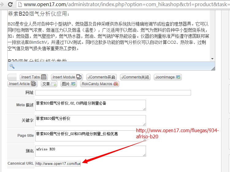

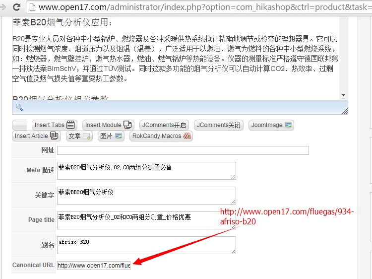

Yes I choose the option "use canonical url if specified".
And I specified it for each product in the product edition page,please see the attached picture
Let's take www.open17.com/fluegas/934-afriso-b20 as an example
In this product detailed page,No cononical code found.

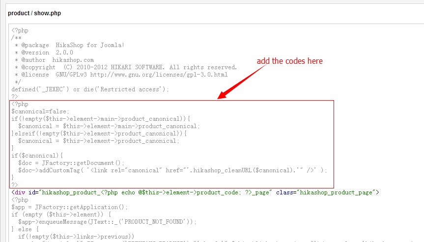

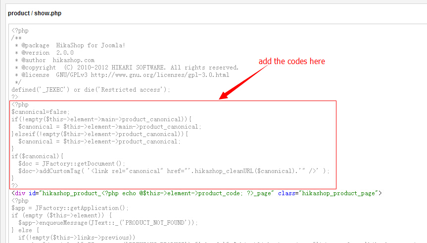

I add the codes you provide to product/show,
Is the position right?
Now I can see "cononical" in page source code.

That's why you didn't saw the canonical URLs on your pages ! You are using a view override from HikaShop 2.0.0 (see the version tag at the beginning of the file) where the canonical URL function did exist.
Yes, that's the correct place.
