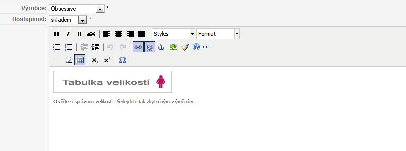

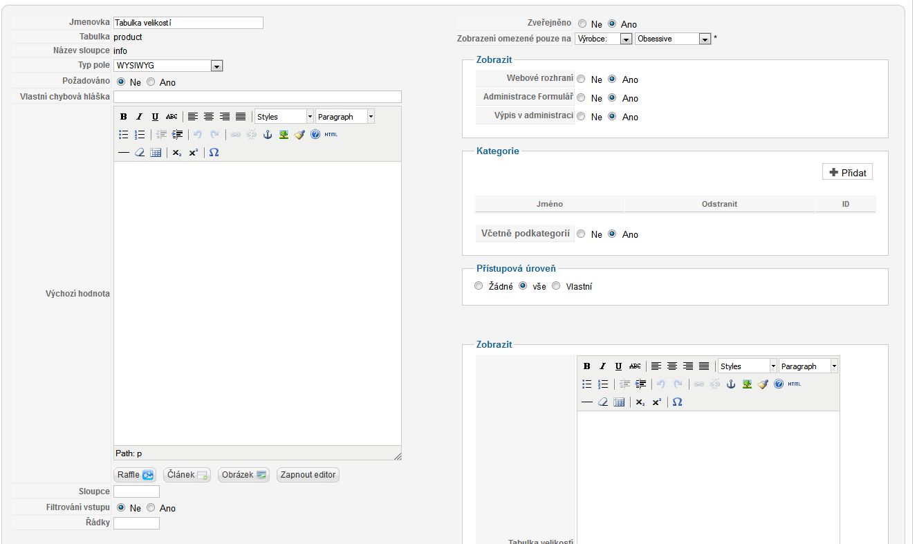

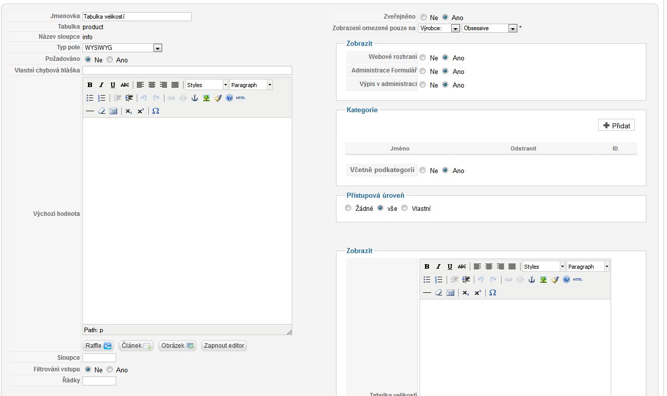

I would like to set up default value for product custom field. These will be limited on the bases of other custom value.
I wanted to use as field type wysiwyg editor, text area or owen text to be able to display the value on frontend and put there some HTML code (picures, link ect.).
I want to setup up default value which include HTML, but the value is not saved. Only text without HTML is possible to save.
When I keep the default value empty and fill in the field when the product is editing, is possilbe to save it. It will take many times to fill in all again and again for each product, I wanted to use default value, which will be valid for group of products.

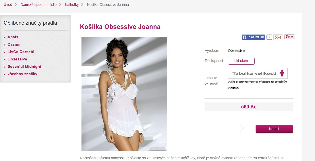

See, how the field is setup in attachement and also you can see the page, where it is used, but must be put directly to product page and not as default value of custom field.
I tried to change editor but nothing is changed, even I use codeMiror editor.
Debug mode is turned on and sytems errors too. I see the mistakes only in the file with language.
Could you help me to fix the problem?

To correct that, you can change the file administrator/components/com_hikashop/classes/field.php with the one in the archive enclosed.
  • Posts: 68
11 years 11 months ago #171286
when the value is not saved as default and input filtering doesn´t work, nothing will be saved. When I create new product the specific field stay empty. It is reason, why I wanted to change. Even more, in the case there is more people who work with administration, can not see what is fill in.
I replaced the file which you mentioned.
Now default value is saved.

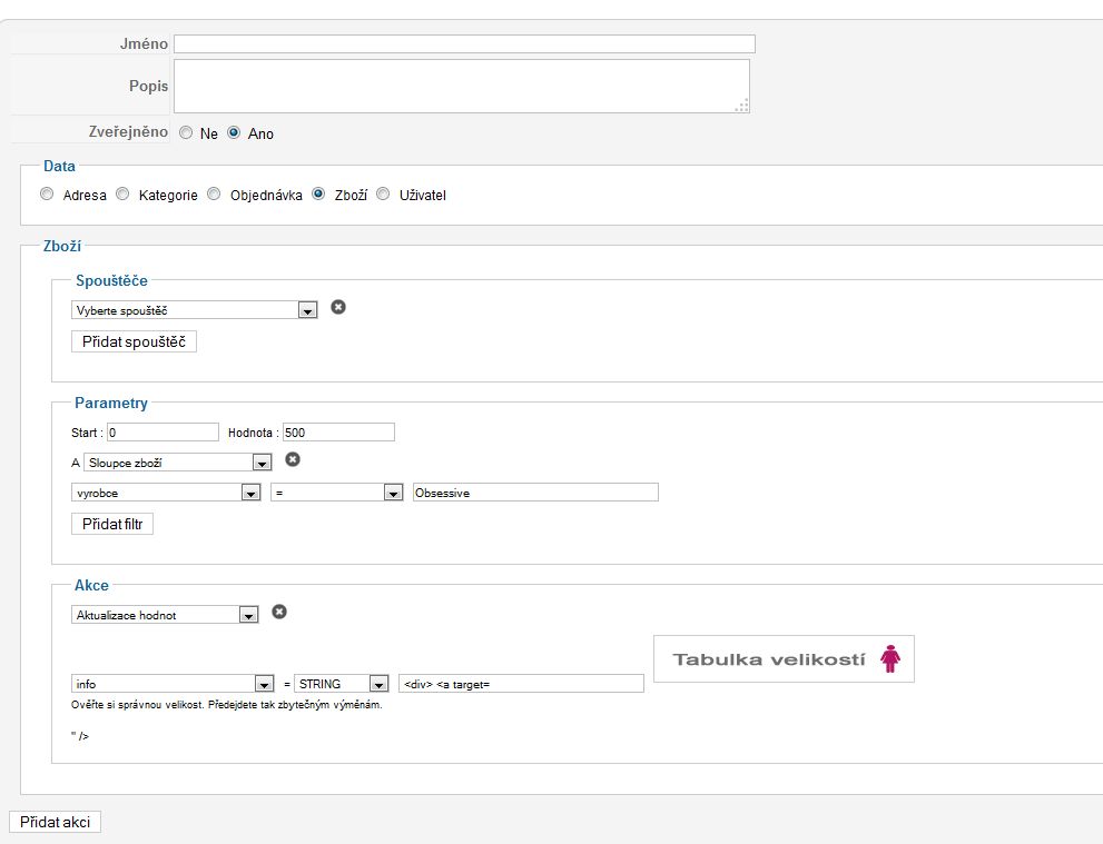

What doesn´t work well is default value for existing products.
I did it trough mass action. But when I use "string" the HTML tag is not saved correctly. Only text.
There is problem to save it.
I managed once, but only if the data are saved and the procedure is not run manualy. Only create new mass action and saved. Not run manualy. Then you have to create one new product, and the data are full fill to product page with conditions used for specific field.
Is there something what I do wrongly?

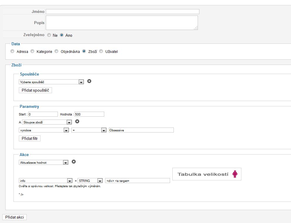

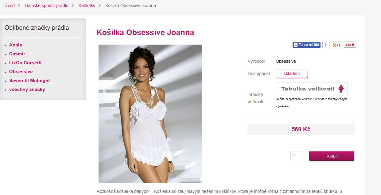

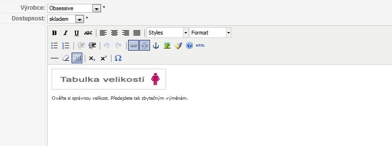

see the setup of mass action which I used at attachement.
The code which I wanted to use is here:
<div>
<a target="_blank" href="/subdom/sperky/images/obsessive.jpg">
<img border="0" alt="velikosti obsessive" src="/subdom/sperky/images/velikosti.png">
</a>
<p style="font-size: 9px;">Ověřte si správnou velikost. Předejdete tak zbytečným výměnám.</p>
</div>
The code include links to picture and link to side which should be opened after you click on picture, and also some additional text.
I dont´t know where I do mistake, but for me it is not working.

Change the line :
$output .= ' <input class="inputbox" type="text" name="action['.$table->table.']['.$key.'][updateValues][value]" size="50" value="'. $value->data['value'].'"  />';
to:
$output .= ' <input class="inputbox" type="text" name="action['.$table->table.']['.$key.'][updateValues][value]" size="50" value="'. htmlspecialchars($value->data['value'], ENT_COMPAT, 'UTF-8').'"  />';
in the file plugins/system/hikashopmassaction/hikashopmassaction.php and that should avoid the problem with complex HTML in the input field.
