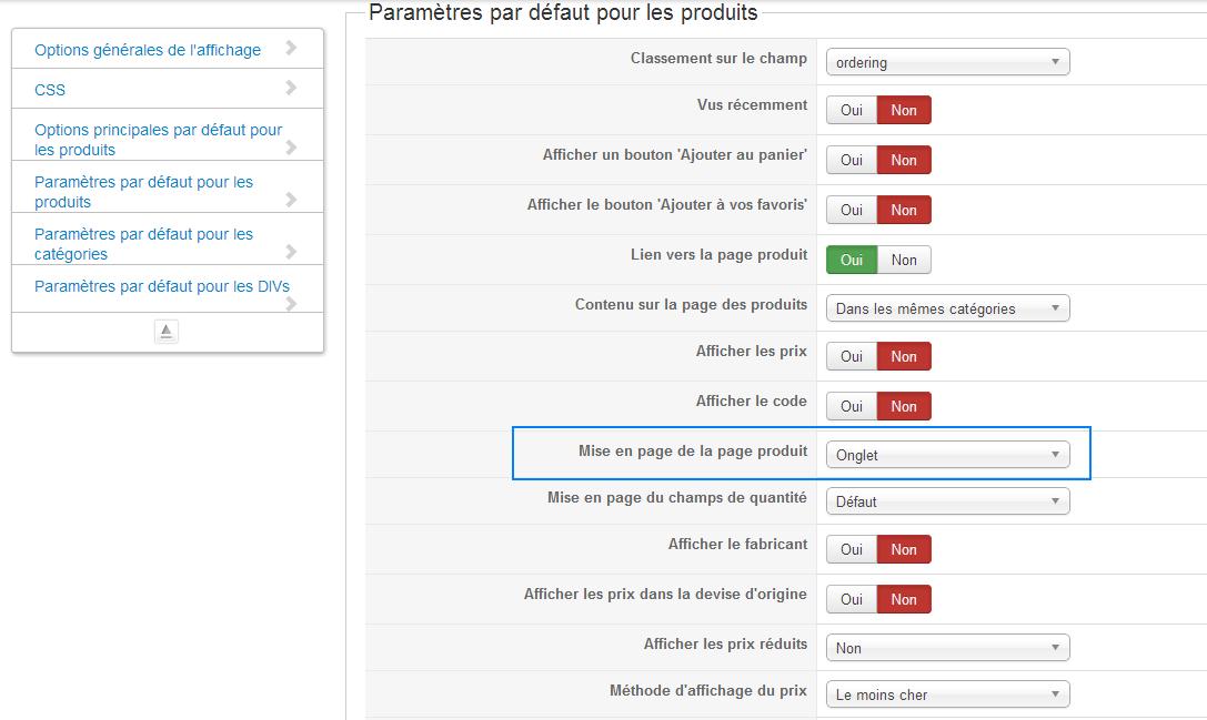

11 years 6 months ago #177643
You'll find here a screenshot of my configuration.
Cheers !

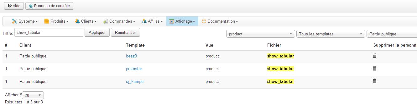

  • Posts: 47
11 years 6 months ago #177825
In fact I have only 3 views for show_tabular and I adapt the code in the 3 views with no effect :-(.
I really don't understand why I have the problem.
Cheers

In each product/category and in the HikaShop configuration, you'll find an option "layout on product page" which define whether the show_default or the show_tabular view file will be used. If you want to have tabs generated and use the show_tabular view, then you need to select the "tabular" option in these options.

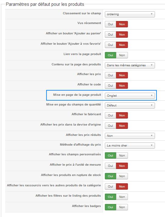

Can you send me a screenshot where I can find this parameter ?
I don't see it (I'm working with the french version).
Here is the configuration I think I need to have (but I don't see show_default or show_tabular).
Thanks !
  • Posts: 85585
  • Thank you received: 14008
11 years 6 months ago #178044
It's that option yes. And onglet means tabular in english, so you have it configured like you want.
Now, as I said, you will find that option in each category and product and you want to check that option there too.
The following user(s) said Thank You: nijan
