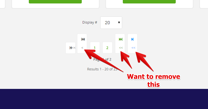

11 years 11 months ago #172674
Please see screenshot. I'm using icon fonts all over the website and I want to remove the html characters.
thanks!

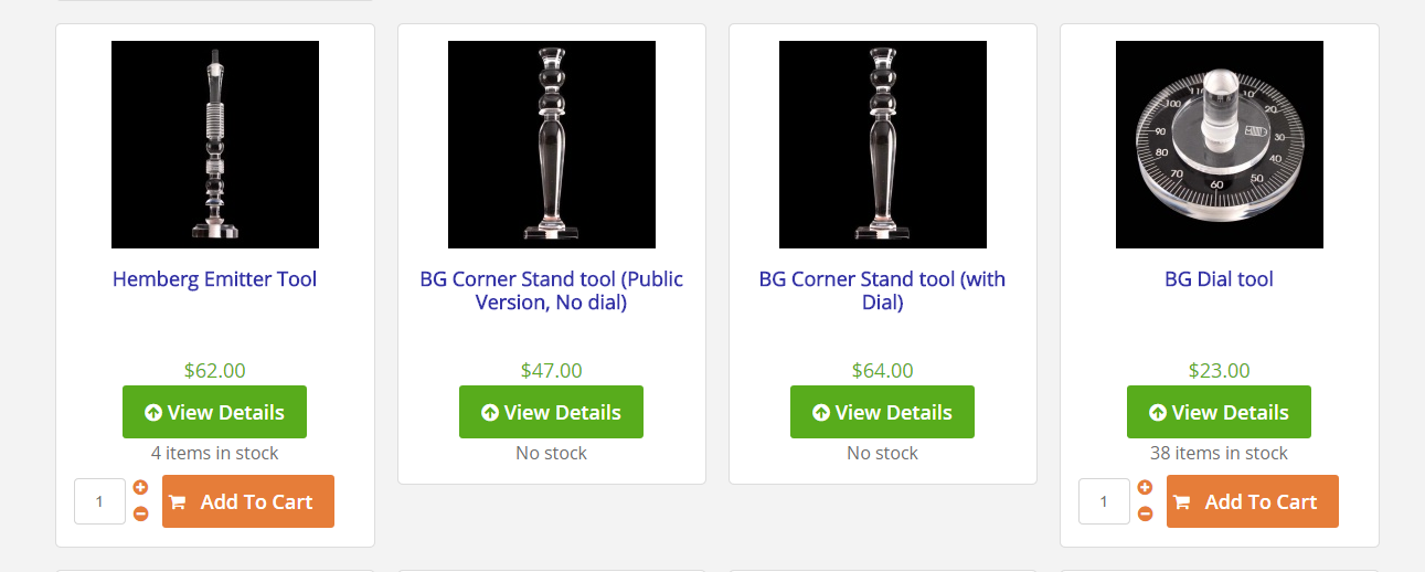

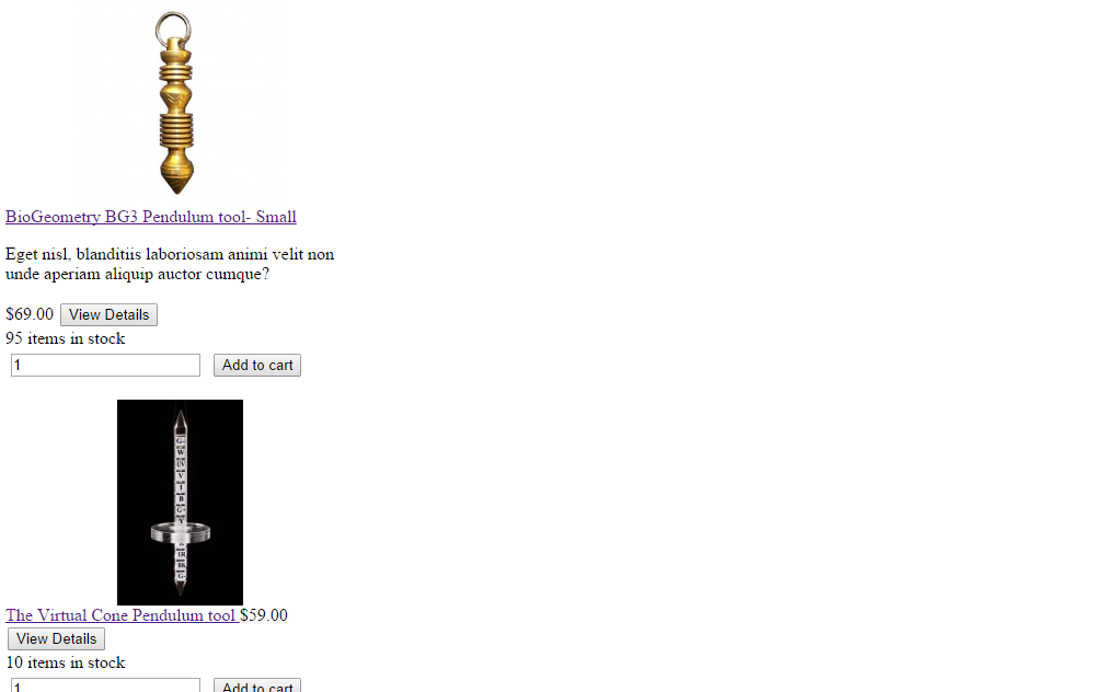

What you're telling me is that I have to do a normal Joomla template override and I should copy the pagination.php from com_hikashop/administrator/helpers to templates/MY_TEMPLATE/html/pagination.php ? If yes, I already did that before starting this tread and unfortunately it breaks the hikashop layout. On screen1 is the layout as it should be and on screen2 is the layout after pagination override.
thanks!
