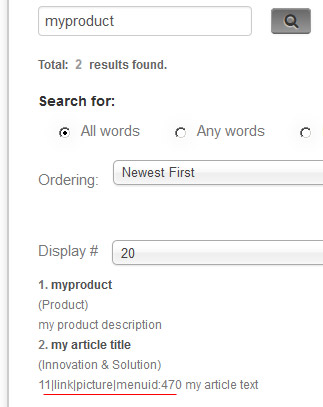

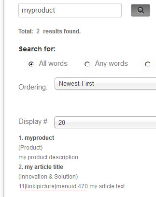

Hi, I'm sorry but probably I didn't explained well this issue:
your patch hides the product description on the products records that comes as results of the search,
but the problem isn't on the product records, but in articles records that contains the code.
When the search lists one of these articles it doesn't parses (or hide) the plugin, but let the user view the raw ugly code.
I've attached a screenshot of the typical result when the search find both the product and also an article that contains the product code.
