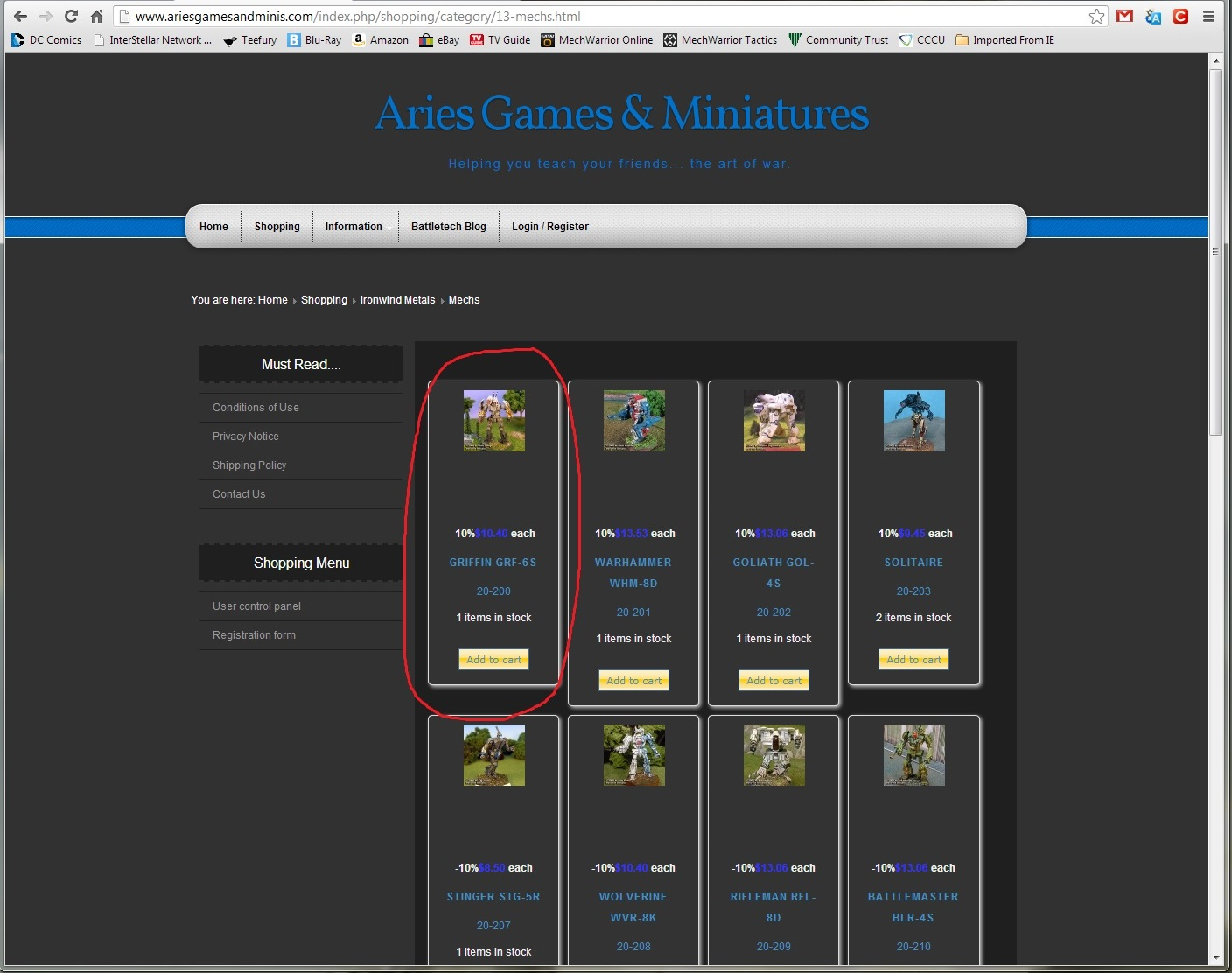

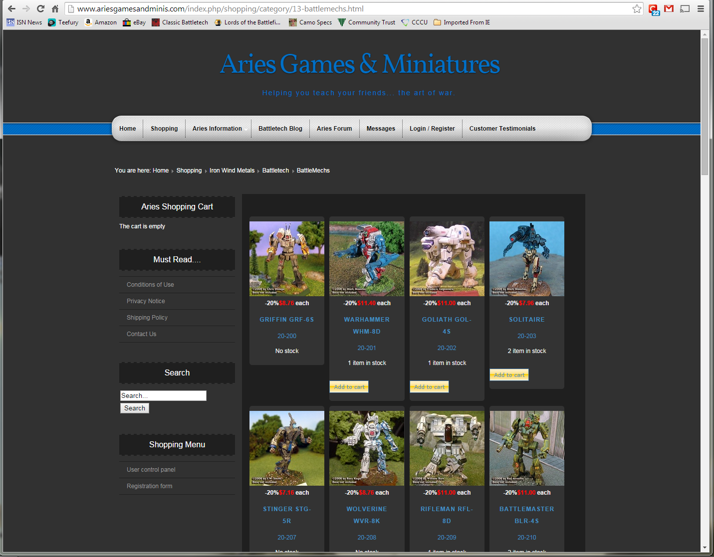

Ever since updating from 2.3.2 HikaShop Starter in to 2.3.3 Hikashop Essentials...I've noticed that the products I have listed on my site do not have borders around them. The categories still do, but not the products. As I could swear they used to, I went looking for the feature to update it...and I cannot find it. So I thought maybe I was crazy so I tracked down an old problem I had...and sure enough, I was right, there used to be borders.
I've attached 2 images, one titled "Old HikaShop - Borders" and "Updated HikaShop - No Borders"
Where do I go to get my borders back around my product images?

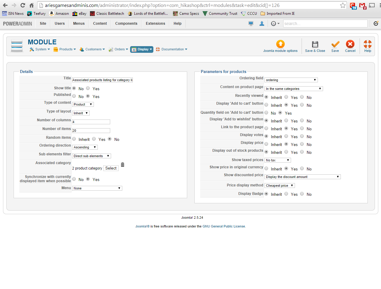

HikaShop content module :
www.hikashop.com/support/documentation/i...op-modules-form.html
But it can also be some CSS modification if you edited the HikaShop CSS file directly and not use the backend interface to create an override.
  • Posts: 713
  • Thank you received: 37
11 years 11 months ago #173188

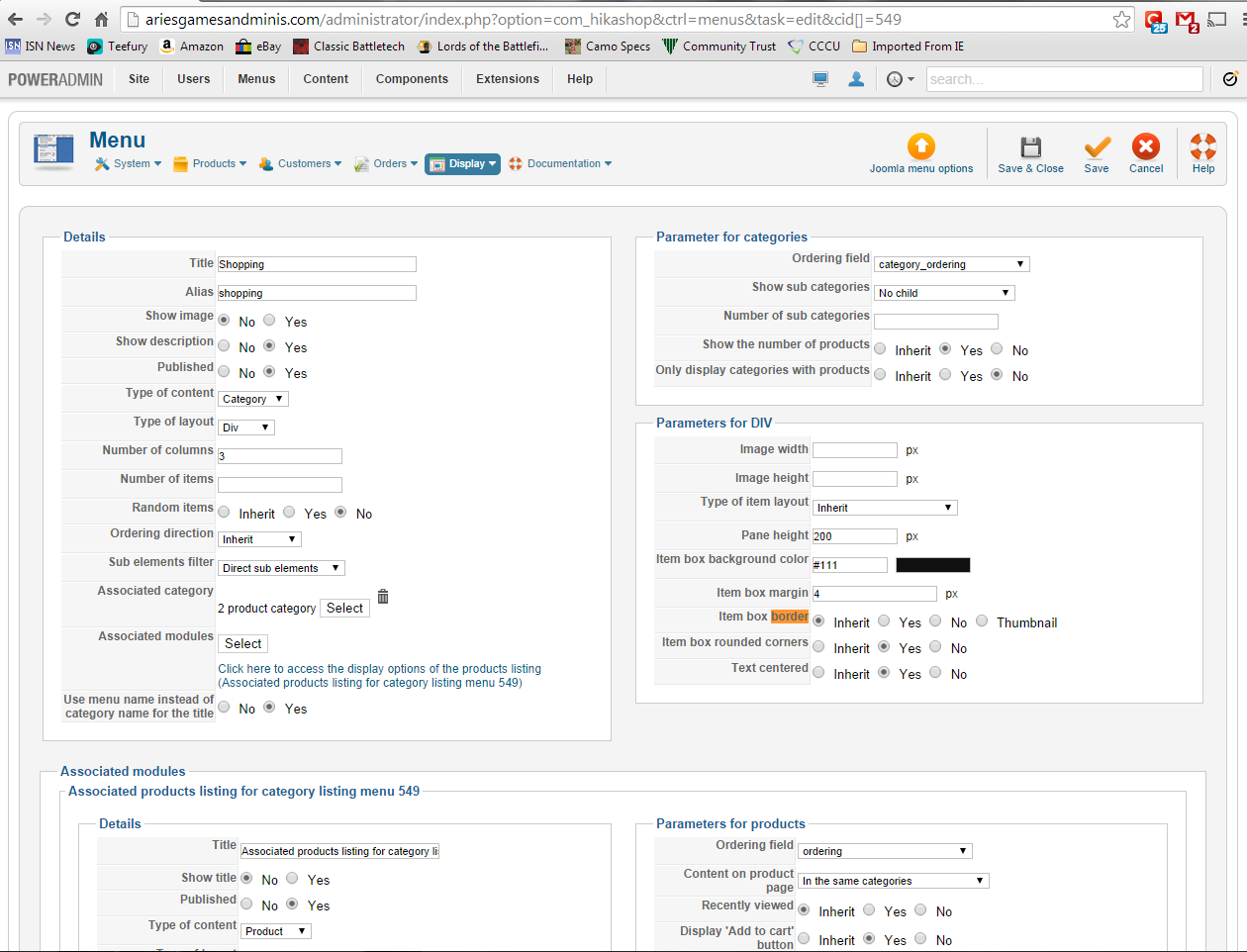

That's one of the first places I looked because I knew it "WAS" there previously...but as per the image attached, that feature is non-existant for products in my edition of HikaShop Essentials...unless I'm in the wrong screen.
The only other "border" selection I know of is the one in the 2nd image attached called "Category Borders"...and I've confirmed that this only changes the borders on my categories, not the products.
Last edit: 11 years 11 months ago by Dragon41673.
  • Posts: 26384
  • Thank you received: 4077
11 years 11 months ago #173190
Sure, the type of layout is "inherit" in your first screenshot, so it use the option in your default configuration.
I guess you change some elements in your HikaShop configuration for that.
But upgrade from starter to essential does not change that or does not change your configuration.

11 years 11 months ago #173297
In your case the solution will probably be to set the "Type of layout" option to "DIV" and then set the "Item box border" to Yes.
The following user(s) said Thank You: Dragon41673
  • Posts: 713
11 years 11 months ago #173377
Mohamed...
Thank you, thank you, THANK YOU! That worked. I had no idea that switching the "Type of layout" would open up another box which happens to be the one I remember seeing previously...but was gone when I upgraded to Essentials!
