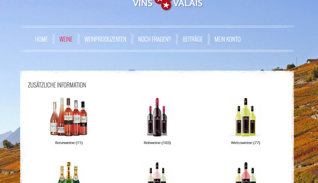

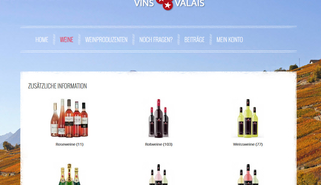

How can i disregard the msg "additional information" (Zusätzliche Informationen) from my category overview page? I have specified some extra fields and this information is also showing up properly when i open a certain category. But his information should not show up in the category overviews.
Thanks for your feedback.
Markus

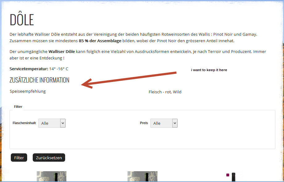

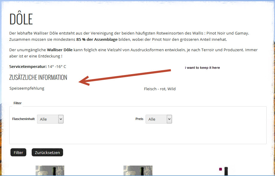

11 years 11 months ago #173862
But then it is not showing up on my category listing as per attachement.
Is there another solution?
Markus
