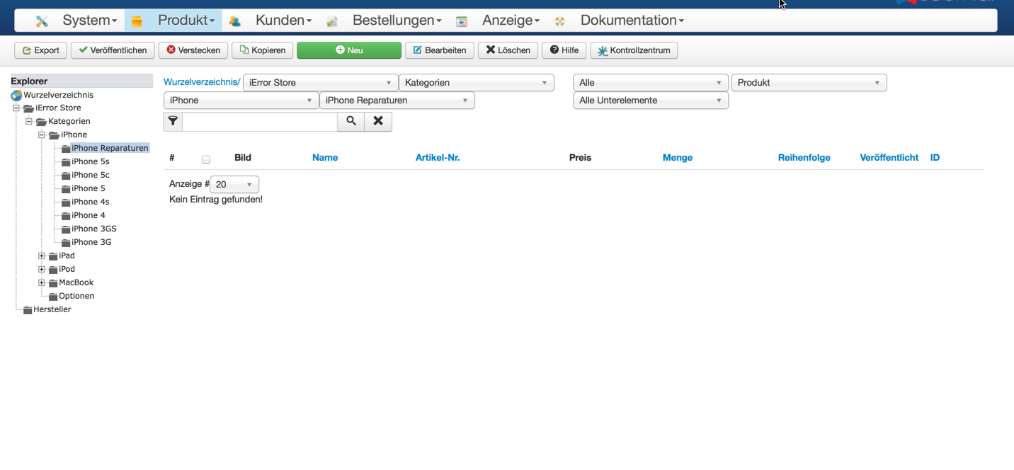

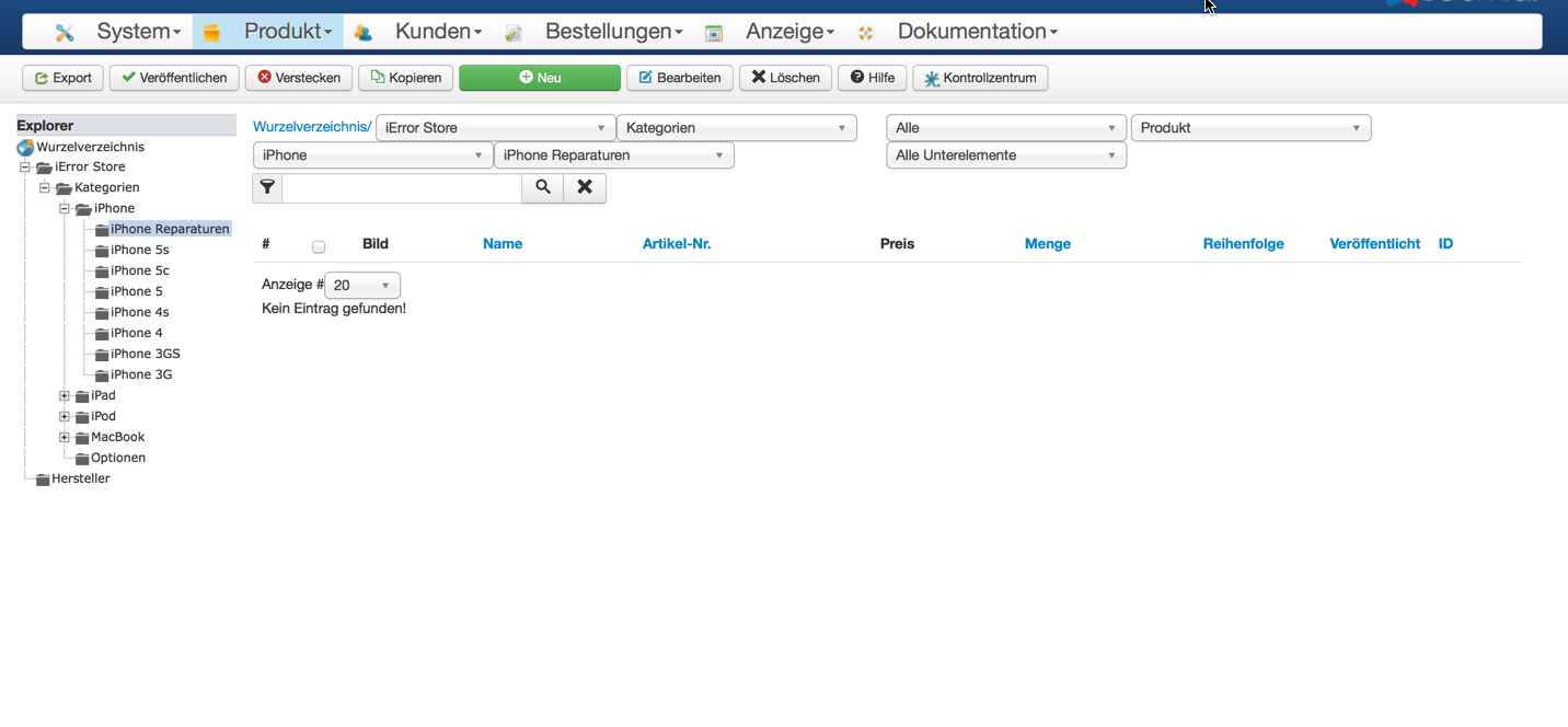

  • Posts: 20
11 years 10 months ago #175430
the products are away...
I don't know. Here are the picture.
I'v you want I can give you a backend account
regards,

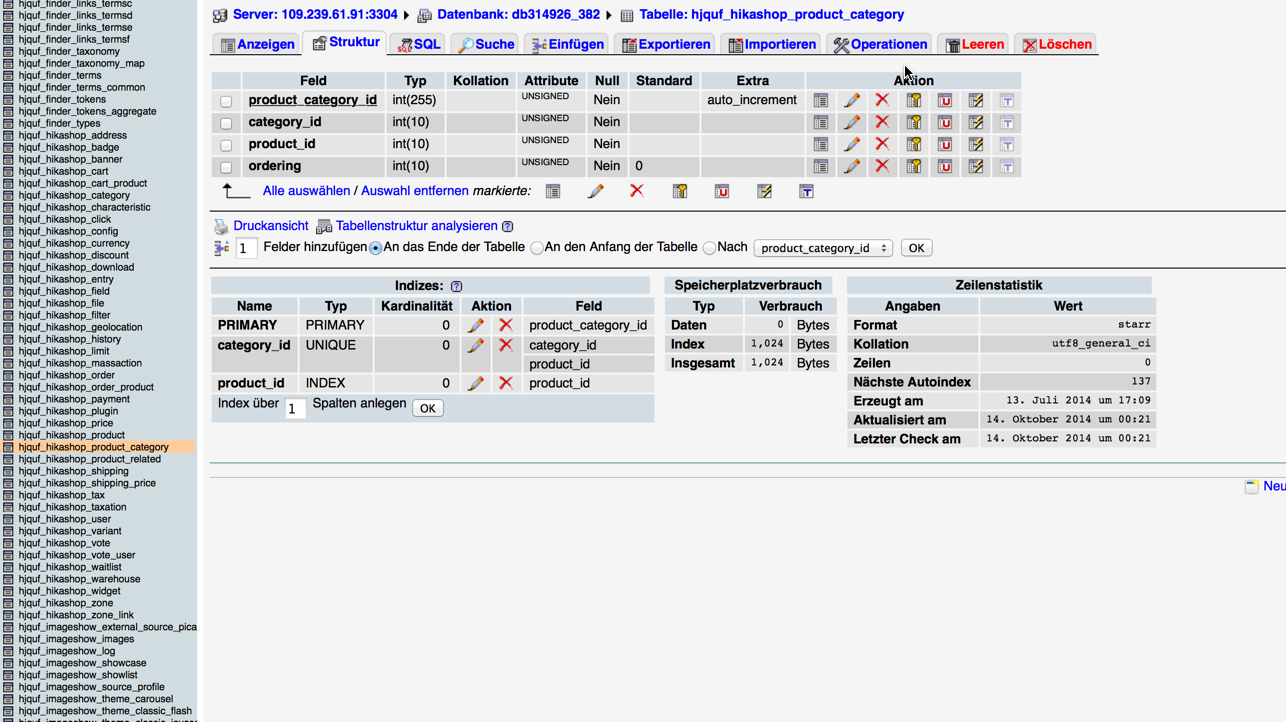

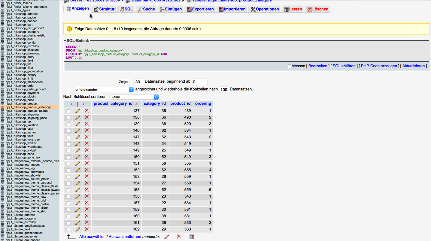

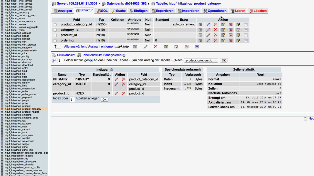

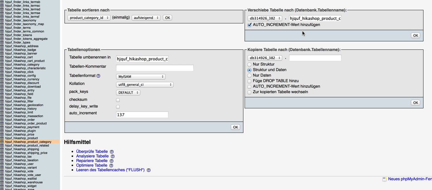

11 years 10 months ago #175459
Could you check via your phpMyAdmin interface if the entries are correct in the table "#__hikashop_product_category" ?

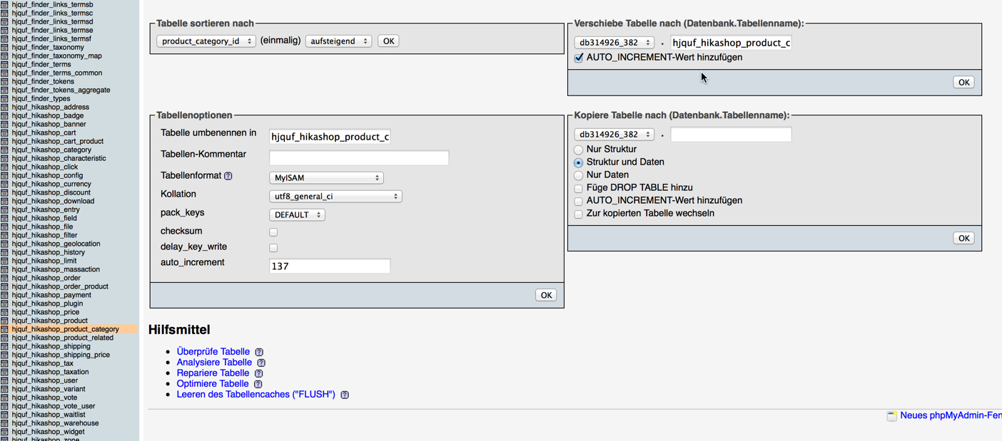

  • Posts: 20
11 years 10 months ago #175584
The file is there but I don't know if it is correct.
  • Posts: 26384
  • Thank you received: 4077

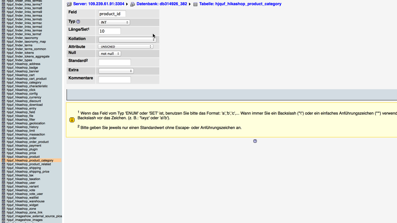

11 years 10 months ago #175607
The table is the right one. You need to display the content of the tab (the first tab, near "Struture").
You will see the links between the products and the categories, you can make a search (using the "search" tab) in order to only display the lines with the product_id that you want to check (the id of the missing products).
If there is no entries for that products, if the table does not have links between products and categories, we will have to recreate them !
But first, we have to know the content of the table.
  • Posts: 20
11 years 10 months ago #175727
hello
Thank you for your response.
Unfortunately I am not familiar with MySql. And I'm still a beginner. I'm sending you a few pictures.
perhaps you can help me so.
Thanks again.

  • Posts: 20
11 years 10 months ago #178574
hi Jerome
Thanks for the answer.
here is a picture from the tab "Anzeigen":
A button for this would be perfect. :-)
Last edit: 11 years 10 months ago by sommi.

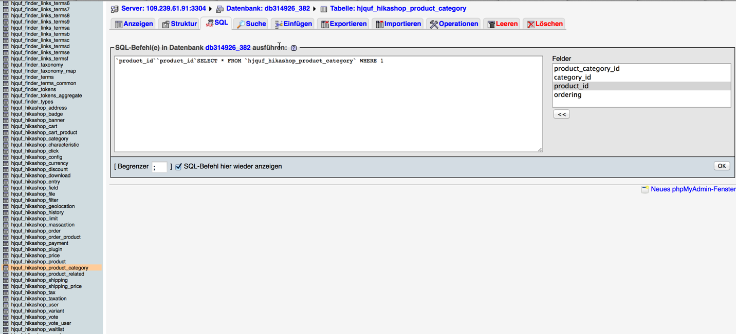

  • Posts: 26384
11 years 10 months ago #178606
Okay, it looks like you have very few product category links ; the table is not empty but we can make better tests.
Can you please click on the tab "SQL" and paste that query
SELECT p.* FROM `hjquf_hikashop_product` AS p
LEFT JOIN `hjquf_hikashop_product_category` AS pc
ON p.product_id = pc.product_id
WHERE p.product_type = 'main' AND pc.category_id IS NULL;
If the query return you some elements, these element will be the "lost" products.
So you will be able to use that query
INSERT INTO `hjquf_hikashop_product_category` (category_id, product_id, ordering)
SELECT 2, p.product_id, 1 FROM `hjquf_hikashop_product` AS p
and it will put every "lost" products into the category "product category" (which have by default the id "2").
It's not a real button but the effect will be quite the same :)
The following user(s) said Thank You: sommi
