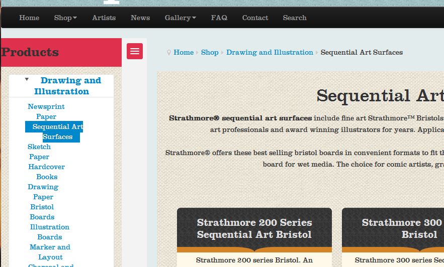

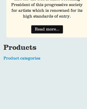

I am having difficulty achieving something that should be very simple. I want to have a sidebar with product category listings as in the screenshot attached.
I know in Hikashop I can create a menu item that is a category listing, and if I select that to display as a list I get something like what I want,

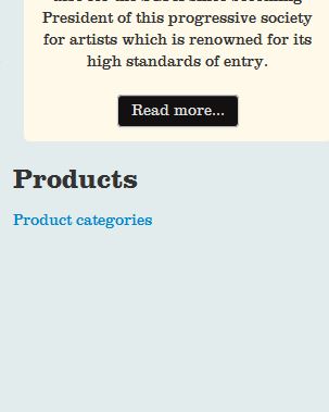

but I can't see how to make that appear in a Joomla sidebar module position. I have tried creating a Joomla module and making that of type menu, and then selecting the menu I have created with the Hikashop category listing but there doesn't seem to be a way to show all the subcategories
and if I click on "product categories" it just takes me to a new page as capture 2.
Thank you for your help,
Ian

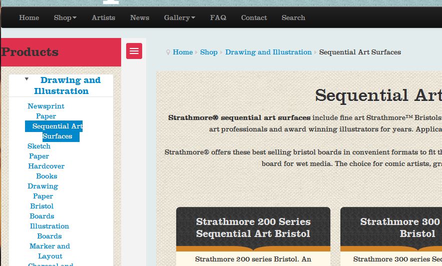

The fundamental difficulty I have is the architecture of Hikashop that attaches the display characteristics to the link to a product, rather than the product. This has some advantages (you can display the same product in lots of different ways) but also disadvantages in that you have to configure product display for every route to that product.

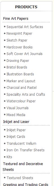

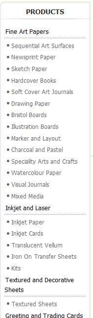

I am using hikashop to replace this site: Artist Papers , which I built a several years ago using Virtuemart.
You'll see I have a "Shop" menu item on the main menu bar, this I had to manually construct but it is just links to the appropriate product category pages. The "Shop" item itself is a link to the Virtuemart component and the rest are URL's to the product pages. The display characteristics for the product pages are determined by templates configured at product category level which cascade down, so if you define a template for a category it applies to sub categories as well, unless over ridden.
I also have the Virtuemart module mod_product_categories in the left column, this has very few parameters to configure and a bit of css tweaking but again just links to the product pages.
The screen shot shows where I am up to with Hikashop.

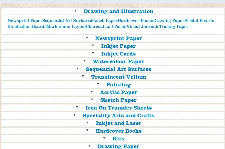

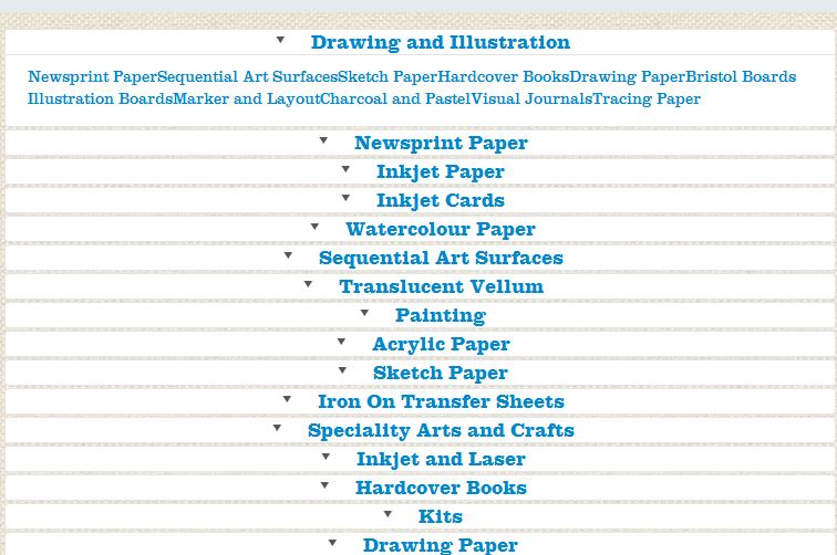

I have the same menu bar which is manually created but this time each menu item is a Hikashop module which has the potential to be misconfigured. If I put a category listing item on the menu as "shop" clicking on it directs me to a new page with the categories which is not what I want. It would be nice if there was a display option "category listing as a drop down" to make this a simple one step option.
Also I have a pull out sidebar which is a hikashop content module, (I haven't done any styling on this yet). I can't describe how I have configured this exactly because I can't remember, and this is the problem as it's so convoluted, but I have a configuration page for the module and then there is an associated menu item page to configure and no obvious connection between the two.
It works, eventually!
Hope this helps,
Ian

Thanks for your explanation !
I started a re-factoring of the view "category / listing_list" in order to have list without the Joomla pane system.
It was something used 3 years ago but it's not enough for today.
So my first idea is to add a new setting to use or not "panels" (a Joomla panel is some kind of accordion).
I can't give you a schedule for that (Nicolas is currently traveling due to Joomla conferences so I'm in charge of the support during that time ; I already try to find some time for the development of my components :) ) but it is something I want to submit for the next HikaShop release, for sure !

What you propose would be useful to me as I would like to show the category list fully expanded as in my original site.
