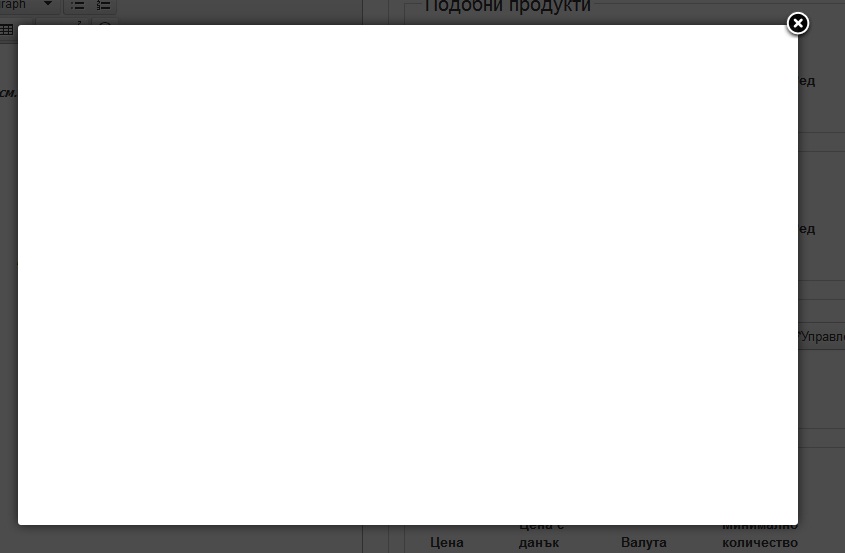

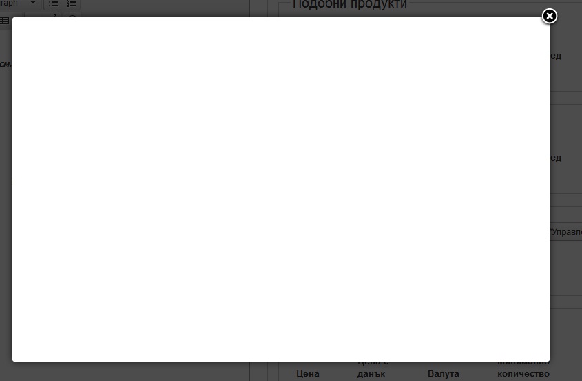

A while ago I wrote about problem with back-end price for all products. Now i'm havinig problem with access levels for them. When i try to set it a white screen open, but with no options.
Any idea? Maybe some code is missig?

If you can explain me why the HikaShop core files as been modified and why the files:
"administrator/components/com_hikashop/views/product/tmpl/price.php"
"administrator/components/com_hikashop/views/product/tmpl/priceaccess.php"
Are just empty files ; I will be happy to understand.
Please do not modify HikaShop core files ; please be sure that when you update HikaShop, you have right access to all files and that the installation is processed correctly.
I can't know if other HikaShop core files are empty ; but for the moment your backend product edition is working just with the overrides, which is not normal.
