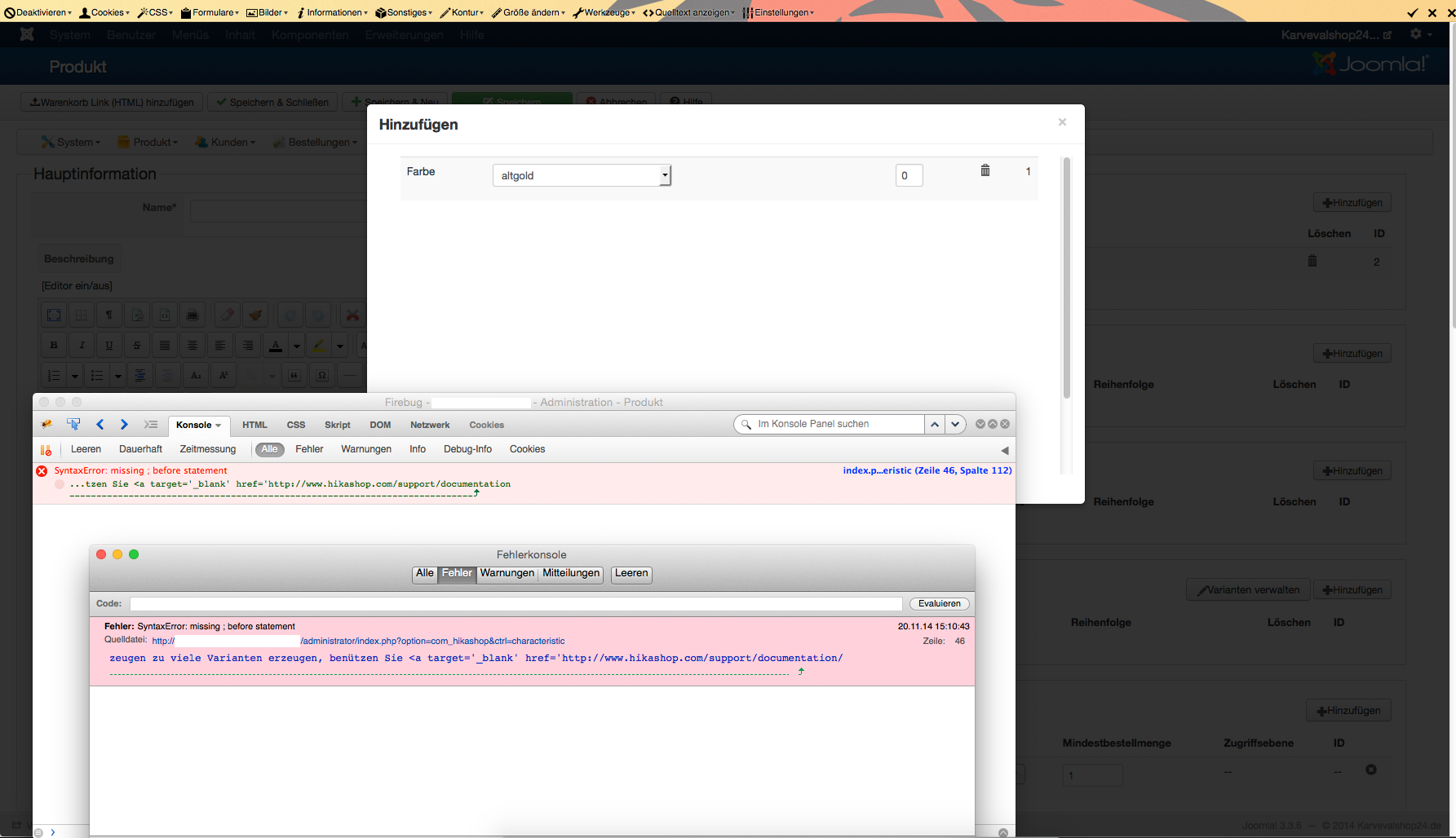

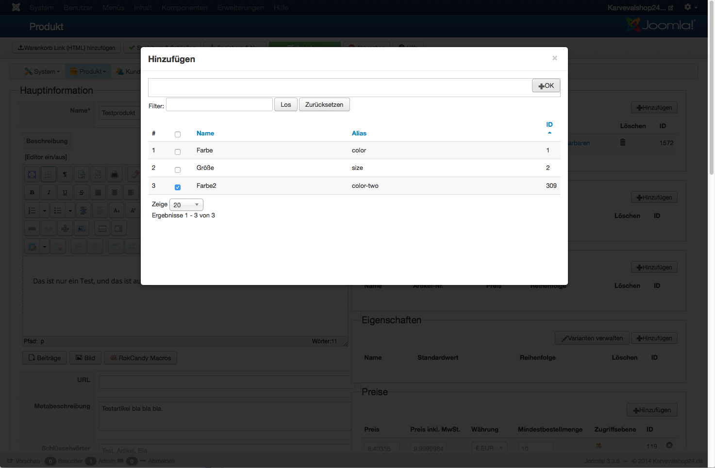

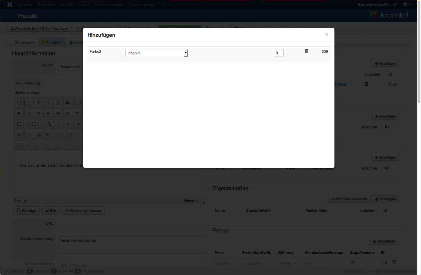

Hi.
I have a Characteristic "color" with 305 values. There is no problem about handling, and automatic variant generation is disabled. We will handle the variants mostly with the import functionality.
Now about the problem. When I try to add that characteristic to a test product I get the screen that you can see on the attached images.
The characteristic is not added to the product. If I remove some of the values (about 50 - 100) it works normaly. I'm about to finish that project (finaly), and I need this working to do the import of the products.

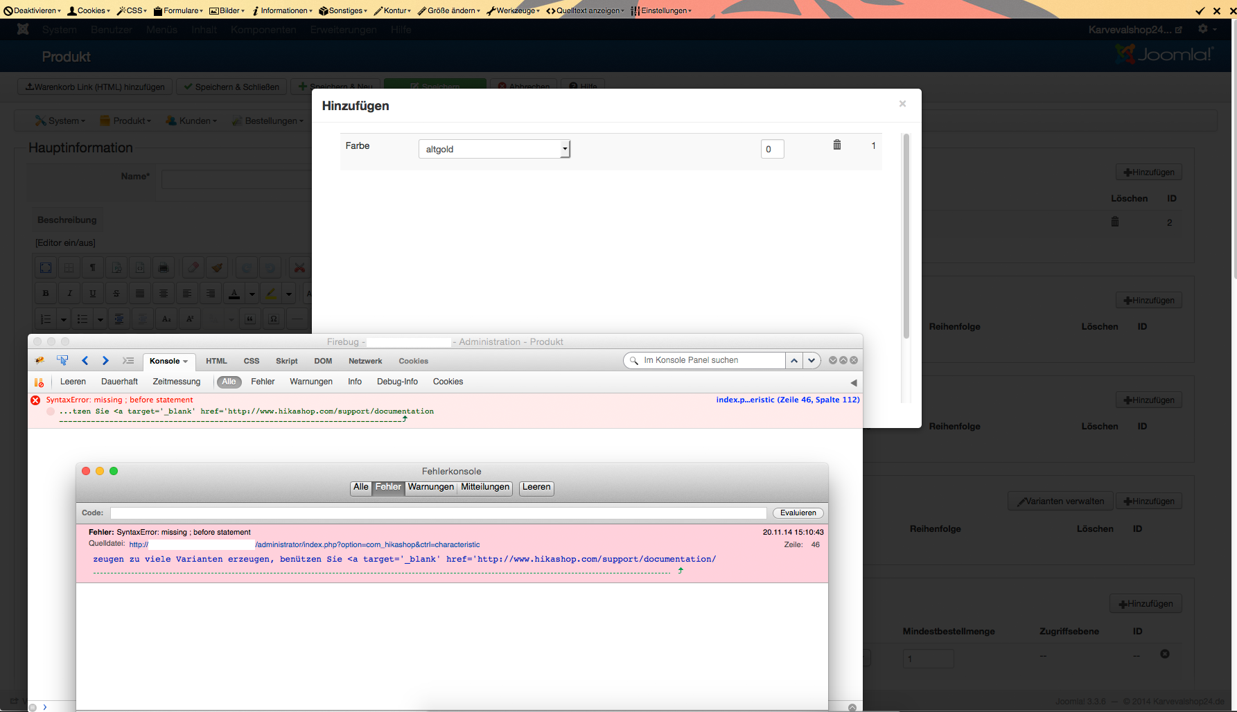

  • Posts: 18
11 years 9 months ago #180532
Hi Jerome,
I was a bit busy...
I've attached you a Screenshot of the error message. It says something like "generate to many variants" in bad german :).
This is not an urgent problem for me as the CSV import works flawlessly. My customer just can not add a product with the "color" characteristic manually.

  • Posts: 86114
  • Thank you received: 14210
11 years 9 months ago #180568
It seems that the issue comes from the translation of the error (which appears only above a certain amount of values in the characteristic) which has been modified on your website, and then breaking the javascript of the characteristic.
Replace the code:
alertMessage.innerHTML = '".JText::sprintf('TOO_MANY_VARIANTS',$optionsLink,$customLink)."';
to:
alertMessage.innerHTML = '".str_replace("'","\'",str_replace("\'","'",JText::sprintf('TOO_MANY_VARIANTS',$optionsLink,$customLink)))."';
in the file administrator/components/com_hikashop/views/characteristic/view.html.php and that should fix the error even without fixing the translation file.
