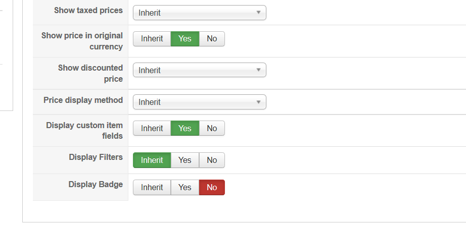

  • Posts: 59
11 years 5 months ago #192845
I have gone through all the settings and they are all on...
I think your second suggestion could be the key.... How can this be checked... I am happy to give you access if you need it
  • Posts: 86058
  • Thank you received: 14182
11 years 5 months ago #192864
If you believe that you've activated the display custom item fields option of all your products listings menus/modules and that it didn't help, then rename temporarily the folder templates/YOUR_TEMPLATE/html/com_hikashop/product to something else via FTP. That will deactivate all the view overrides for the display of the products on the frontend and the system will then use the original view files of HikaShop. If that fixes the problem, then repeat the procedure with each file in that folder in order to find the file override causing that problem. Then, save your modifications for that file and reapply them to the new version of the view file via the menu Display>Views.
