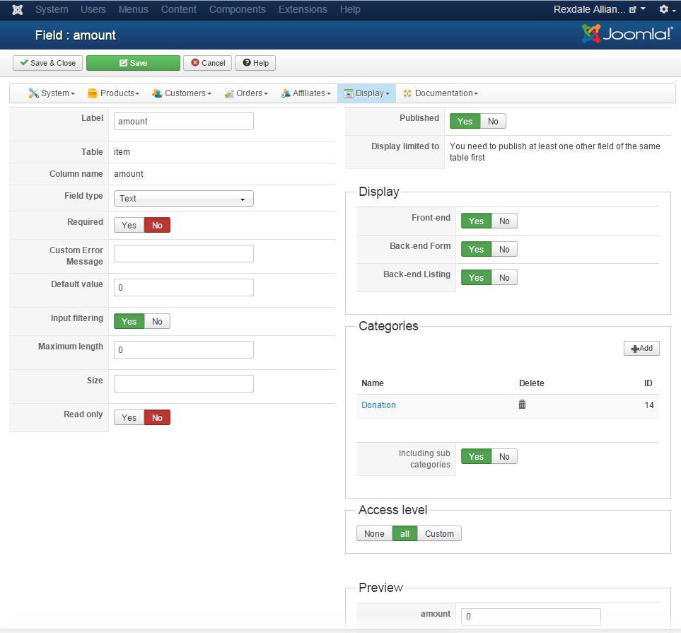

Okay, I've now got the custom "amount" field showing but when I go through to the checkout, the amount of the donation is not passing through to the cart. I've got the site set up like your demo, i.e. custom field is labeled "amount" and the donation item is labeled "donation".
  • Posts: 86112
  • Thank you received: 14210

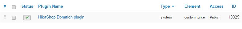

11 years 9 months ago #182601
Did you enable the HikaShop donation plugin via the Joomla plugins manager ?
  • Posts: 30
11 years 9 months ago #182644
Yes, the plugin is enabled. How does the plugin work? Is it looking for a specific field name, ie "amount" to replace the price? I have ensured that the custom field label/name/alias is set to "amount".

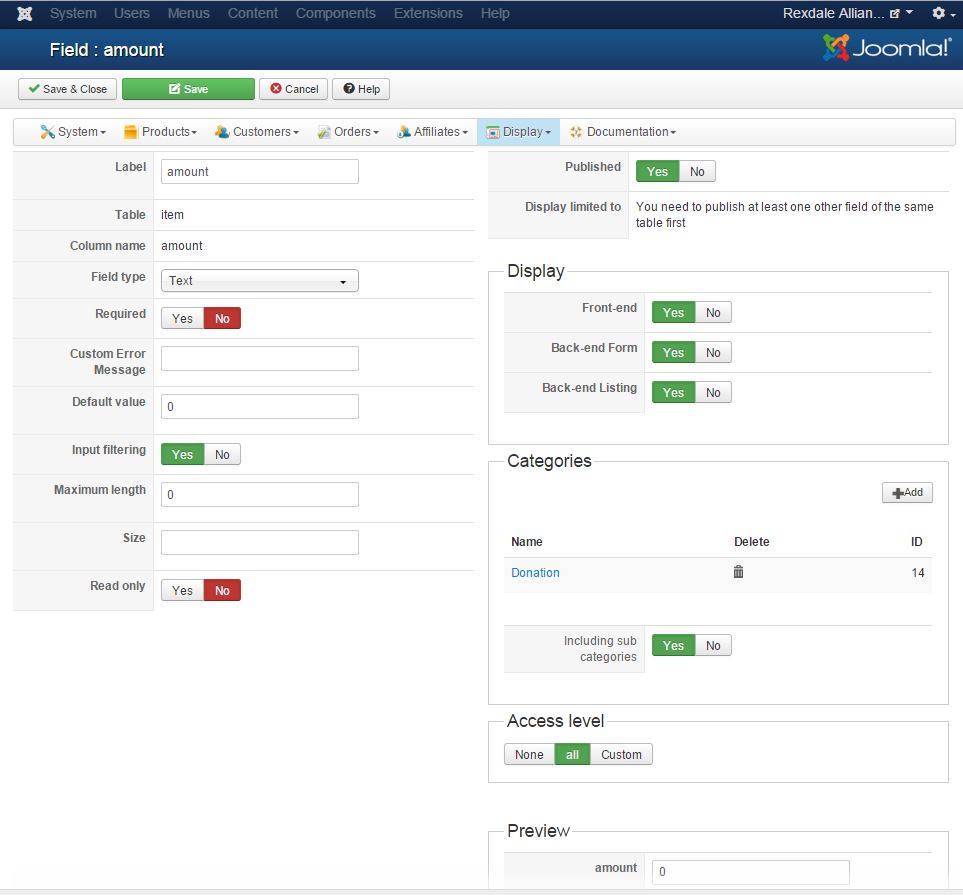

  • Posts: 86112
11 years 9 months ago #182706
I see that the value of the amount is not added to the cart on your website when you add the product to it. So the problem here is not the plugin but the fact that there is something preventing HikaShop from handling the custom field.
How did you configure the custom field ? Could you do a screenshot of its options ?
Can you click on the "check database" button of the HikaShop configuration in order to make sure that the database is OK ?

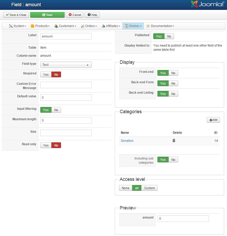

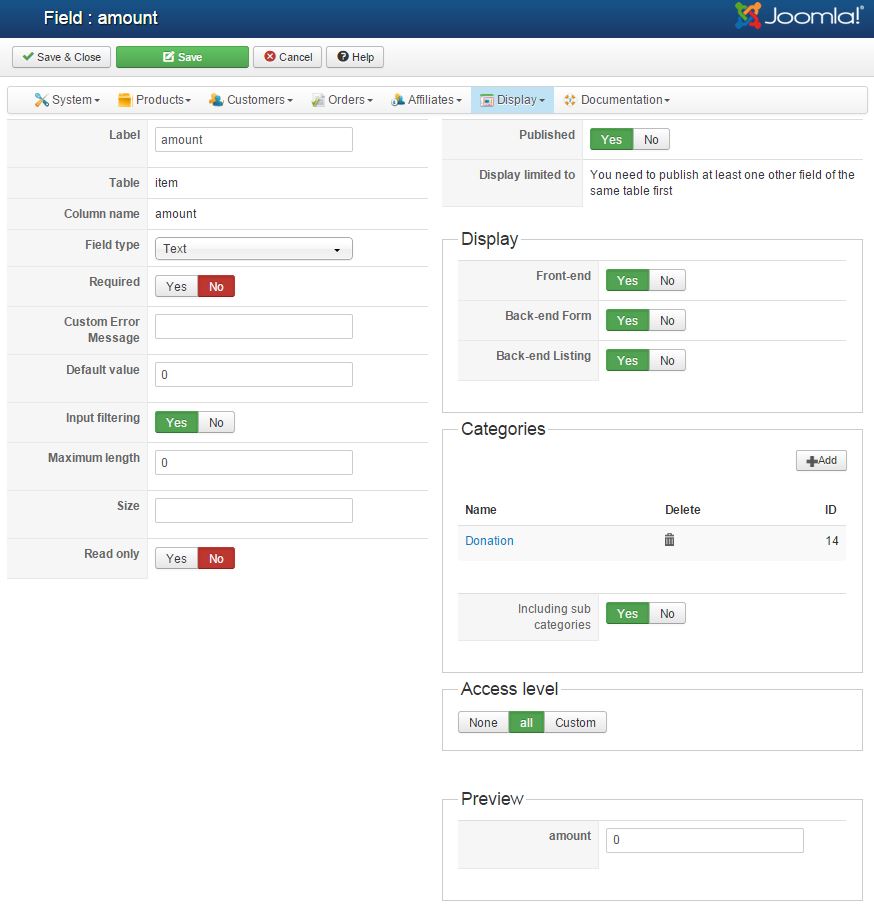

  • Posts: 30
11 years 9 months ago #182771
The screenshot is attached above (towards the top of this thread) but I've included a current version here in case I made any changes since posting the last screenshot.
BTW - I did the "check database" and everything came back "OK"
