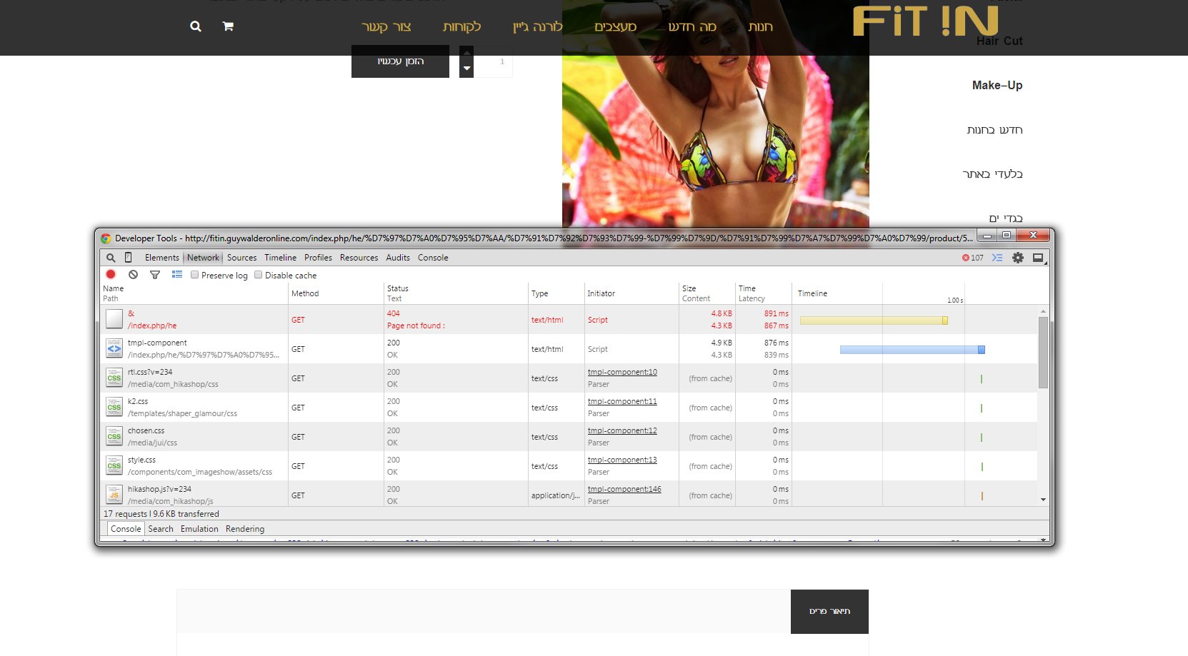

I'm not sure how it is you didn't encounter the issue. The problem is a get method that returns a blank link on some of the pages (see attached image).
I thought it had something to do with the Hebrew aliases but I've never encountered any issues with Hikashop a UTF-8.
Tried to move the item to another category with only English url but got the same result:
Original (Hebrew) - fitin.guywalderonline.com/index.php/he/%...roduct/53-aqua-tucan
New (English) - fitin.guywalderonline.com/index.php/en/s...roduct/53-aqua-tucan
I think I'll have to wait for the template developers for this one...
