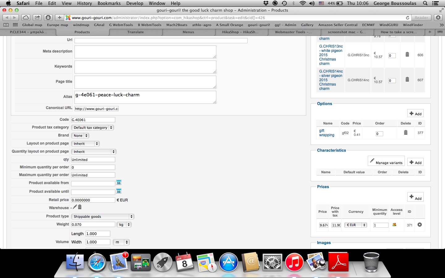

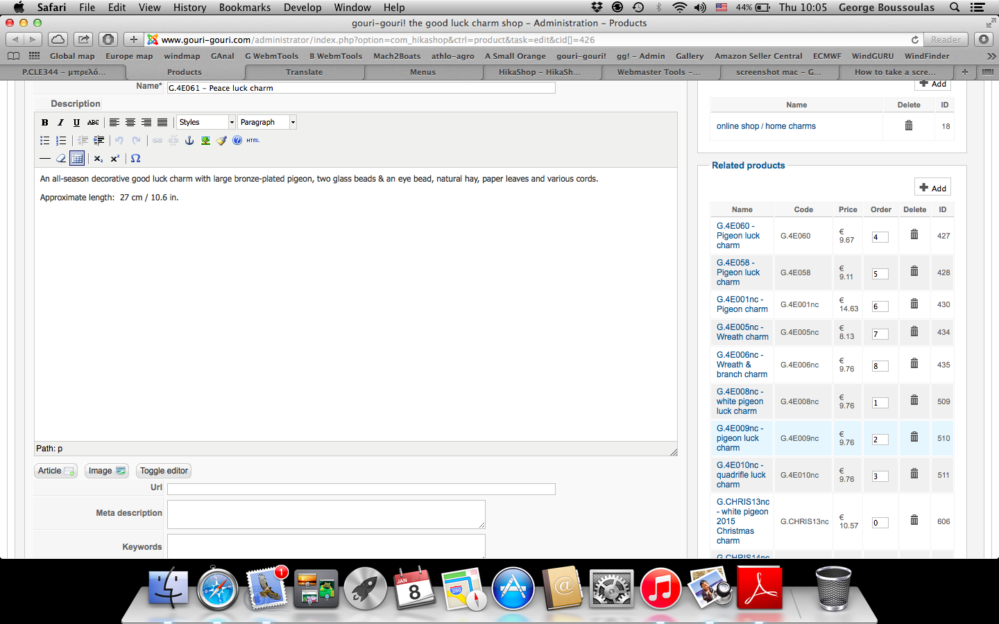

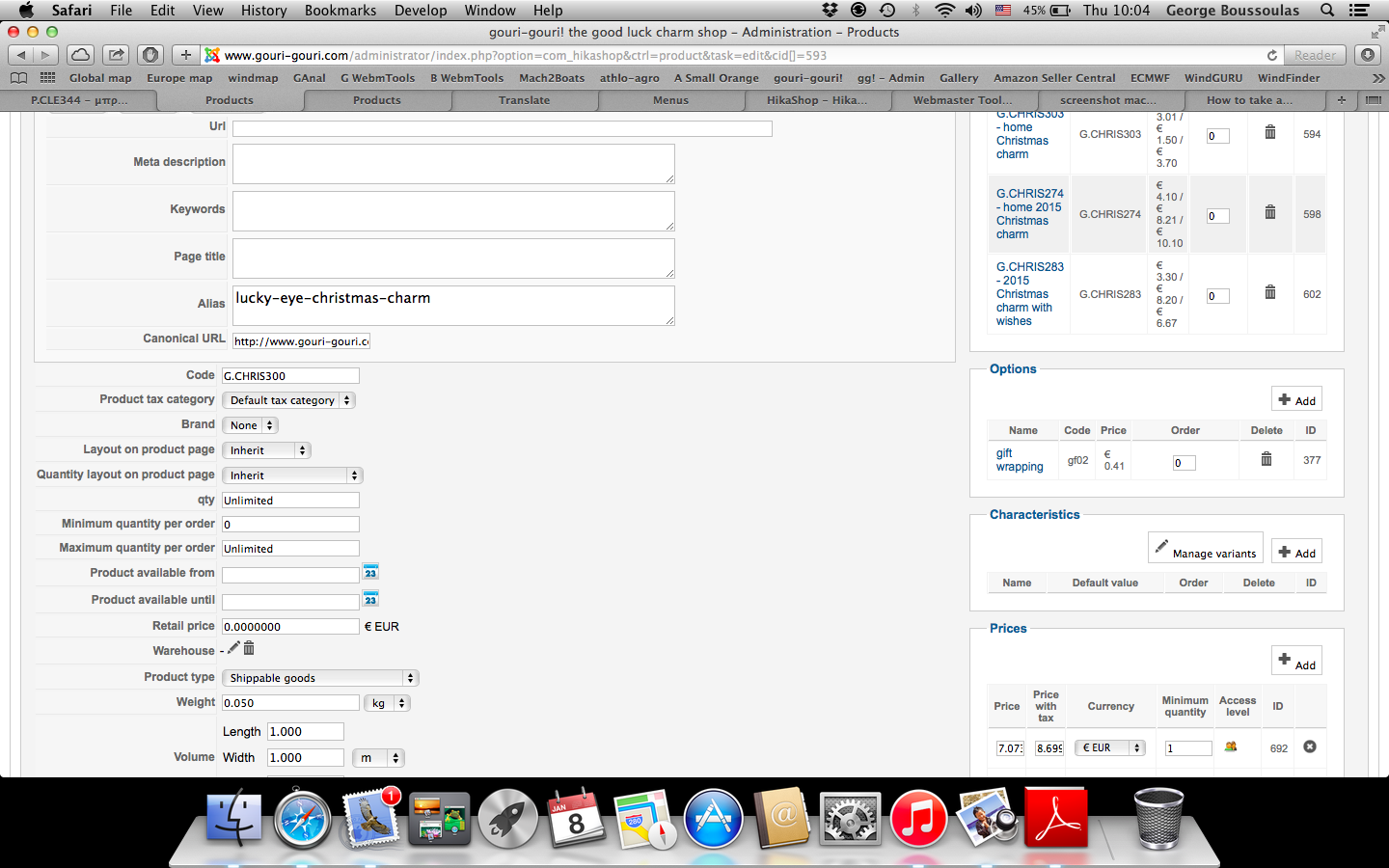

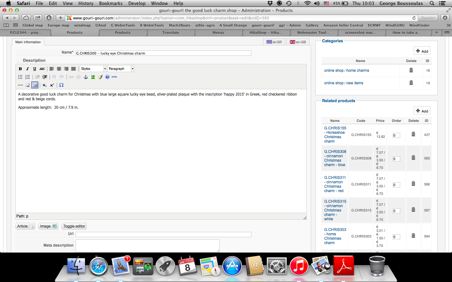

11 years 8 months ago #185578

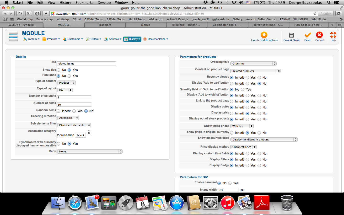

Please give us a screenshot of the products with id 593 and 426 settings.
For the related issue, please check the settings of the module with the id 89, it's maybe not properly configured.
  • Posts: 64
11 years 8 months ago #185695
Here they are:
