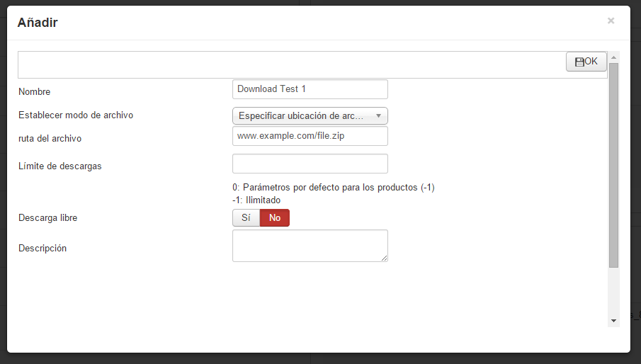

  • Posts: 32
11 years 5 months ago #186294
I activated Debug mode and set error log to maximum. I didn't get any error. I attached a screenshots of the problem.
Help me please :(

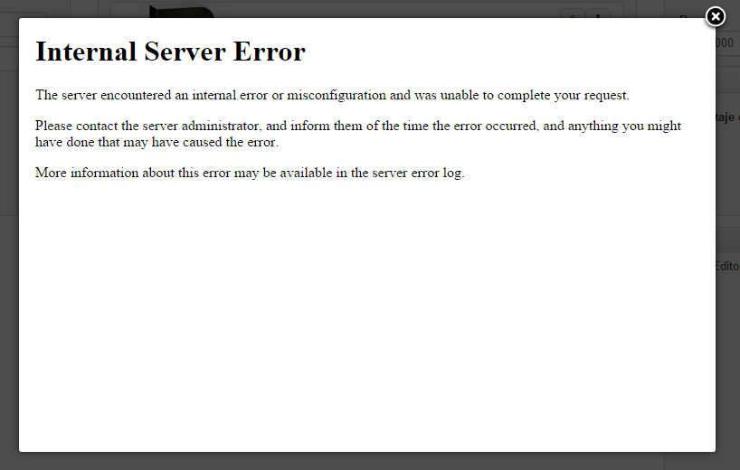

  • Posts: 32
10 years 10 months ago #211862
Hello, I've updated to HikaShop Business: 2.5.0.
I have the same problem. Sometimes it gives simply a blank popup and other times I get Internal Server Error. I tried to to update the section in product.php as you described but then all the administration area get an Internal Server Error. So I guess it used to work with the Hikashop version made for that moment and now is different version.
Help me please :(

  • Posts: 32
10 years 10 months ago #211986
I have tried to find ways to try to fix it all day long and I don't know what to do. Now I send you a refresh of the error log at the moment:
20150819T140249: www.nitesoftware.net/index.php
PHP Notice:  Undefined property: ProductViewProduct::$canonical in /hermes/bosweb25b/b805/ipg.tropicanoffcom/nite2015/components/com_hikashop/views/product/tmpl/show.php on line 12
20150819T175042: www.nitesoftware.net/index.php
PHP Warning:  sprintf(): Too few arguments in /hermes/bosweb25b/b805/ipg.tropicanoffcom/nite2015/libraries/joomla/language/text.php on line 280
I attached a screenshot of the error.
  • Posts: 32
10 years 10 months ago #211994
I noticed that the problem is only when trying to add a file with external URL.
When I try to upload a image for the product cover, it works fine. And if the product had a previous file added I can modify it but the problem is when trying to create a new file.
