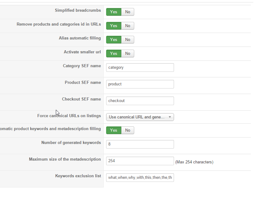

BTW, attached is the settings currently in the SEF Config. What did you need me to change to remove "product"?

Regarding the SEF configuration, you specify that you want to use (and force) the canonical url in the listing.
So it could be useful to compare the configuration of the two menus and of the two categories.

In the URL www.iheartsin.com/accessories/category/legs the part "accessories" is the alias of the current menu item.
If you remove it from the URL, Joomla SEF system will think that "category" is the alias of the current menu item and will try to look for a menu item with the alias "category" so that it can give it the hand to process the page. As it won't find any, it will display a 404 error.
So that's the normal behavior here. Changing the HikaShop configuration won't help.
Canonical URLs are there to avoid duplicate issues with SEO, they are not there to allow you to put whatever URL you want for each URL. You can put in the "Canonical URL" field of a product/category" any valid link to the product/category so that the system uses it. If you put an invalid link (one that Joomla SEF doesn't understand) it won't work and you'll get 404 errors.
