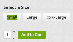

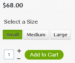

I'm really sorry to bother you but I have been spending hours trying to get this to work and have tried many variations but still stumped.
On an earlier version of HikaShop I was able to get the characteristics option label to have an active/selected colour using this:
#hikashop_product_characteristics_options input[type=radio]:checked + label {
	background-image: none; outline: 0; box-shadow: inset 0 2px 4px rgba(0,0,0,0.15),0 1px 2px rgba(0,0,0,0.05); background-color:#6FA907; }
But no matter what I try now I just can't get it to work and was wondering if you can give me a hand. Here are some of the options that I tried:
#hikashop_product_characteristics div.controls input[type=radio]:checked + label, #hikashop_product_characteristics div.controls:checked + label,
#hikashop_product_characteristics div.controls label input[type=radio]:checked, #hikashop_product_characteristics inputbox:checked + .radio {
	background-image:none; outline:0; background-color:#6FA907;  }
Please see attached pic of what I am referring to. Thanks in advance!

11 years 6 months ago #193206
Sorry I did not understand the instructions originally...
Thanks for the solution but this is causing more work - I assume there isn't an easier way? And, why did the set-up change in this version of Hikashop?
Now that I did what you suggested the background is not covering the entire button and I have tried several options :(
